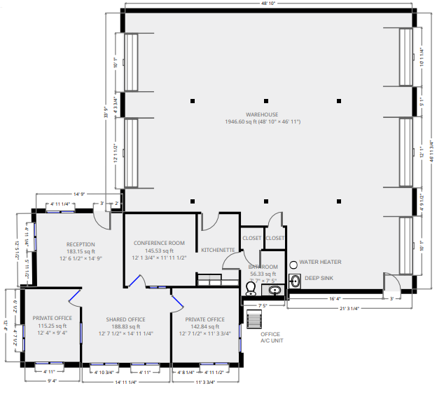

Here is the schematics of my new building. I'm wanting a Centrumforce wash tub, centrifuge, Tumbler/Polisher, and maybe a Hanta Systems Rug washing machine. Is a wash pit still necessary with a tub? Obviously this will not happen overnight, but I would like to have a plan. The 6 squares in the middle are support beams because of the 12ft drive-thru roll up doors.
Outline of entire building including offices.
Area of just the shop.

Naturally, I would be glad to assist you. Let me suggest that you first determine where the sanitary drain is located. I do not recommend a pit, but rather floor trench drains. Skip the curbs, they get in the way. Floor washing inside of perimeter trench drains can be done effectively with flooding, shampooing and power washing. The wash tub saves time and floor space for production labor saving prewashing of rugs. Call me anytime to discuss short term and long-term plans. Let your volume of rugs determine what equipment you buy at various phases of development along the years.

Cleanout is on the south side of the schematic near the red #13, near the man-door. I'm mulling over how to connect to it. I like the floor trench drains.

Build your wash floor like Tom suggested.
Save room for flat, top down drying and tacking,
a drying room,
a dusting area (can you use air to dust outside in that area? Are their neighbors who will complain?
get a strap whacker Wolverine thing too
a good squeegee and a super high flow hose schnozel
and start with that.
Not too sure, that may be a challenge. On the edge of large subdivision. Easy to find off the freeway though. two streets down from I5 exit and close to hwy 273.
I think a tumbler may be the best option.
