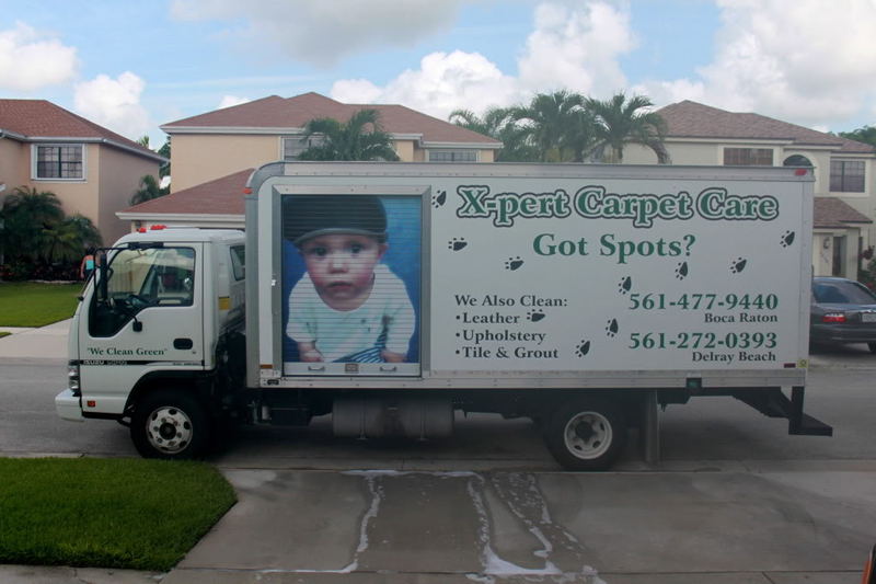

When I designed my box the first consideration was air flow. I placed 2 4' door directly across from each other. They are pull up doors so that I don't have to worry about clearance. Their are arguments for both types of doors but I don't need the extra storage on a door and I prefer roll-ups.
The sketchup program works great for designing absolutly anything. I use it all the time.
I think I paid $1500.00 to have side doors put in at Brown Cargo, dual doors, but you contact Russ Briney he is a sales rep there.
They can install anything you would want, roll up, single, dual, you name it.
We just had them put a flip up door on a used box truck last month because we had the door. I don't recommend flip up's
His number is 842-6506 Ext #121
