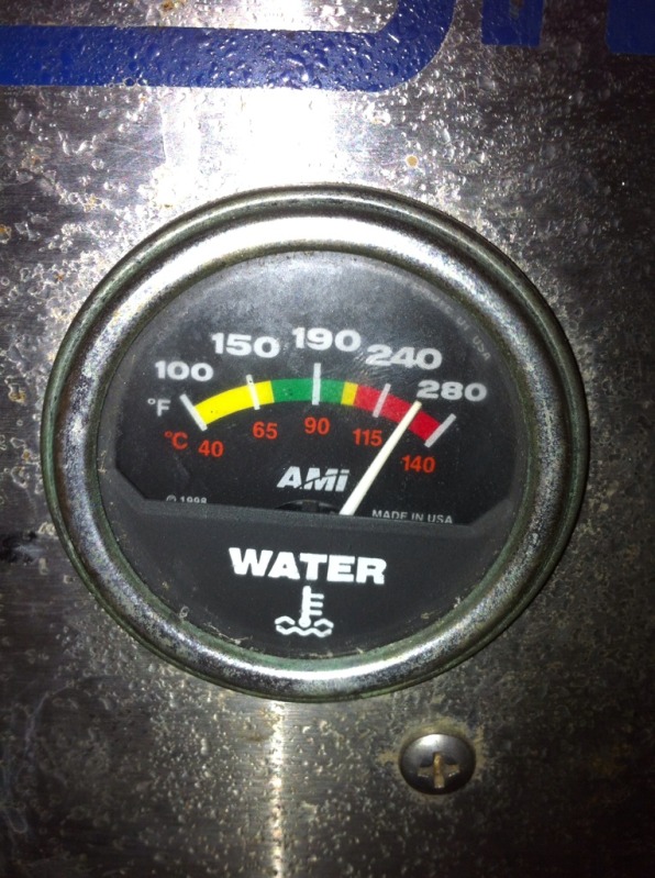

Hey Bawb what ya think?

Bawb you ever do this with a SG without the use of propane?
(The heat exchanger did bust after 6 hours)

i DID have one old Ford van that got pretty hot all the time.......i was ALWAYS getting burns from the qds.......it depends on where you plumb TO the HX.........if you plumb right behind the stat you can get a lot hotter heat......but it sure looks like you got it goin' on............
i wonder if i should build another one.........???
