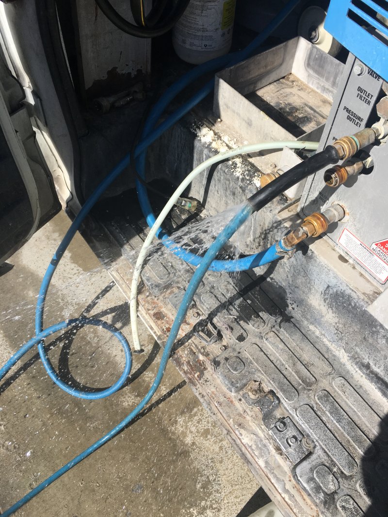

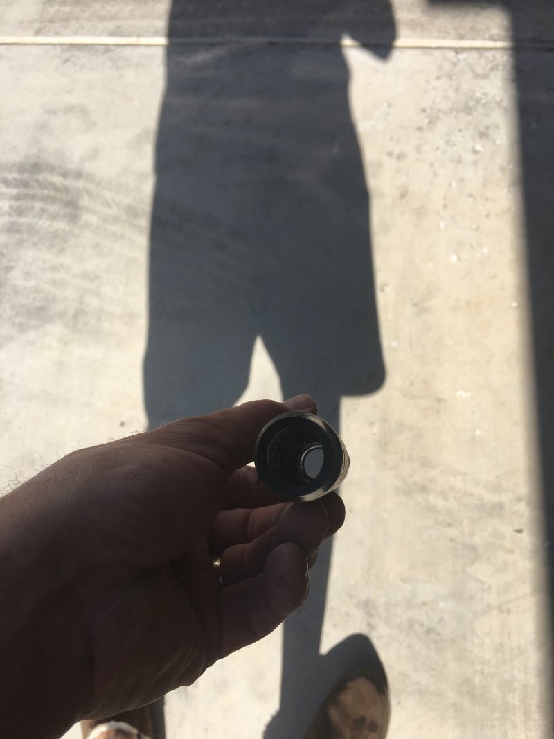

I'm gonna have to check the machine but the bimba may have gotten stuck and my son said the it read about 280 ATM
It popped right behind him soaked his pants.
Other then that I do t know.
Lucky it wasn't worse.

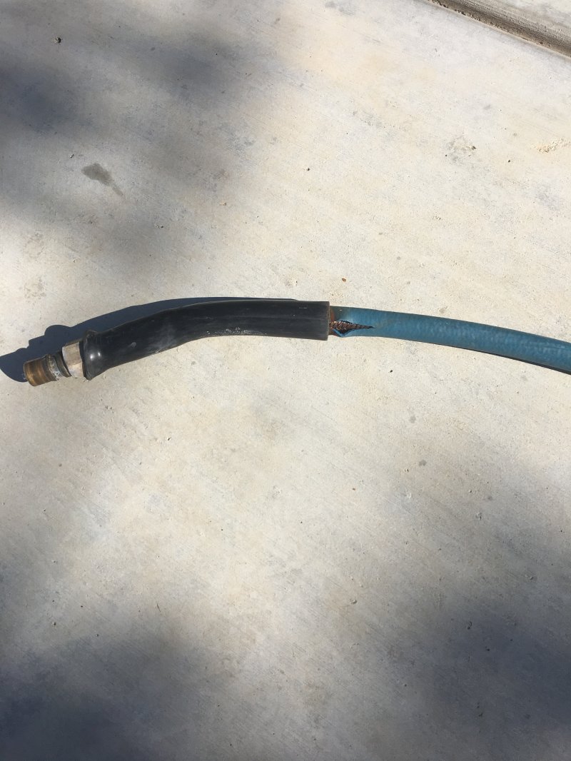

It's not the Home Depot valve it's a Joe valve
If I were you, I'd be calling Joe with some choice words just like he does all of his other customers that don't play by his rules. Your rules are: the hose shouldn't bust

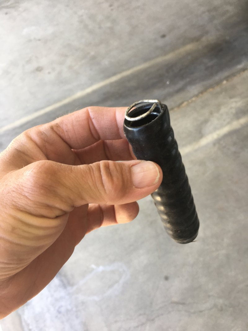

Did it pop at the crimp?
Parker usually does the little prick holes warning before it ever blows out.
Personally never seen it happen at the machine. It usually happens at the connection end from bending so much.

Oops nevermind it's the Goodyear that came with my 570 and bimba is stuck on heat.
Three sections of hose I barely used oh well.
Still about 2.5 years old need to go.

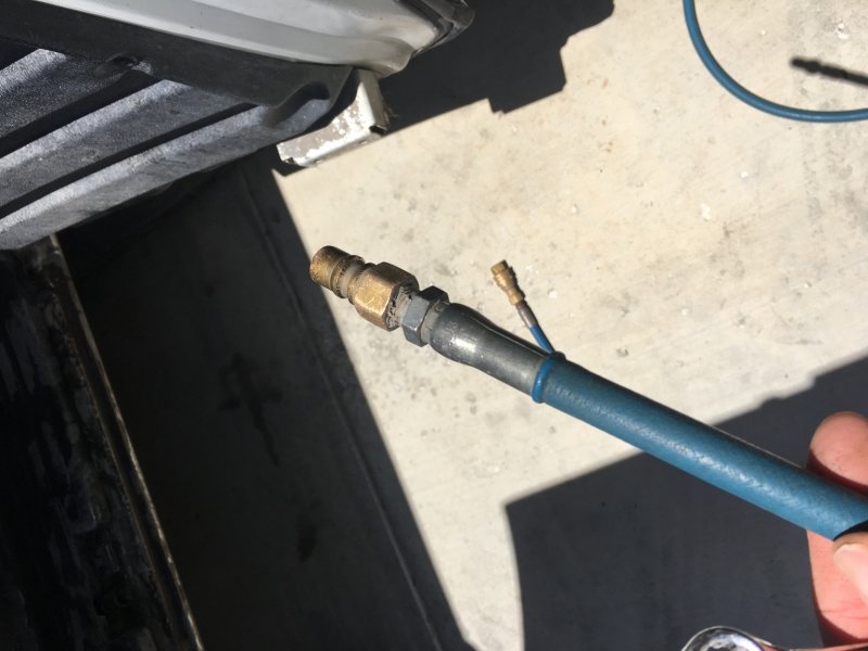

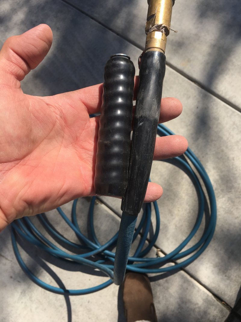

I get these from the unnamed and they do better then your typical bent restrictor.

Like I said it's been used about 10-12 times as a back up for longer runs the Parker is 2-3 years gets used 4-5 times a day 5-6 days a week.
I always replaced my Goodyear every year.

I love the high heat for when its needed but it sure is tough on valves, hoses and other heat sensitive parts.
I prefer to see what is going on beneath the restrictor. I wonder if the restrictor holds heat in or if its strictly a bend/wear issue.

Maybe @GeneMiller is on to something with his 5'-10' clear hose over the Goodyear hose end.. Just put it on both ends...

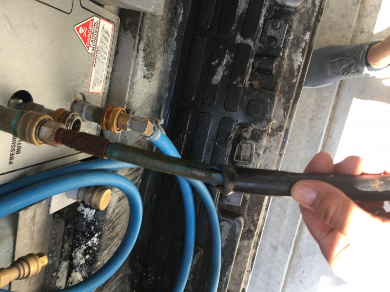

What I'm noticing if the rubber protection sleeve getting pushed up a little.
Phil is notoriously trying to
Use brute strength instead of brains.
I have to replace the ends on the courtesy hose 2-3 times a year because he forces it on while the machine is pressurized.
I never have to replace mine because I depressurize the lines before I put them on.
