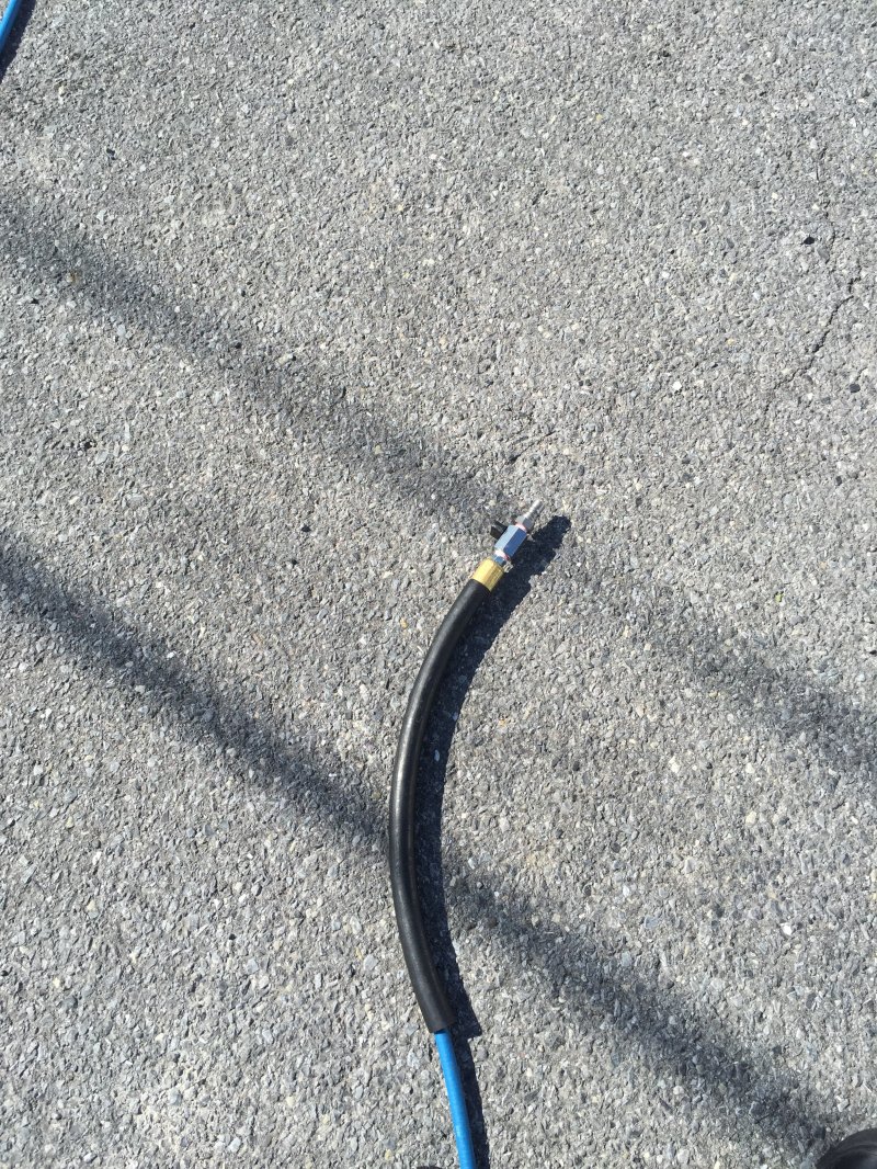

View attachment 72524 View attachment 72525

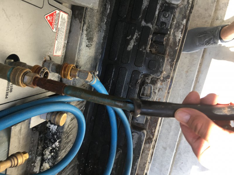

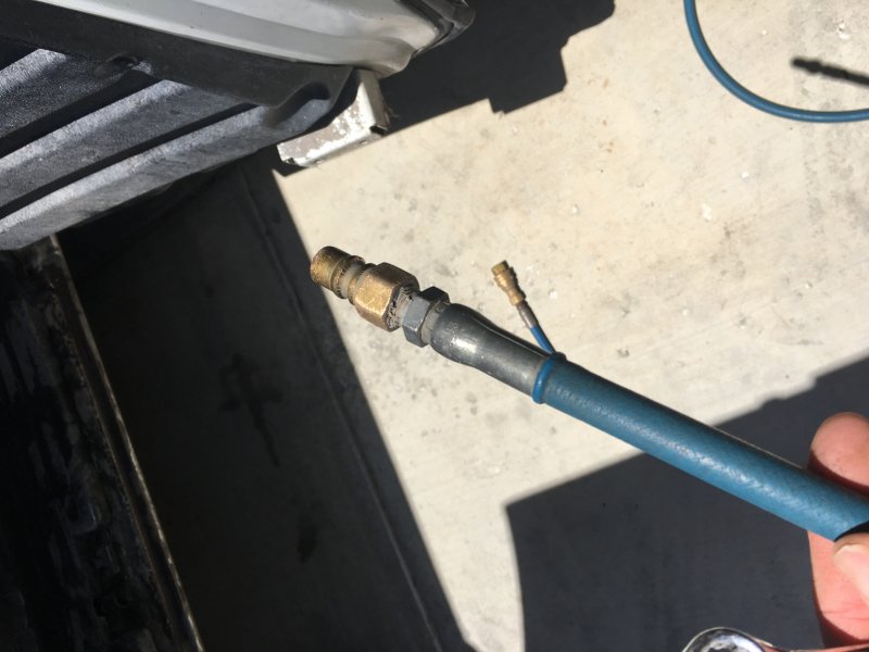

What I'm noticing if the rubber protection sleeve getting pushed up a little.
Phil is notoriously trying to
Use brute strength instead of brains.
I have to replace the ends on the courtesy hose 2-3 times a year because he forces it on while the machine is pressurized.
I never have to replace mine because I depressurize the lines before I put them on.
Are you saying the cause of this burst is due to the way he attaches the hose to the machine?
It looks to me like the crimp on that hose is expired. Keep in mind that when you recrimp a hose, you cut off about a foot of it to get the weakest part of the hose removed.
Not at all it's an older hose that was mostly on the real, when I say older I say older for Goodyear, when I bought that crap I would replace it the first time it broke.
I switched to skinny Shiffer that was better, the parflex which is awesome.
The Goodyear I have now came with the 2.5 year old 570, and 3 month old pro 1200se.
I got 3 50 sections with my 570, and a 100 footer with my pro 1200.
The first think I did was a 100 foot of parflex as the lead line.
The second 50 footer is used 2-3 times a week, apart from where it failed it's in great shape.
Question have you ever tried to attach a hose to a pressurized machine????
It ends up blowing out quick disconnects and pre maturely wears the crimp.
