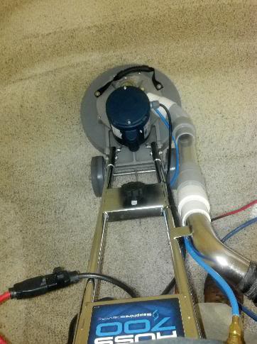

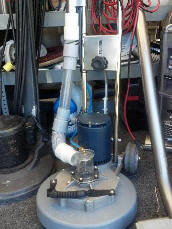

aftermarket sight tube...
Point of view (normal stature) folks can't see the factory site tube-ette

The sight tube in the first two pics looks a smaller diameter than the two inch hose on the machine.
Jim, can you measure it and tell us what size it is?

You sould be able to cram the sight tube into your vac hoses without cuffs.

The one that was sent to me is 12 inches long and 2 inch OD....
