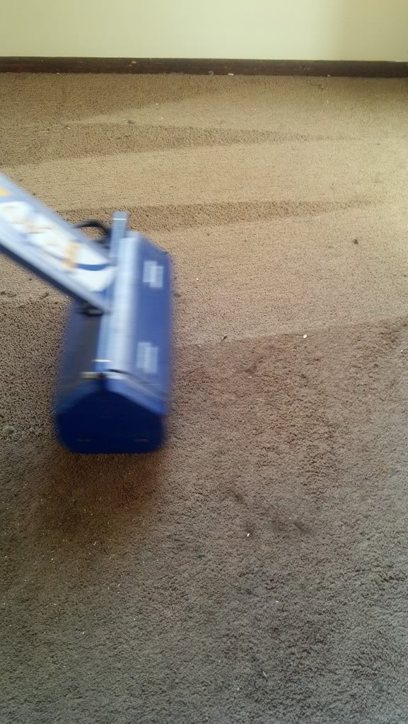

another slopp and gobble
before
S
before
Not dissing SnG but that floor needs vacuuming and nap adjustment dont count as clean. I does look brighter were its flat! I want to see the finished job!
