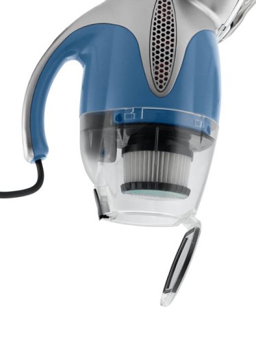

Currently I'm really liking this gadget...Great but gentle agitation and really pulls fine dust and dander out.
No idea how long it will last but it's cheap enough online to buy twice a year if need be.
http://www.royalvacuums.com/select-...ums/research-by-product-type/handheld-vacuums
The pleated filter needs cleaning after most jobs. A good opportunity to show the client your nerdiness...

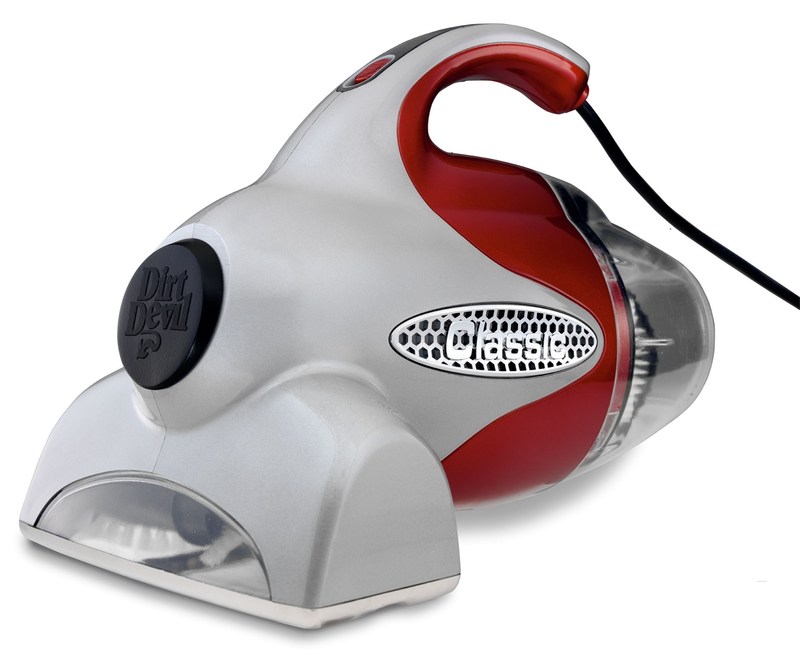

This is what I use, has always works great.
