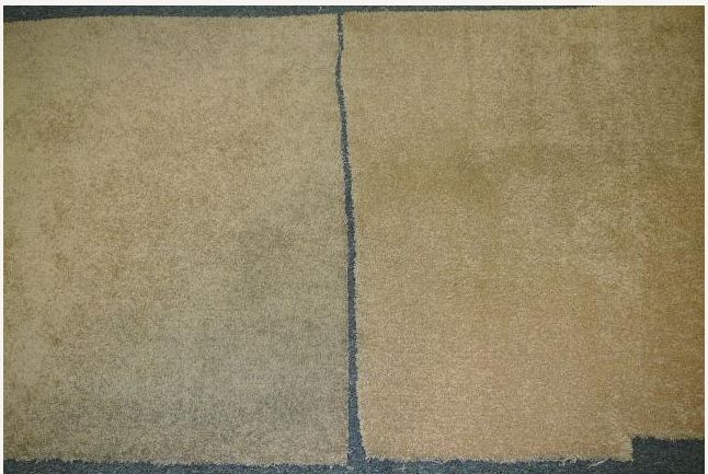

This one a Mohawk rep & IICRC instructor Jim Smith brought in for cleaning.
6 months old, couple with no pets or kids. Premature traffic lane grey.
Uncleaned on the left:
Had to add POG to our PowerMax powder to get it clean.
