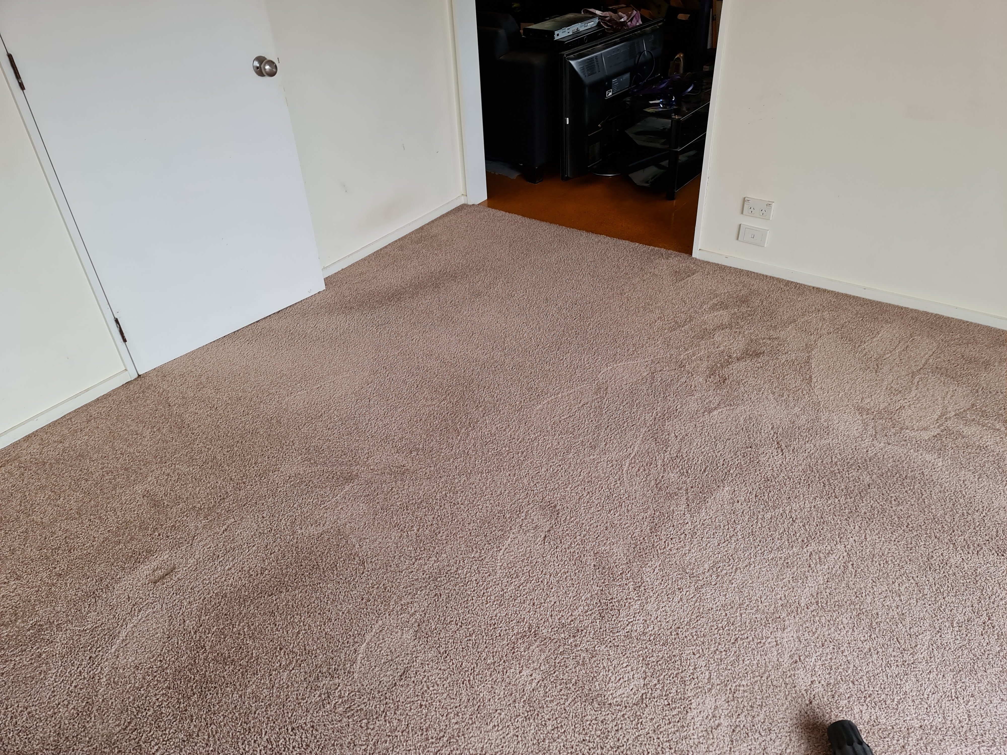

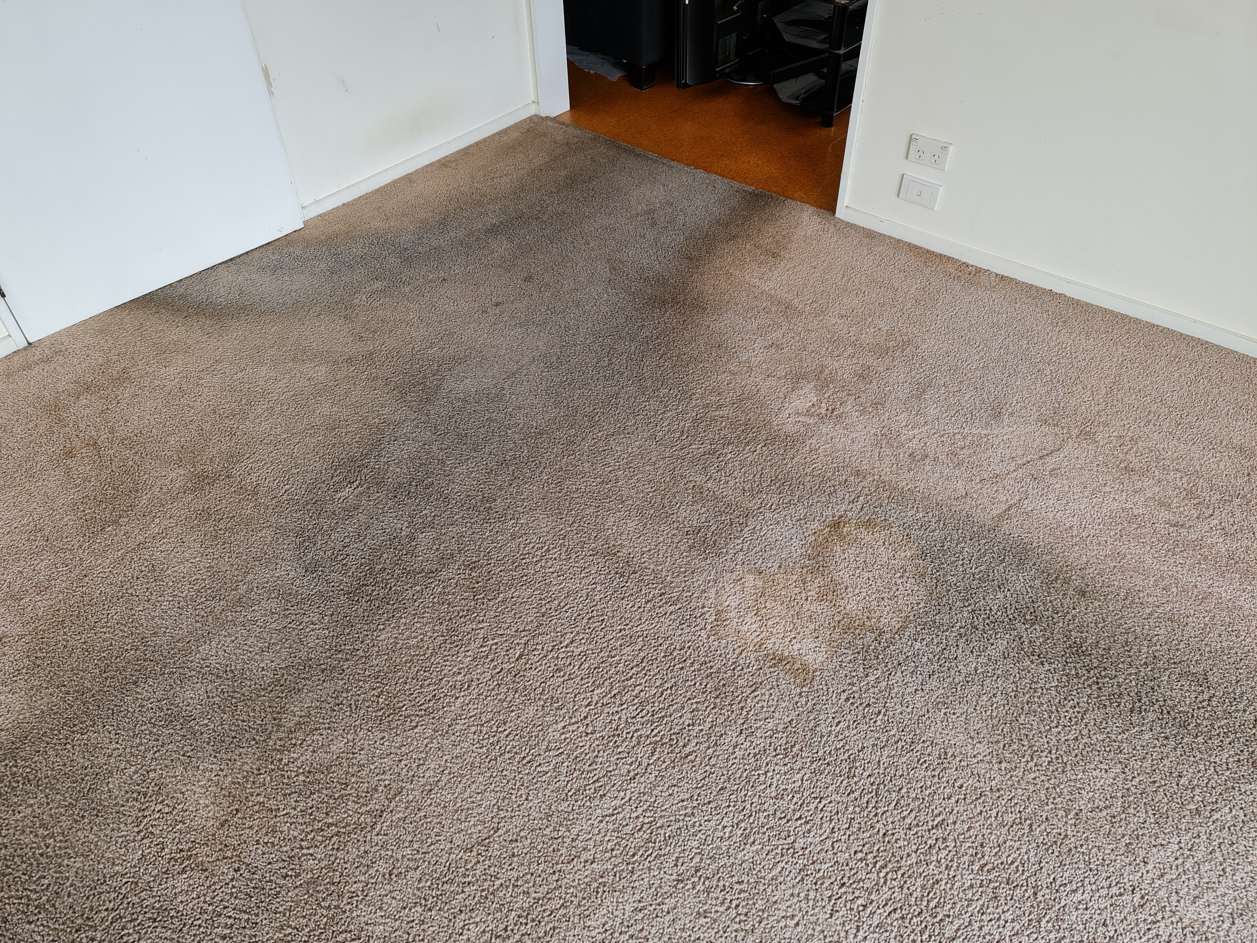

Seriously, though, how do you know what you can save? Do you guys have example pics you can post for me that show something you knew you could save vs something you knew you couldn’t and how you came to that determination?
I inspected a commercial property last week that definitely needs a demo spot done before we know whether it can be cleaned or needs to be replaced, but with commercial I feel like it’s much more obvious. As helpful as you guys have been to me lately, I can’t post pics here every time I have a question. I need to fast-track the learning.
Wear is obviously going to be in the traffic lanes, but it's going to be more pronounced on the pivot points of those traffic lanes.
That's where you will see crushed and distorted fibres that won't look right after cleaning.
Your pics had uneven discolouration in traffic lanes, but not shadowing or excessively crushed fibres on pivot points.

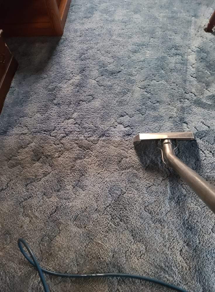

This is one of Scott’s after pics. He used a different rinse and it came out better in some places, still brown in others. She must have been happy though, because she paid her bill and gave him a tip.
In all reality your tech probably could have cleaned it 100% and your customer still may have had a complaint.
Your customer was use to Scott and probably expected Scott to show up for the cleaning. She wanted him.
