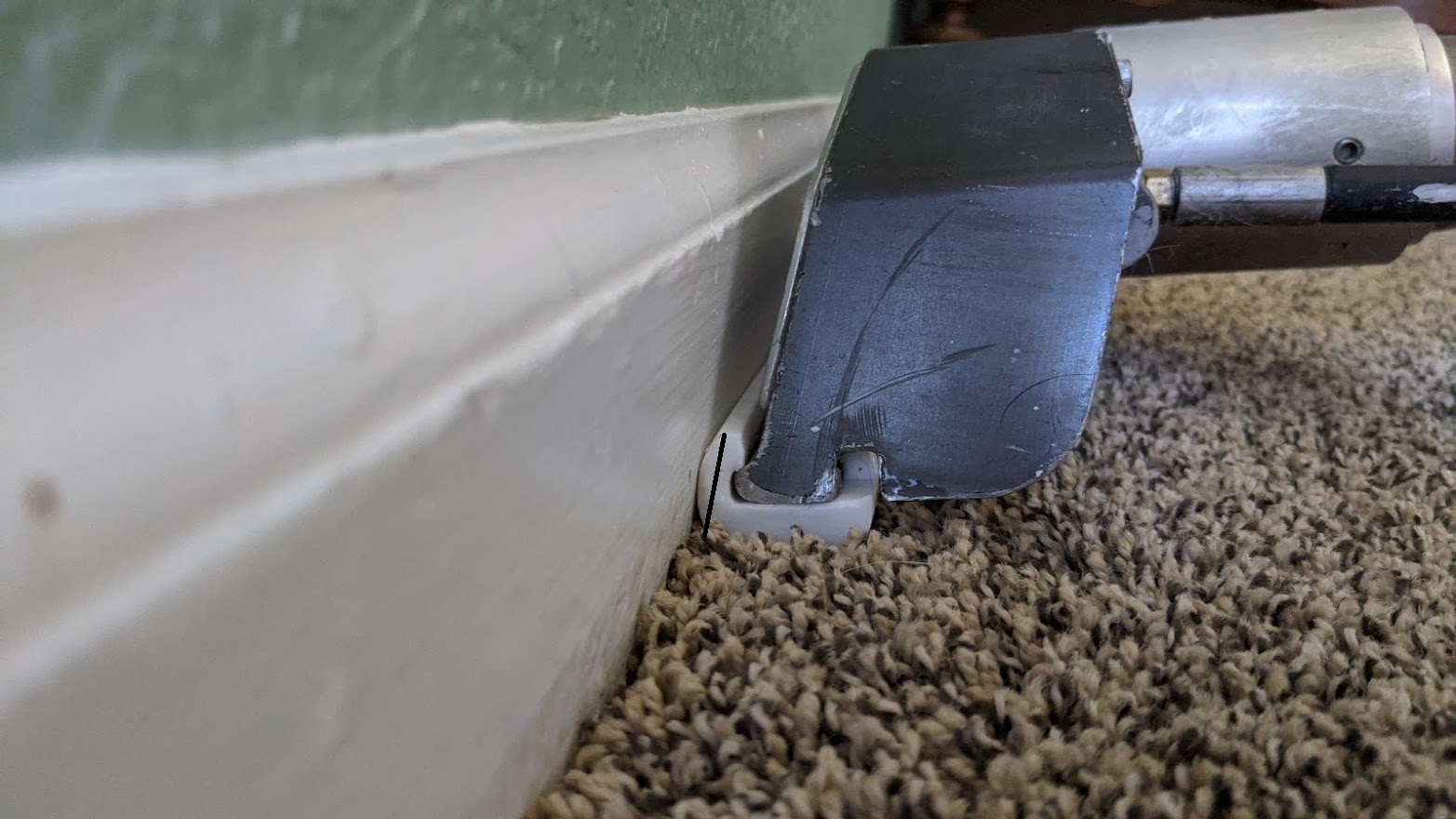

The Dev 12 kinda sucks and I'm pretty sure most Glide fitted wands all do..
Its almost an inch of carpet not getting cleaned going head in with the wand, so I go along the walls from the side when needed
What do you think about cutting off some of the face of the Glide to enable the vacuum slot to get closer to the baseboard?

Can you have an internal fit glide with out all the extra material on the front?

That’s the only thing I liked about the single lip Teflon glides.

Prochem Upholstery tool to detail edges and around furniture not cleaned. Once your on your hands and knees you get an up close view of what everyone else would miss.
Guess Im a 1 percenter

It’s one of the only things I like about the stock Evolution glide. It’s extremely thin, so it actually does pretty well on baseboards, especially with Joe’s jet kit.

It’s also a good thing on the stock Bentley stainless glide, even though I didn’t use it. When I did, I could hit baseboards very well.
Mike, is it possible to make a Teflon glide that fits inside the wand’s vacuum slot, like the Bentley stainless glide?
That could be something. Maybe not.

Yes it's possible and we actually have quite a few glides that attach that way but the mouth of the one needs to be wide enough to fit the inner lips and allow for good air flow I wish all wands came with that design as it's much easier to pull them off and on without distorting the soft Teflon Tom Conway kind of blew it with his wand by not making it fit in a plug or a slide on dovetail fashion like the evolution wand
