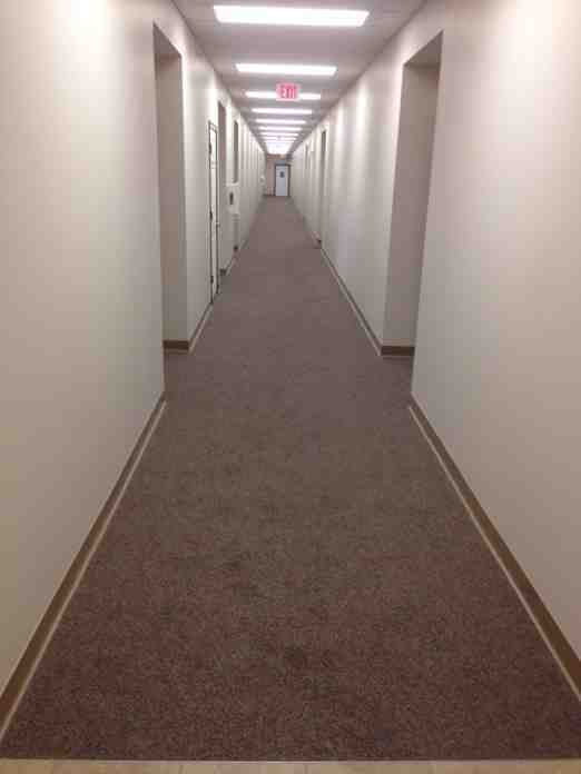

Large property manager interested in having us maintain their common areas. Almost 1000 square feet of CGD per floor in 2 and 3 floor buildings. Cimex would be used in halls after prevac. 20 large stairs (@ 6 feet wide) per flight would be cleaned with my Truckmount. These buildings are only about a year old and I want to be smart on how to approach this. Any suggestions on pricing and frequency? Maybe some kind of incentive? They have been considering doing this "in house" but want me to bid. Thanks.

One thing I'd do for sure is give him two quotes, one encap, one hwe.
Sooner or later somebody is going to have to rinse out the encap. Let him know ahead of time.
ALL OVER IT. :winky:
Easy work, the only hard part is carrying up the Cimex.
Don't you have a 175? I'd get a pad driver if you don't already have one, vacuum very well, spray it heavy with your favorite encap juice. Hit it with a damp pad as your rinse, flip the pad every 400 feet or so and go steam the steps.
The hall might take you an hour but probably less .12 x 1000 =$120.00 X 3 =$360.00 per building.
Steps suck but the soil is on bull nose & treads more than the risers. I might discount some off your regular step price but not much.
No discount for frequency but a quick pay discount 5-7% if paid in 10-days

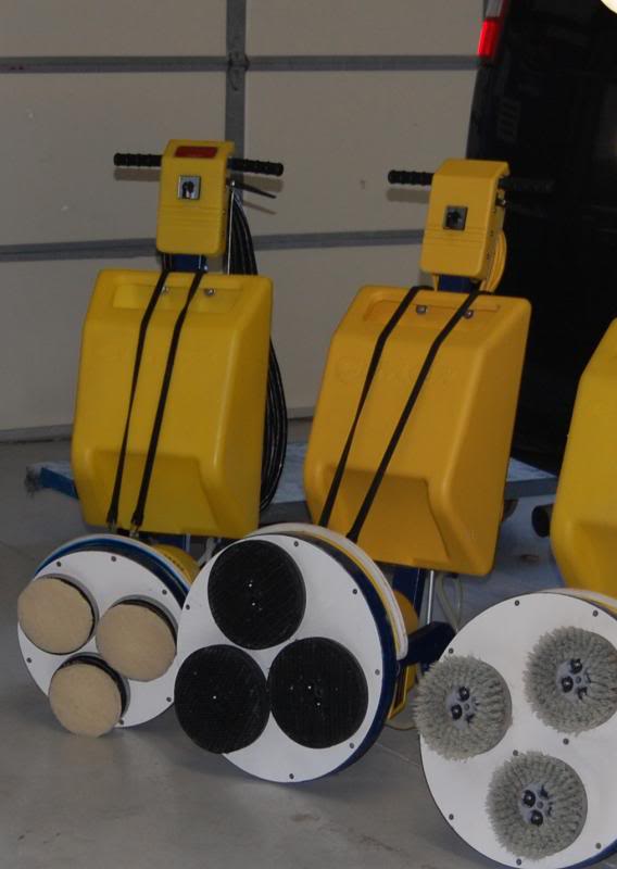

Richard, I do have a 175 machine. Would you use that rather than the Cimex? I have both.
The Clean Machine
Yes only because I can tote a 175 up a flight of steps (I'm a big fooking gorilla). The Cimex while not much heavier is much more awkward, I can't carry it alone.
It will also dry faster, less product is used and will still look great.
Plus your Cimex won't help you much more with production being that the hall is small in width. Large areas I'd lean more to the Cimex, smaller areas an OP or 175 will do just as good. :icon_cool:

Good point. I think I could muscle the Mex up, step by step, by standing above and pulling by the handles but the way down is a little SCARY. There isn't an elevator in this particular building but there IS in most of their buildings. I think I better get comfortable doing encap with a 175...never done it before. Actually the only thing I use my 175 for is stripping VCT. I KNOW ITS WAY VERSATILE MIKEY, I'm gettin' there!

If you put the larger wheels on the cimex they are easier to roll up and down stairs.
