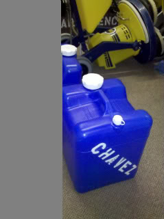

We have jugs like this filled with water. We drop them off throughout the facility so then you just refill quickly and easily.
