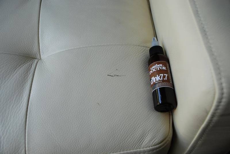

#1:

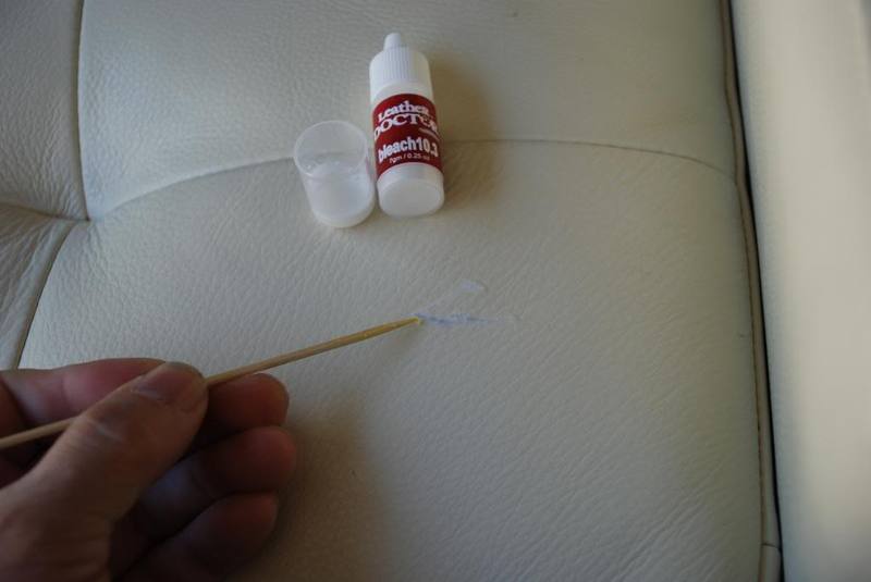

This ballpoint ink mark is more than 2 months old, and d’Ink7.7 only manage to lighten from black to blue even after an overnight dwelling.

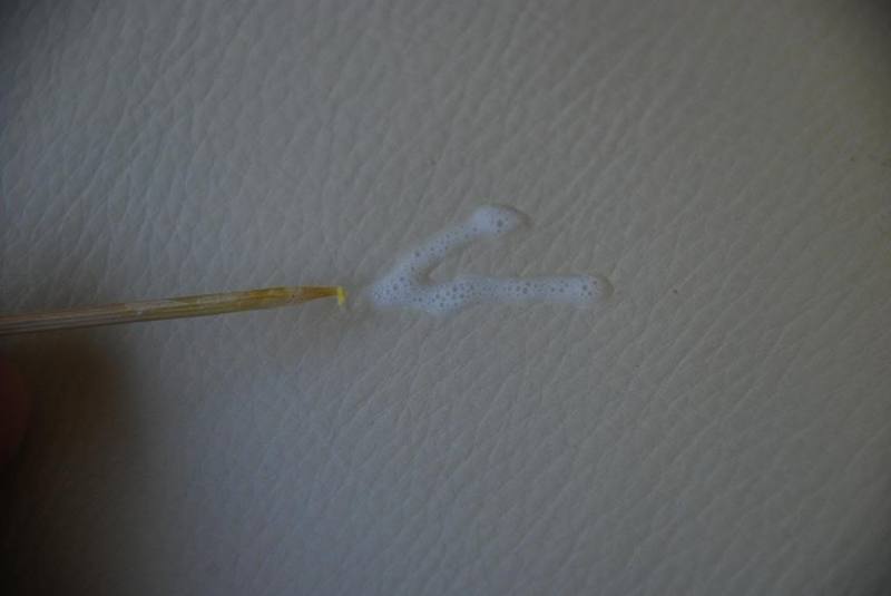

#2:
This is where bleach10.3 comes and helps bleach it.
#3:
Here is a close-up of this creamy paste over the ink stain.

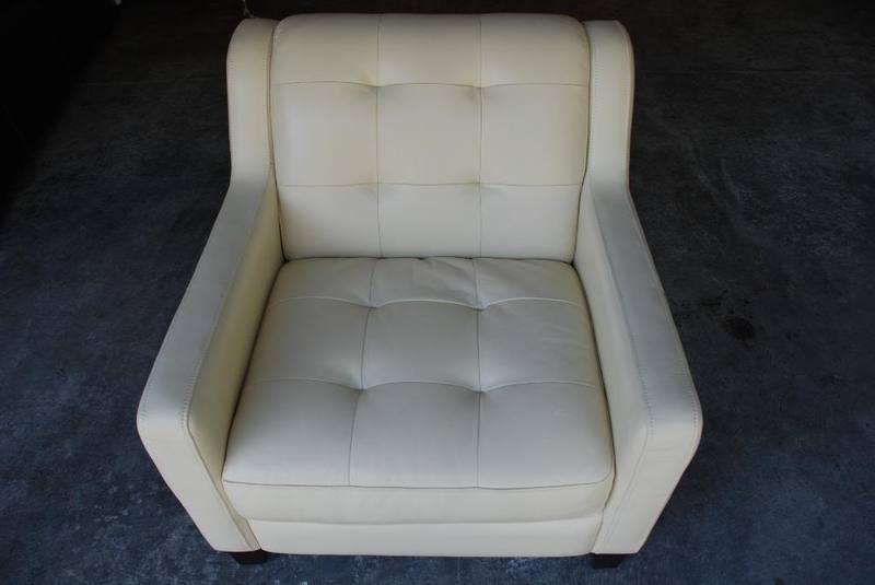

#4:
Here’s the full view of the chair.

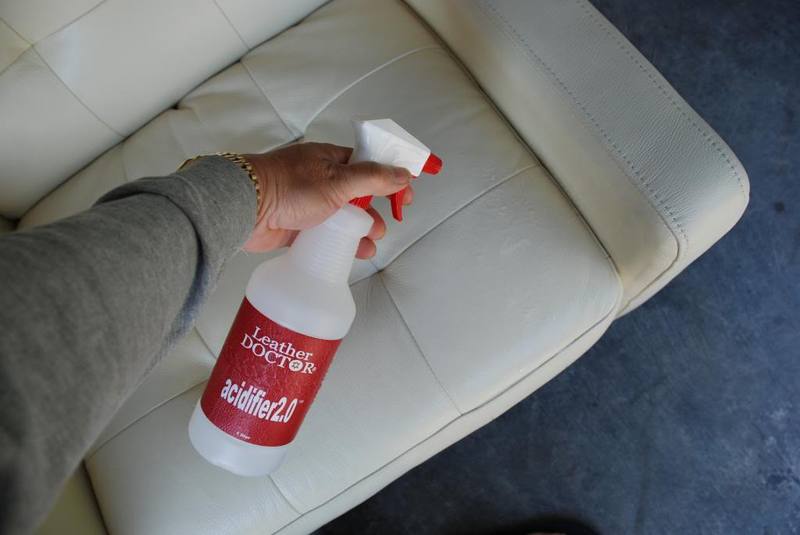

#5:
The high alkalinity need to be neutralized by acidifier2.0

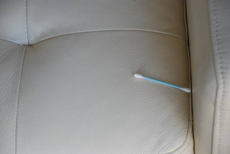

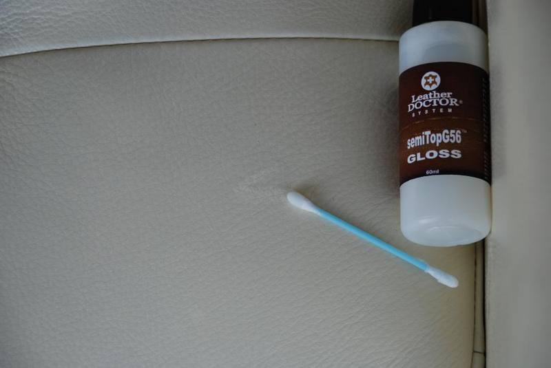

#6:
This picture shows re-touch-up with a matching topcoat.
#7:
A close-up of the final result!
