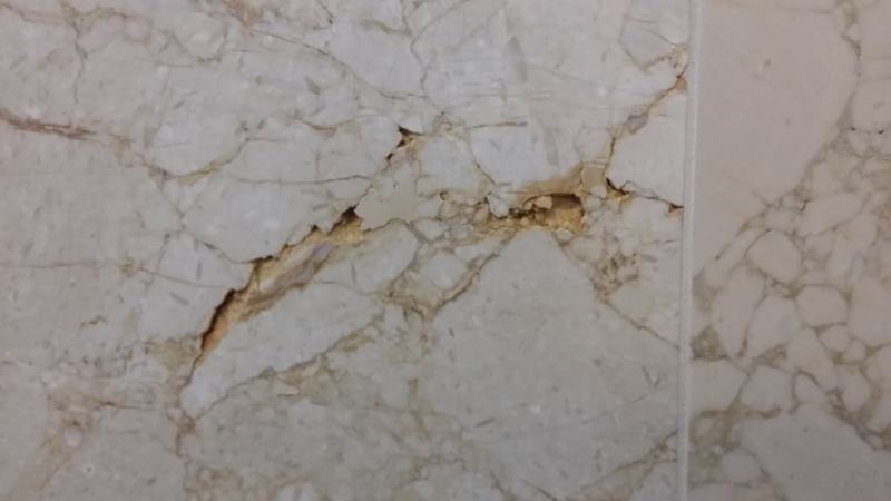

How would you fill this?
117,366
Shower wall..
Feb 5, 2013
527
cameron demille
not in a large area like that. plus the resin will polish like the stone if they ever have the floor restored. better integrity repair, better for your name in the long run
G
GCCLee
Bondo an a airbrush w some enamel paint
