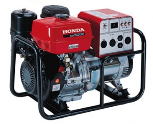

I can remember the first ETM's I built many years ago, where I used an on-board generator for power, getting it's fuel to run from the van's gas tank fuel tap system.
However, I then got so much crap from so many people that if you use a gasoline powered generator to run the machine, why don't you just get a gasoline slide-in.
So I proceeded to design the ETM so it would only require two 15 amps circuits, and would still cover 200' from the van when cleaning. I still have the genset, but rarely use it, and, the ETM is still kicking butt and taking names.
