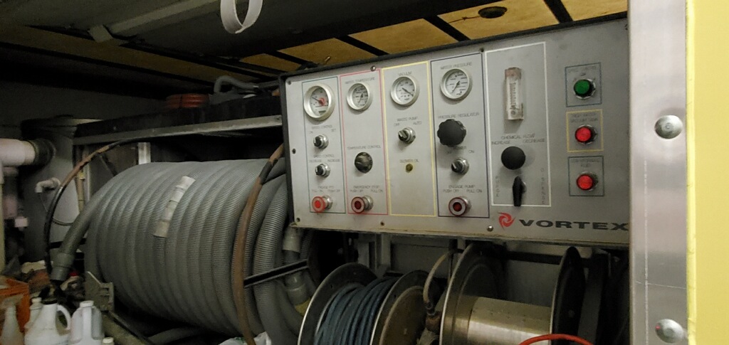

Hey guys, recently bought two identical hydraulic vortex trucks as a pet project. Bering trucks with hydraulic drivin 6008 blowers, does anyone have any kind of info on these? Ive tried finding info on the interweb but all i can find info on is the newer models in a UD truck (wich i have also). Any kind of help would be greatly appreciated owners manual would be amazing

Weve decided to gut the heat exchange, relocate the hydraulic cooler, blower and silencer, adding a eurotec diesel burner for heat, few other odds and end improvements.
Mainly wanting an electrical schematic and im trying to find a place to buy parts for the truck itself or retrofits

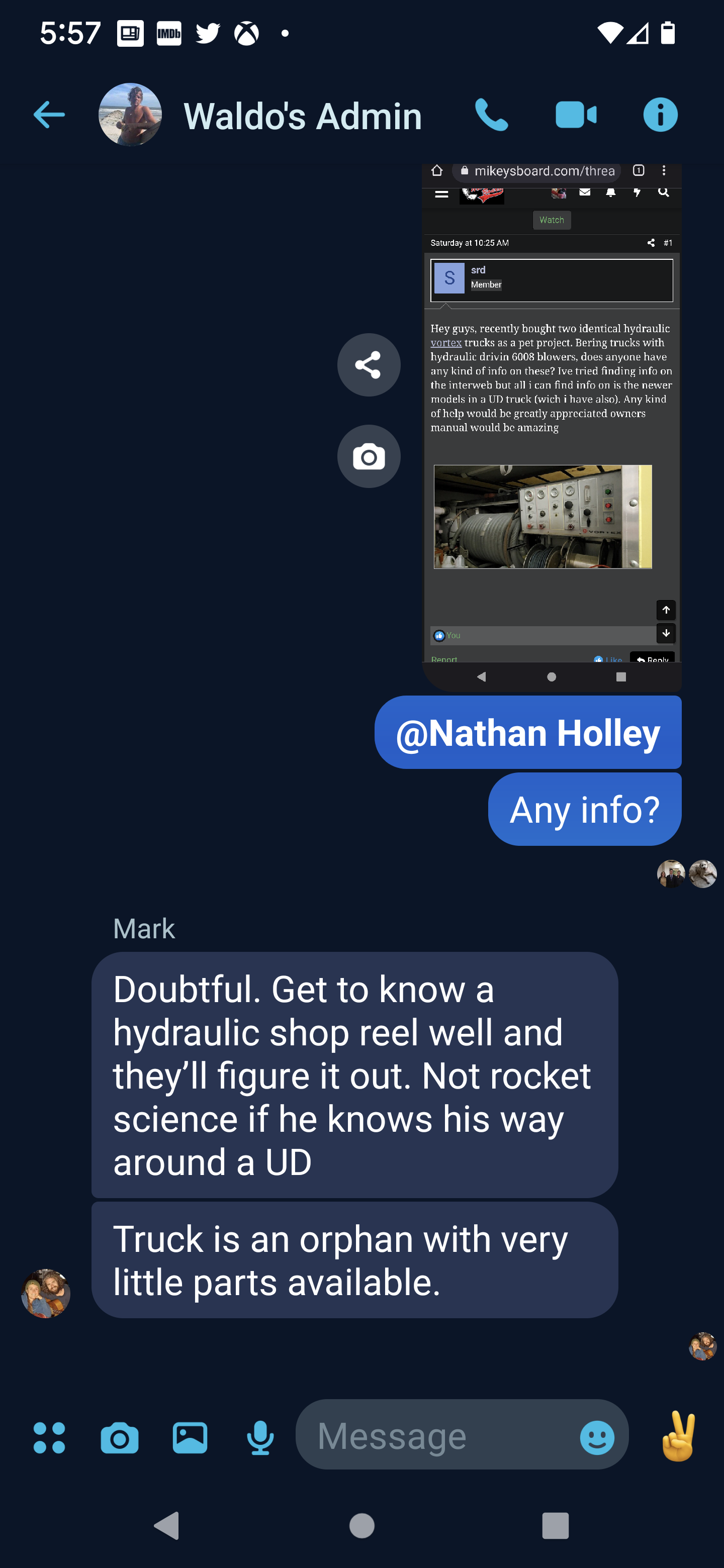

11,115
Nathan Holley on Facebook keeps his running.
He's in Canada and has a guy that he loves.
11,115
Best I could do good luck
