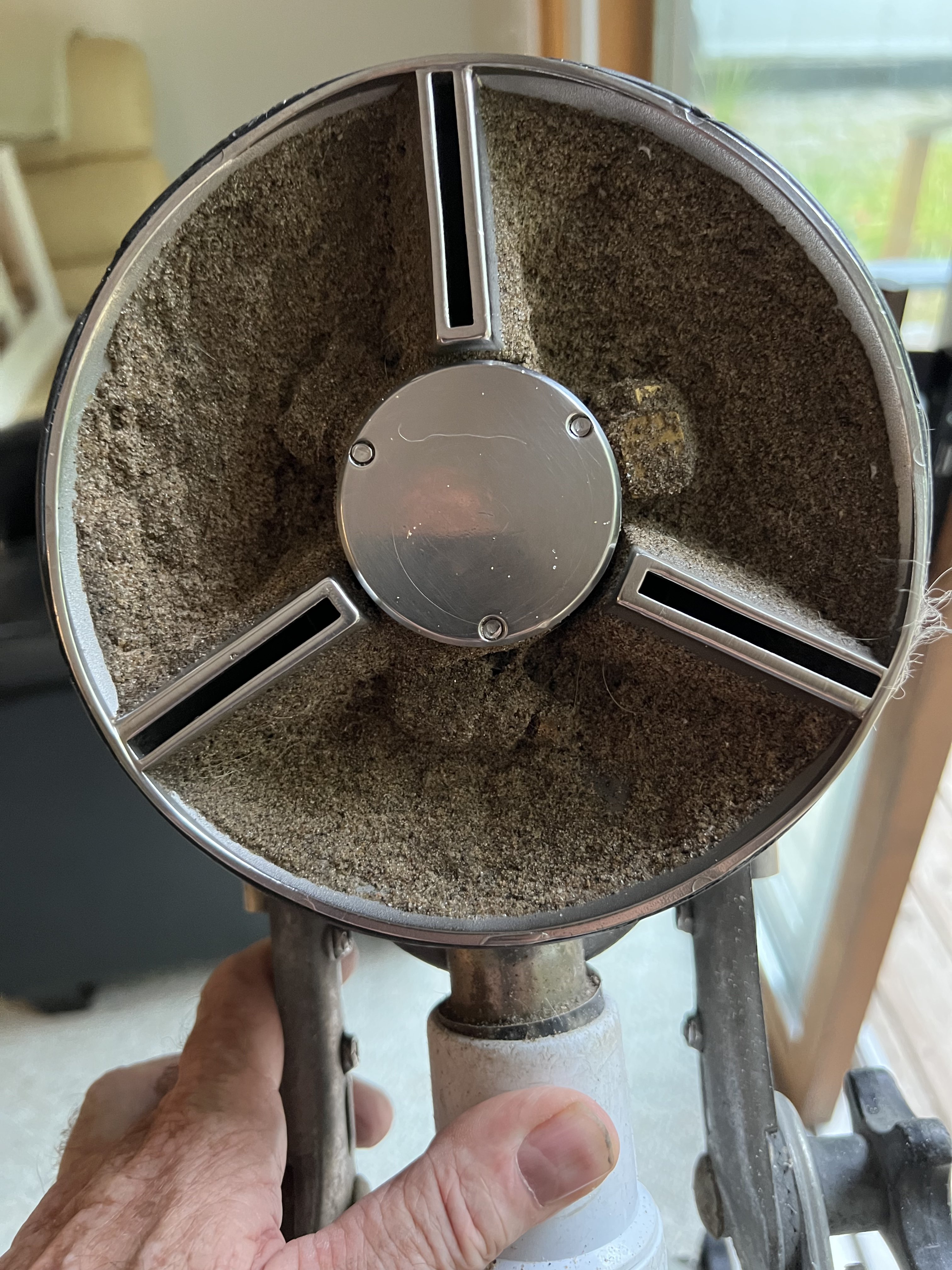

I'm working on it. Another of the benefits of my RVJR'S. You don't get that steam spray puffing into the work area everytime you trigger the valve. If I look close to the surface when the solution is flowing, I can see a small amount of it being thrown sideways on some carpets and at transitions/doorways. Never do I have blasts of hot vapor introduced to atmosphere like you see on all/most of the pics/video I see submitted on line.
A silicone brush ring added to the cleaning head like on my tile cleaner would eliminate the side throw almost completely.

As a wear item, the skirt would interface at carpet level, attached to the plastic shroud that rivets to the metal 3 slot cleaning chamber. And I think I will drill one of my spare heads as Bob suggests.
Nothing to lose, lots to learn.
