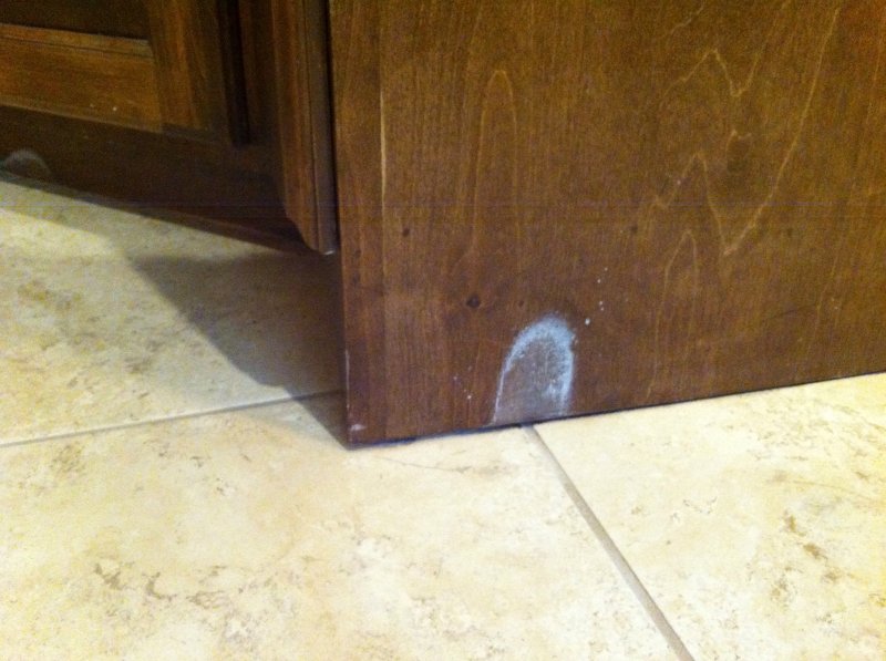

My tech got sloppy while spraying a solvent based grout sealer on the grout lines.
It's my fault because he hasn't been working very long and is an amazing worker. I should have watched him better..
Anyways, is there anyway to get grout sealer off these cabinets without hurting the wood?
I'm so stressed. Any ideas would be great!

I'd try what Shawn suggests. Use a clean terrycloth rag. The sealer should dissolve the sealer on the cabinet and allow you to wipe it off. Good luck!

Just wipe it off with a damp cloth. If that doesnt work, apply some more sealer on a rag and wipe. Also, use the rapid seal system next time.

I would try more sealer first. anything else try in a more hidden location.

How "old" is the sealer? As in how much time did it have, to cure on the wood?

Thank you everyone for the great responses so far.
We sealed it today at 11:30.
I haven't been able to get back yet. Hopefully tomorrow.
There is some very good ideas on here.
I also read somewhere that goof off may work. Anyone know much about goof off on wood?
What is the rapid seal system?
