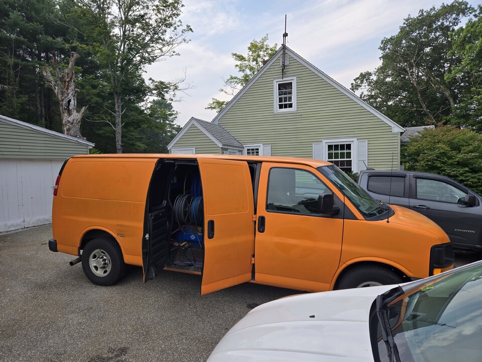

I need to paint my truck, I will when the weather cools down. I'm going for avalanche grey (the same grey on new Transits and Mustangs), hope it turns out well. I spent $1k on the paint, it better turn out well! For now I call her ugly pumpkin 😄

You DEFINITELY need to paint your van.
I'm not sure what is more shameful, my clean pickup truck and trailer with my weak portable doing the bucket brigade of shame in people's homes.., or the ugly pumpkin with powerful jedi extraction technology. I keep getting 5 star reviews. The common denominator may be God's grace and my lovely wife, which is more of God's grace.
Jim hooks me up with good cleaning chemistry and wisdom too. He's also part of God's grace in my life.
For now I'm just waiting for a day in the mid 70s with no jobs and no chance of rain and I'll have an avalanche grey van :]

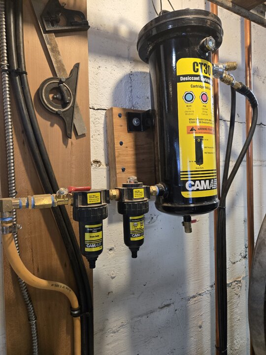

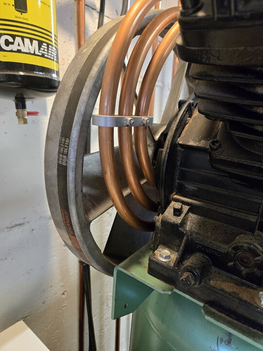

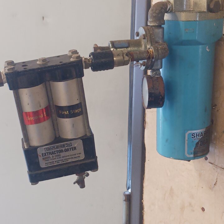

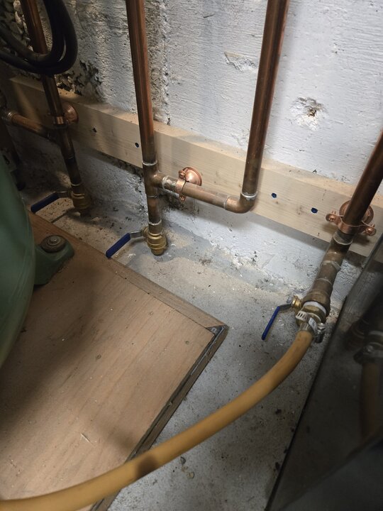

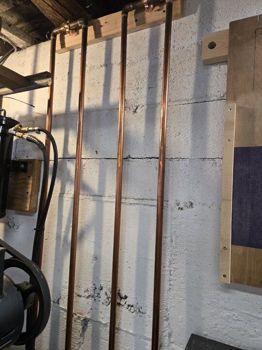

I have a 60 gallon 5 hp air compressor, which is essential. I need to be able to compress and replenish air at least as fast as I am depleting it through the spray gun. Especially on such a large body van with no windows, and laying down the coats consecutively. I doubt I could do it with any less than a 5hp air compressor. I'll just run a long air line from my woodshop out to my driveway and go for it. My wife will be mixing up batches of paint as I am spraying to try and keep pace.
Back when I was spray finishing woodcrafts I installed this network of copper pipes to cool the air from the compressor so the 3 stage filter can effectively remove water, oil, and dirt from the air. And blow off valves at the bottom of the long copper pipes to release accumulated moisture. Which is important to get a good finish. I've never sprayed automotive paint before. I have all the pieces in place to do a good job with it. I'm the variable. I never got really great at spray finishing, but was just good enough to get B+ results most of the time. Hopefully it goes well.

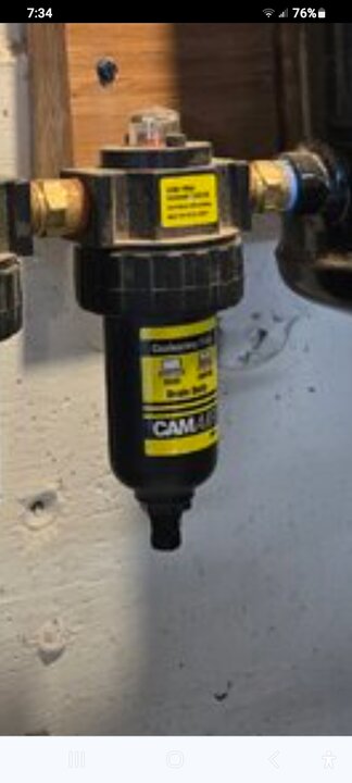

I've painted several vehicles. But any of my advice would be seriously out dated last vehicle i shot was with Dupont centari acrylic enamel. I would recommend that you do it in 2 stages. Shoot the roof first and when dry shoot the rest of the van. I used 3 saw horses per side with a thick wood beam as a walk way so i could shoot the whole roof at once. If you try to shoot the sides at the same time you'll probably at some point drag your hose across the fresh paint . Iwould shoot in my shop and staple cheap plastic drop clothes as a make shift spray booth and air movers as exhaust fans. Good luck

What is an oiler Dwain? As in something that adds oil? If so then no, it is a 3 stage filter system made by Devilbiss for spray finishing. The 2 small filters are designed to remove oil and dirt, and the large filter is a dessicant that removes moisture. Unless I am mistaken about something....

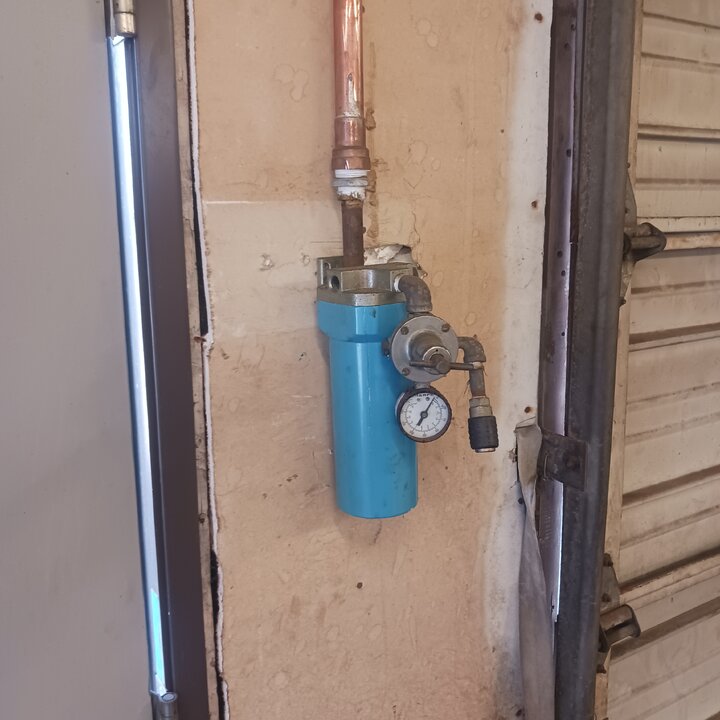

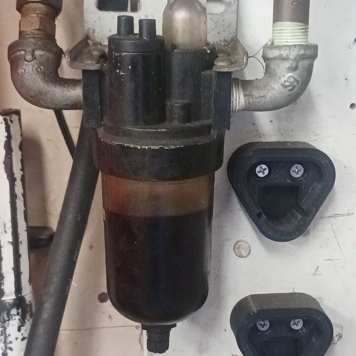

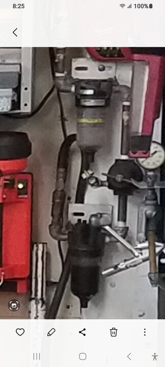

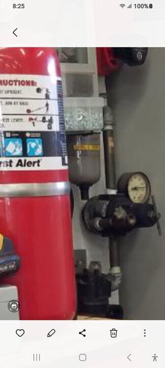

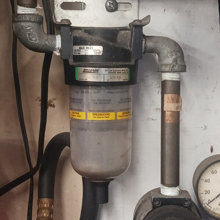

Just checking body and repair shops often have oilers inline i have them at my shop its the one one the bottom with the little clear bubble on top there designed to add oil to the air for air tools . In my shop i have a quick connect after the secondary dryer and before the oiler for dry air and at the bottom for oiled air. The upper quick connect is a universal so my dry air and oiled air hoses will connect but the lower (oiled air) quick connect is specific to my oiled hoses and hoses i use for dry air won't connect i require dry air for painting and bead blasting and oiled for tools. When i saw the bubbler on the top of yours i thought id ask just in case

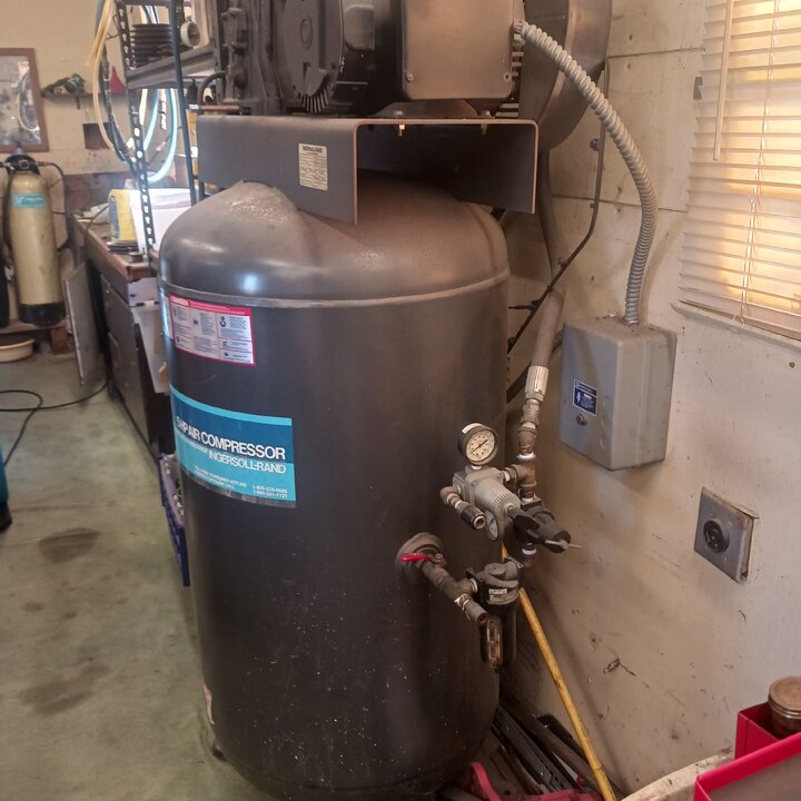

Im at the shop so i can take better pictures my oiler has that little bubble on top. Compressor is 5hp 2 stage 175psi@ 19cfpm reduced to 150psi and dried to supply 3 regulated stations 2 with dry or oiled air and 1 dedicated dry/with annde second and third stage for paint

Right-o. Nice setup. I don't have any air tools aside from an air hammer, but was thinking about getting some air tools soon. I imagine it will make a lot of mechanical work much easier. Is it a good idea to hook up an oiler whenever one is running air tools? Does it prolong their life or eliminate manual maintenance or something?
Consider milwaukee m12 battery tools first. You have more options for use when not Tethered to a compressor. I still have a few air tools i use periodically but ive switched to battery over the past 7 or so years. I like the m12 platform because there is more options for mechanics i love there m12 fuel ratchets, cutoff tool and impact wrench. I wish i would have gone m18 for the drills though and probably soon will. The problem isn't so much the 3/8drill but the 1/2 it eats batteries. When the bit bites and stops the drill it puts a heavy load on the battery and if not careful will damage um where as the m18 is more able to take the abuse. I have everything from Sawzall, jigsaw, circular saw cutoff tool ratchets impacts borescope thermal imagine camera sodering iron drills all m12 only ones i would change is the drills.

I like the orange too AND want to take over the world (someone needs to be in charge)! New to the site, figured it was easier to start with a comment!

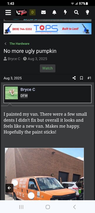

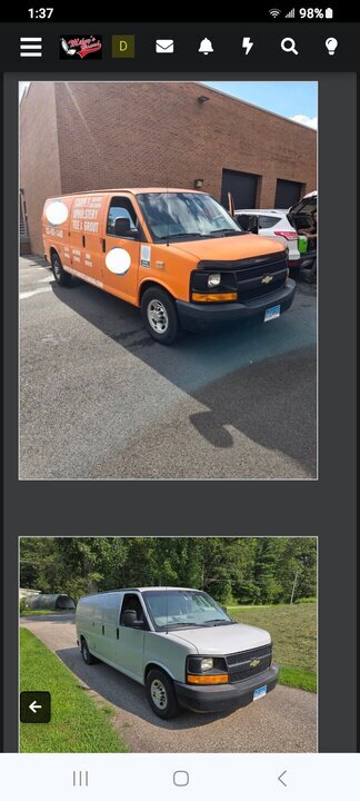

He didn't, he repainted it in July and is now taking over the world incognito
