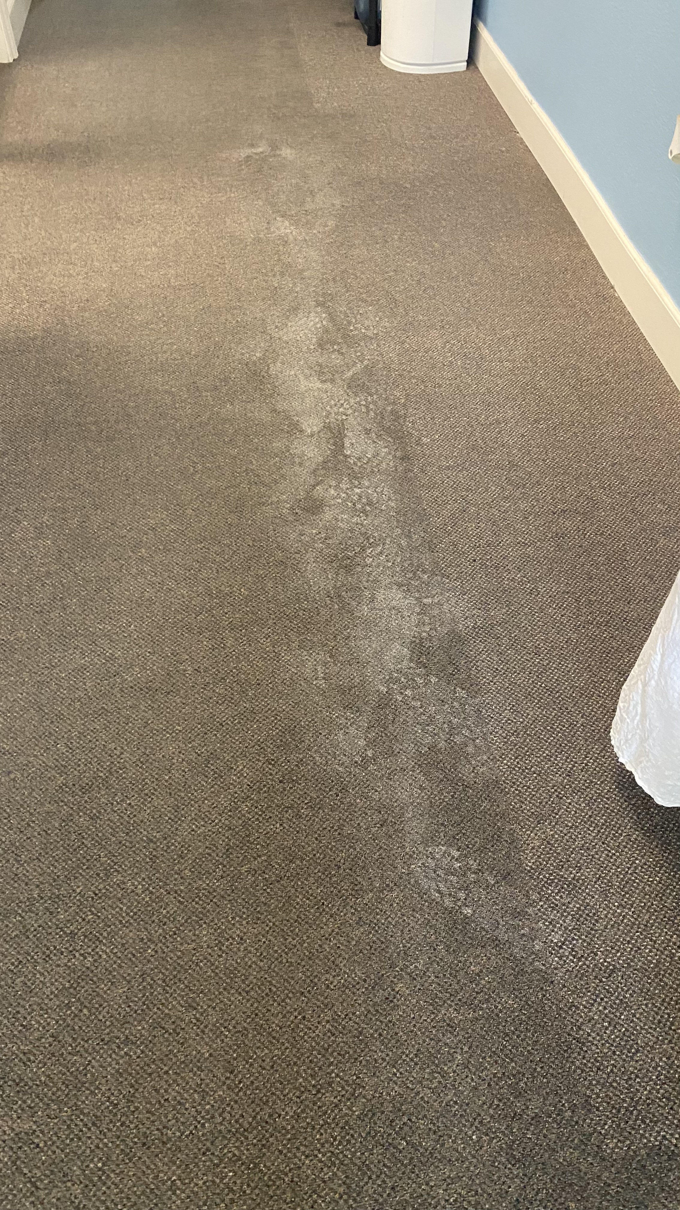

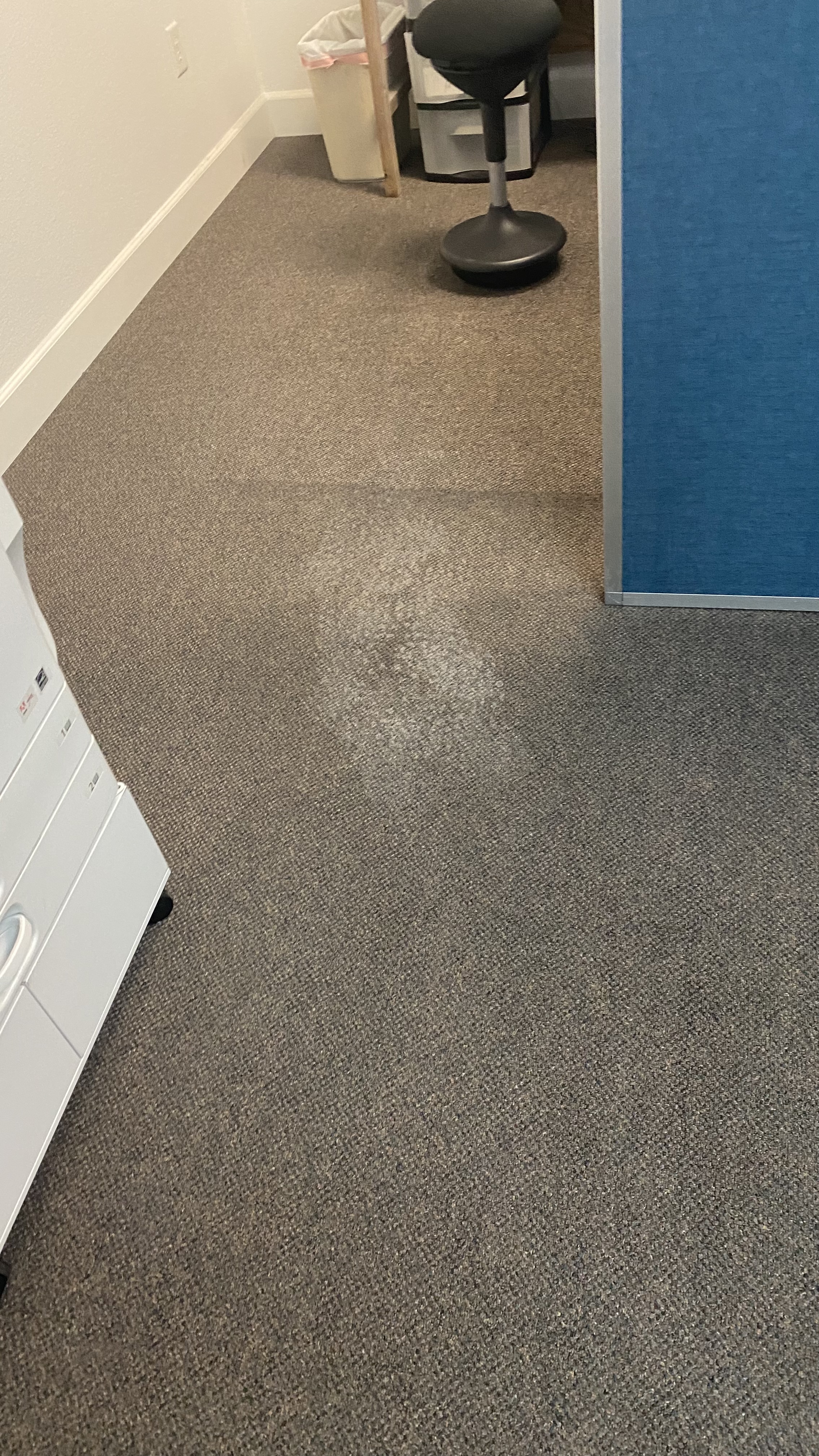

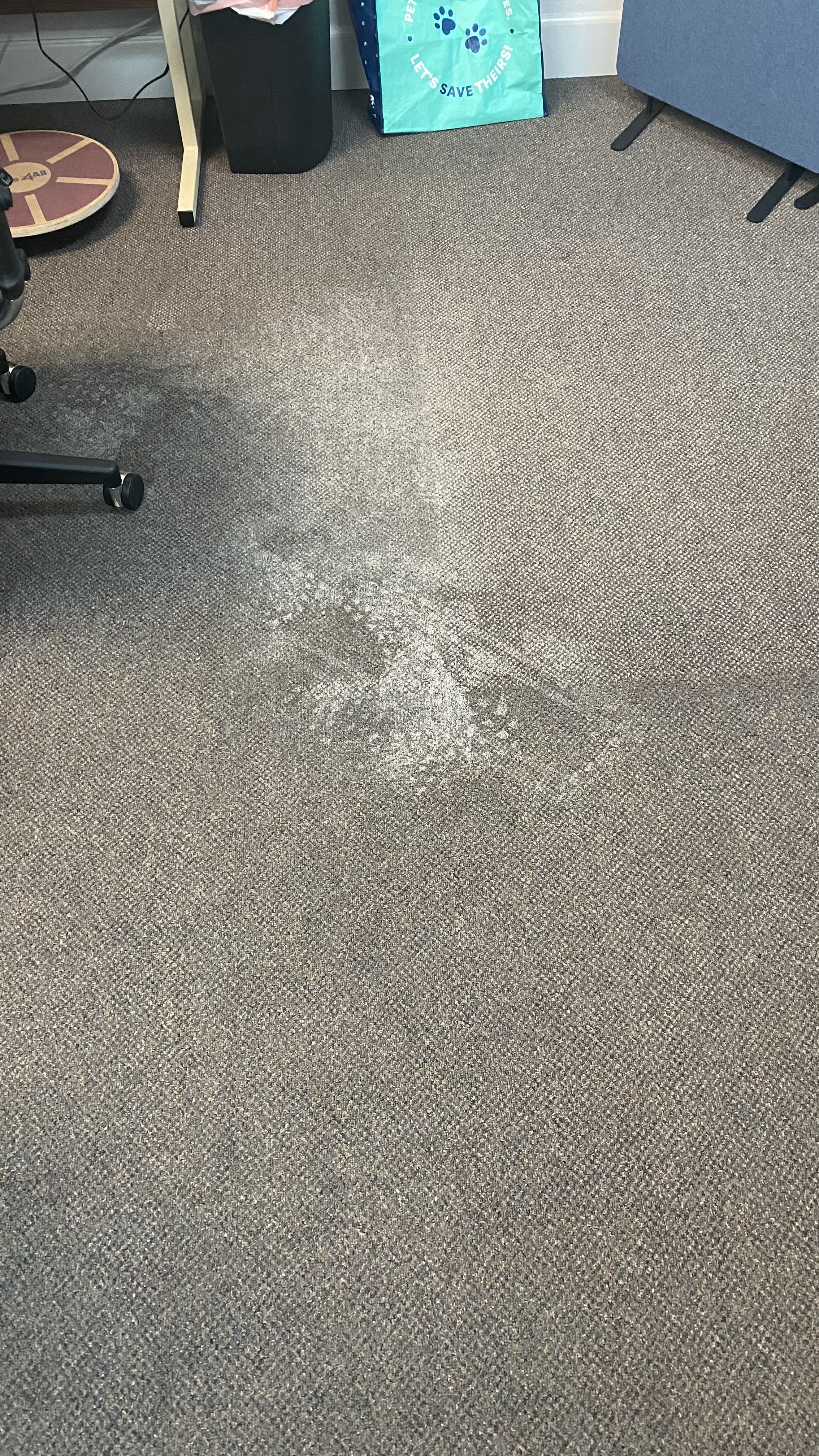

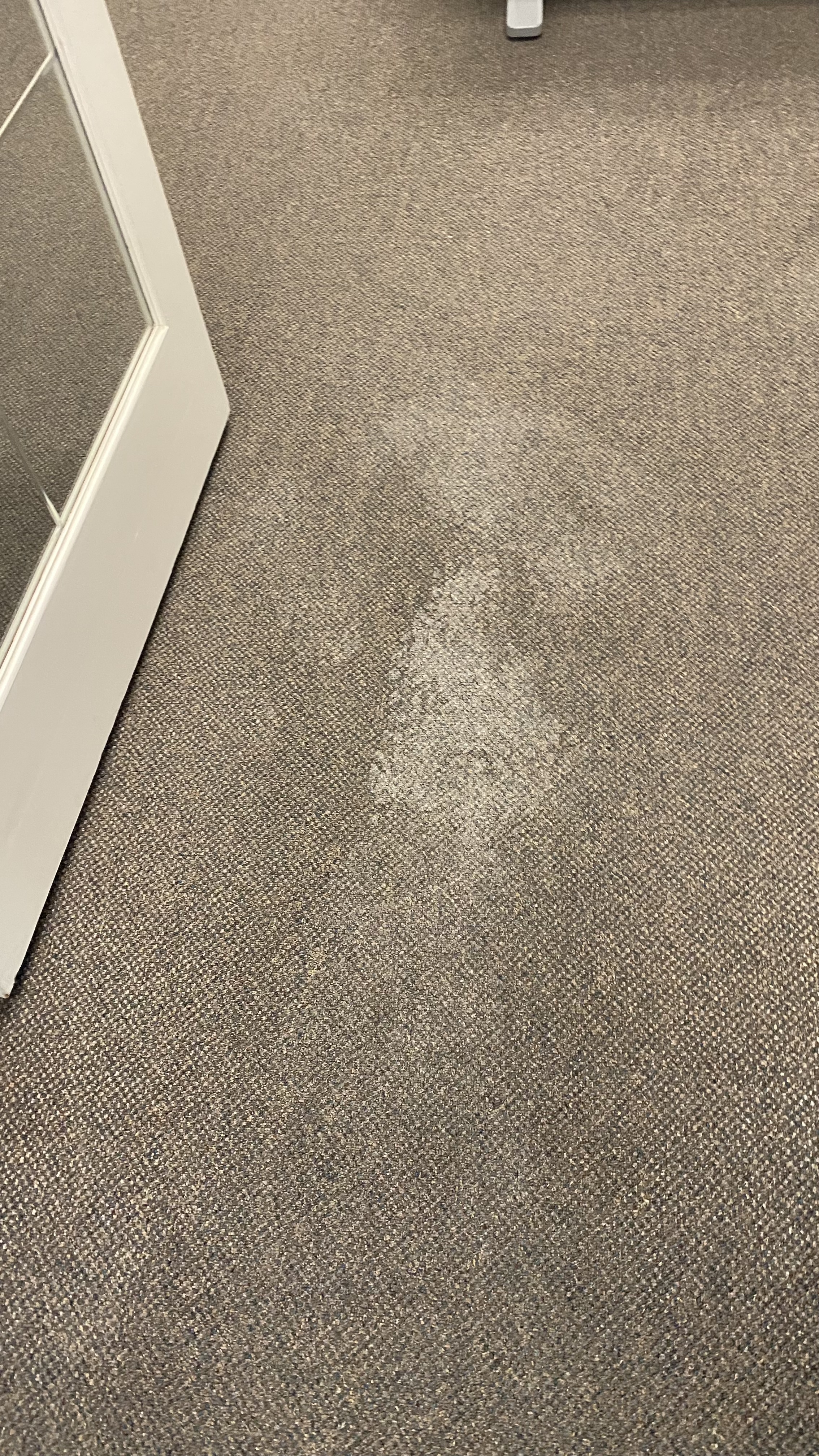

Used Green Dragon encap powder for the first time. I’m not impressed. I should have just used my normal Awesome encap or Angry Lemon or DS2.
Got a call back from the customer saying there is white chalkyness in places. Going back tomorrow night to reclean.

was it the first time you cleaned that office?
I wouldn't be impressed with that "cleaning" without the white residue...

Yeah. I’m not telling the customer to vac it up. To me this is an unacceptable result. Never had this happen with my other encaps. The customer should not be required to do work after paying me for a cleaning. I’ll fix it tomorrow. Who knows, maybe I just need to vac it.
Fix it correctly by rinsing it properly

You might be able to vacuum that out. Was it mixed up good? Maybe you had unmixed powder getting put down?
I don’t use Green Dragon or any of those VLM powders. Was always too afraid of something like this happening.
