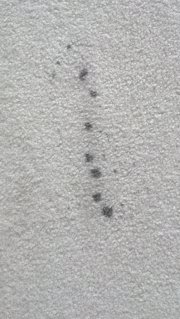

India Ink spill job later today
114,121
any suggestions?
My last ink call was an exploded printer cartridge that rinsed out with just water.
I dont think I'll be that lucky this time.

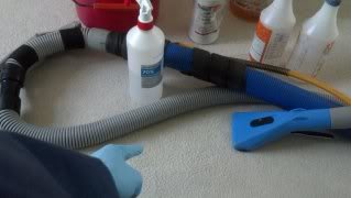

I'd try solvent first, Prosolve, Power gel and I'd blot into towels as much as you can before you rinse any out. Get as much mess out as you can before flooding it. The I'd use the Hoss to flush it, that dude should work better anything on flushing and extracting. Anything left I'd use Stain Magic.

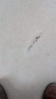

Untouched..

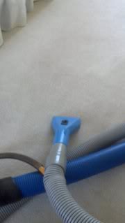

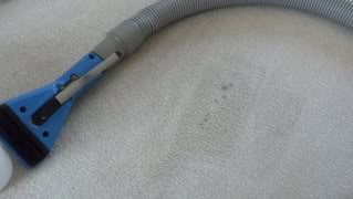

I hit them both with 40 vol and Ammonia then began rinsing with a IA and Hel Gel ...apply agitate rinse repeat.. took about 15 times to remove each set of drips.
Luckily the ink did not go all the way to the backing..
Half way done..
Done!
