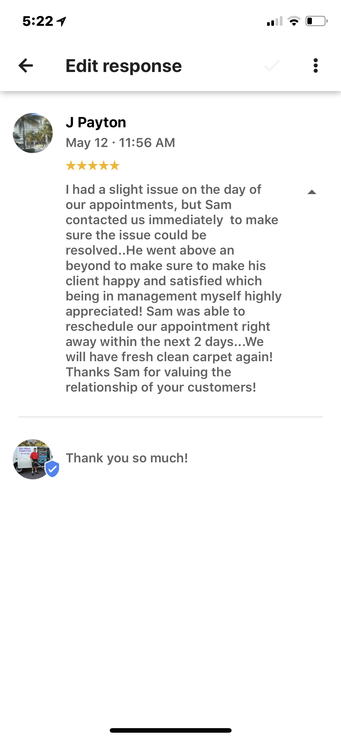

They kicked Phil out and changed the 5 star review to a scathing 1 star review on google!
I tried calling and was told your wife was rude to my husband and hung up on him we have to go!
My wife says the guy had her crying, and both my daughters said there’s nothing more Mom could’ve done! He was a jerk!
These people are repeats and have used us a few times too!
But the new review failed to mention they rescheduled two times on us and once because we were having a scheduling issue!
Very pleasant everytime!
I texted the Lady of the house who loves us and apologized and said your husband was yelling at my wife and had her crying!
And after all this I was still willing to come clean the carpet for free!
Because I feel horrible!
She ended up texting me back saying her husband wasn’t yelling but sounds like it cause his voice is loud!
And if I would clean it for free she would Change her review!

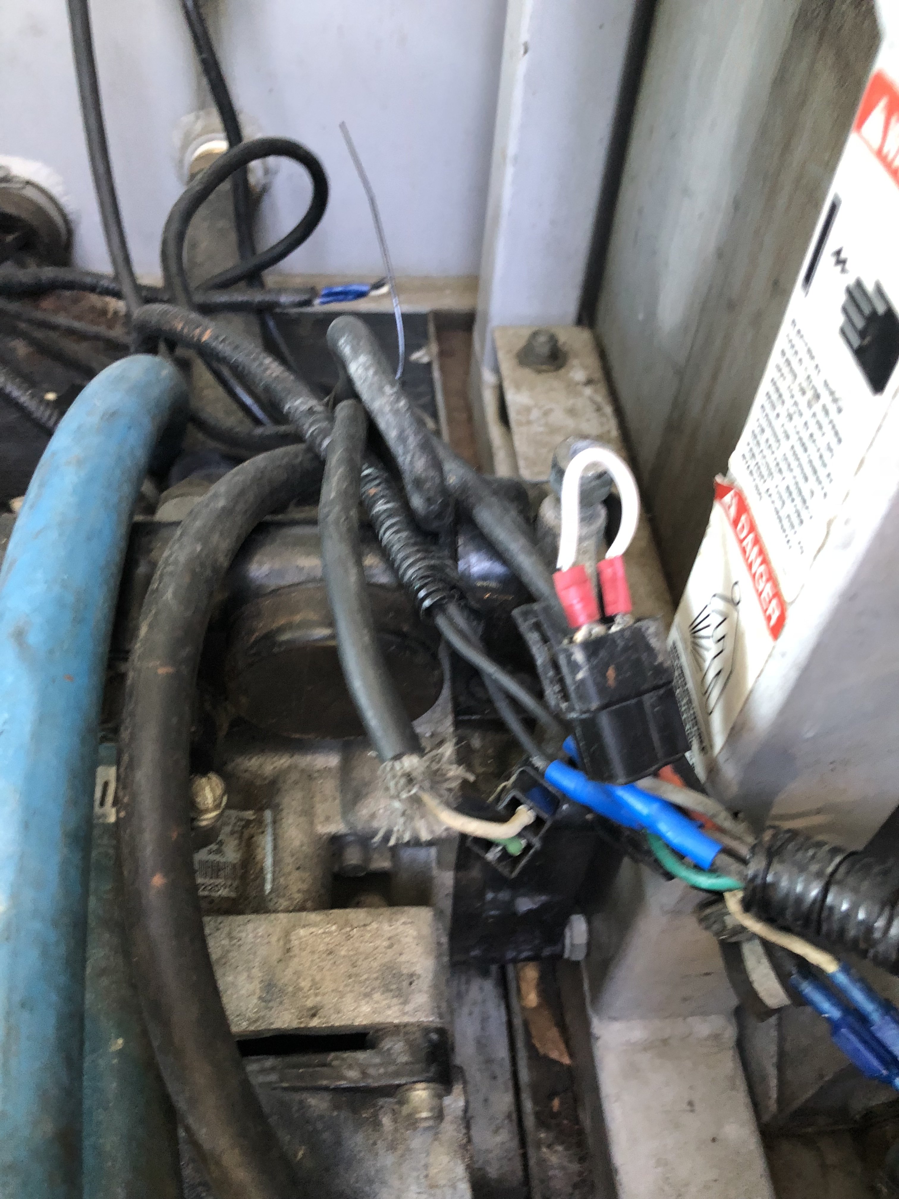

I ended up swapping trucks with Phil and trouble shooting his truck at home!
Changed fuel filter jump started it ran for 2 minutes and shut down!
I finally bypassed the shut off float switch and got it started!
Let it run 20 minutes and went and did my last job!
Ps she already changed her 1 star back to a 5 star and re wrote her review!

So happy that the loop wire helped me diagnose the bad float switch!

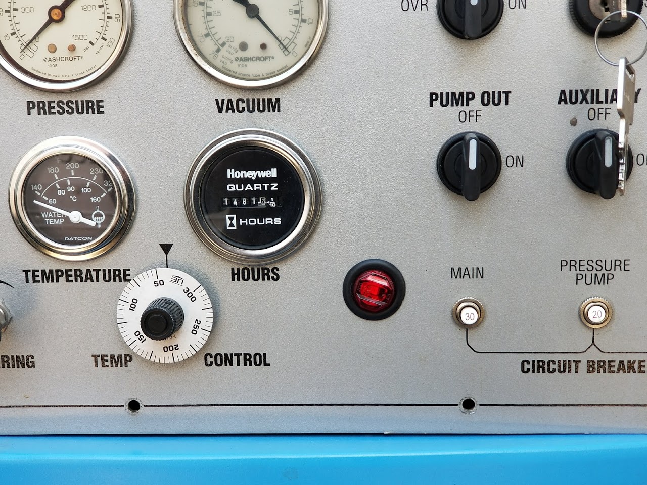

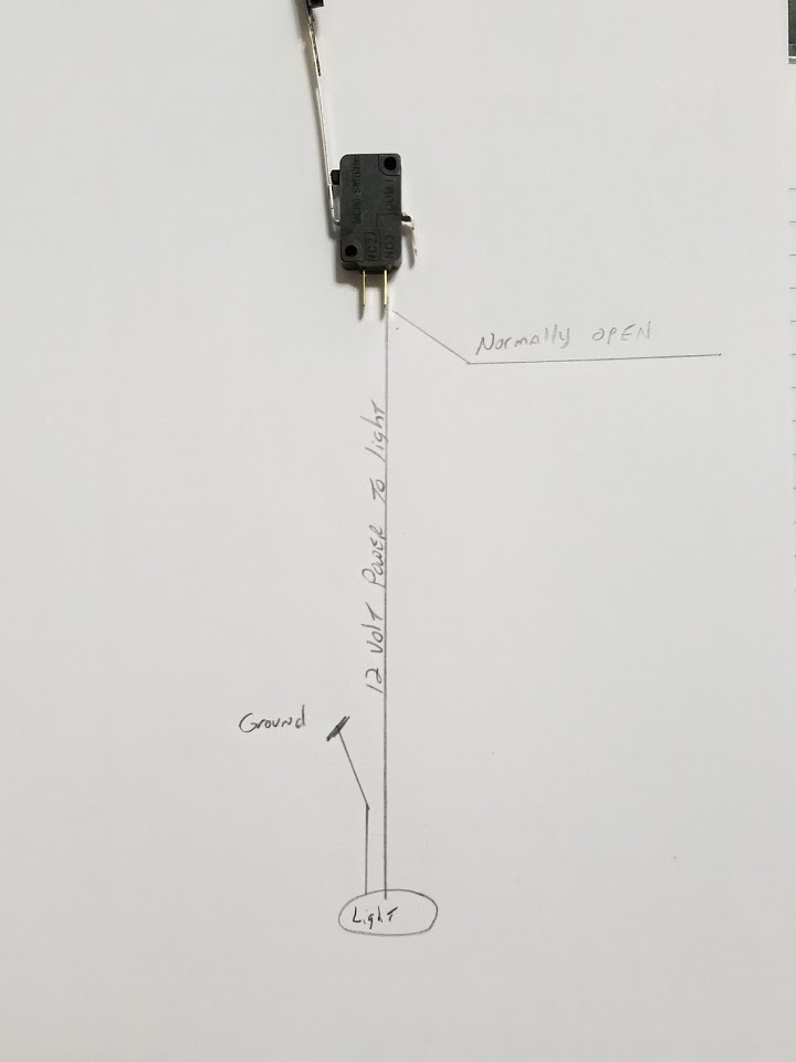

I added a light to mine...so if the tank gets full it will come on....with Jr out there using it ...it has saved me a few times....
here is how to wire one up....

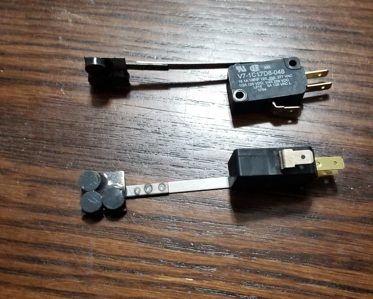

My Harwig float on my APO went out AGAIN!!!! The relay works fine when I pinch it but when i move the float up and down nothing happens. Its like the magnets just decided to stop working.

if you can push the microswitch by hand and it is working....then I would check and see if either you have something stuck in the pivot of the float and it is not coming up as high as it needs to....or..the float itself is filling with water...2 good places to look before replacing the switch.....

Well, no dice :( that dang float just gave up. Guess I'm ordering a new one.
