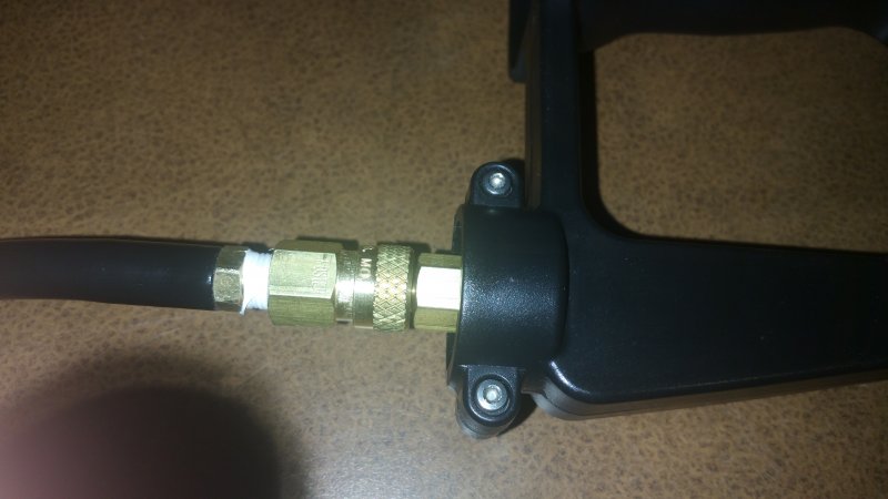

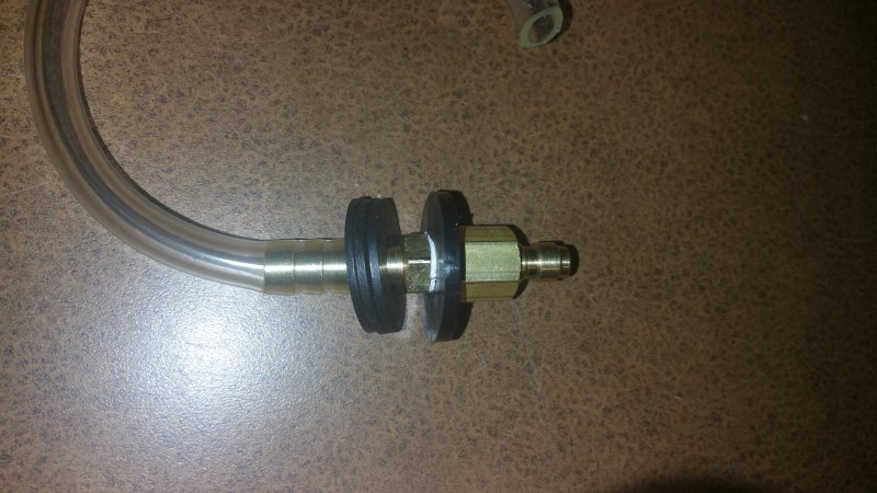

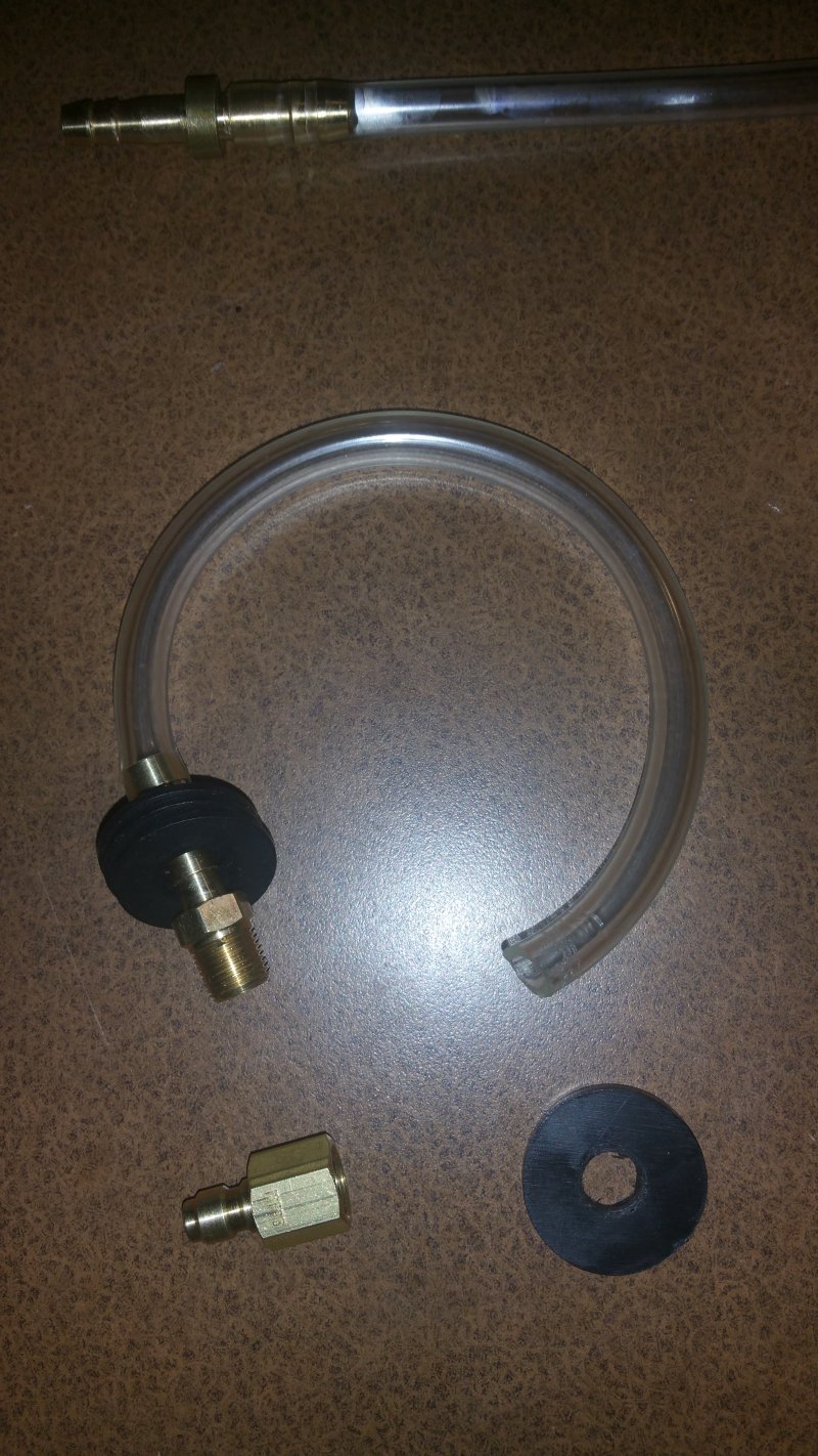

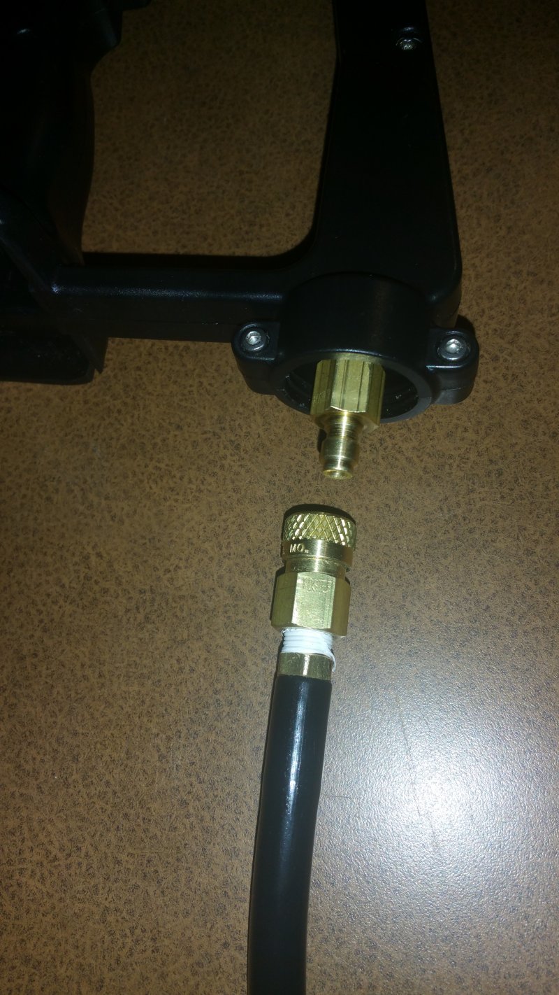

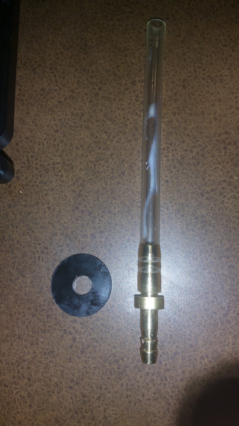

A no-brainer..................
Foster Male quick-disconnect adapter with female thread
Product ID : RL12FPB
Foster Female quick-disconnect adapter with female thread
Product ID : RL12FS
http://www.sportsmansguide.com/prod...t-x-1-4-hose-barbs-with-male-threads?a=514728
https://www.amazon.com/I-D-Neoprene-Washers-Thickness-Pack/dp/B00FSY1KZ2
Goomer
Cleaning Professional
Feb 9, 2009
3,398
Frank Mendo

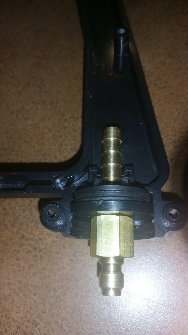

Looks like a worthwhile mod. Nice.
Any tool meant to be swapped for different applications has to have a QC.
Only difference is that the washers take up some of the handle thread space making it harder to screw any bottle directly into the handle, but since it can't be put down standing up safely without toppling over with anything connected directly to the handle, I consider the feature expendable, and better to just make a lead hose with a female QC to a small jug of choice with a handle for smaller gigs, and they can both be placed down just like a Hydroforce.

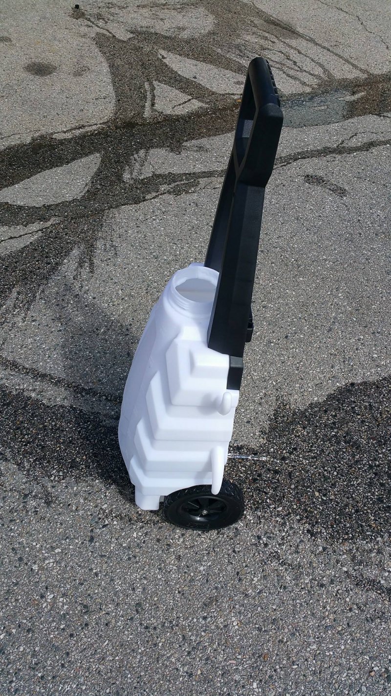

Let's make a mod to connect it to a Hydroforce bottle.
Goomer
Feb 9, 2009
3,398
Frank Mendo

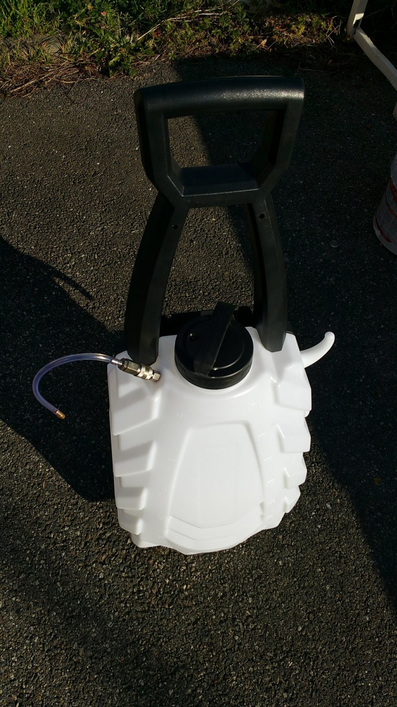

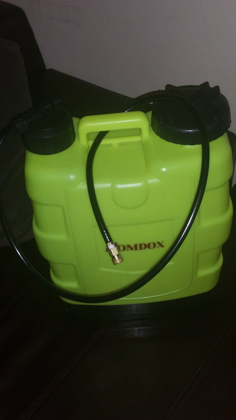

Just get one and remove the metering valve and internals and connect a hose to it with a IPS size QC on the end.....Similar to what I did with this 5 gal pump sprayer I got for 30 bucks off Amazon............gutted the pump components and plugged a hose to it.........Just need a smaller version.
I hven't yet found a bottle that screws securely to the IPS.
Goomer
Feb 9, 2009
3,398
Frank Mendo
Even if you did, what are you going to do with it when you need to put it down so it doesn't topple over?
Can't stand it up..........ain't laying it down......what's the point unless it's a very small job and you only need to spray once and can then put it away?
Maybe that's what the sling is for.

The idea of swapping chemicals is precisely why I bought it. But we'll use a three foot section and draw from bottles in a utility belt.
Reactions: Lee Stockwell
Har har.
On a given job we may use degreaser, enzymes, glass cleaner, tile cleaner, deodorizer and carpet cleaner. We may spray down a shower and let it stew while working on woodwork. Maybe pretreat a carpeted traffic area and work on a vinyl floor while it dwells, then spray down a sofa.
In short, I bought this to get rid of about five spray bottles.

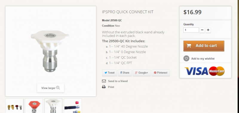

Being softer plastic threads I would think they might screw down a little tighter in time, especially if you keep swapping them, but either way, QC'ing the tips with pressure washing tips is the way to go..............
They only give you a zero and a 40 degree tip, but you can easily find full kits with 15 and 20 tips, which might offer better spray control on upholstery.

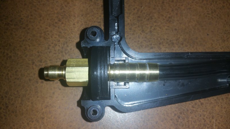

Here's what I think is the way to go to PIMP it out right.
Need to take off the wand and put a female QC right at the gun................
With that same female QC you can just connect a QC spray tip for close combat, where the finer degree spray tips would come in handy, or the stock wand with a male QC on the gun side and a female QC on the tip.
