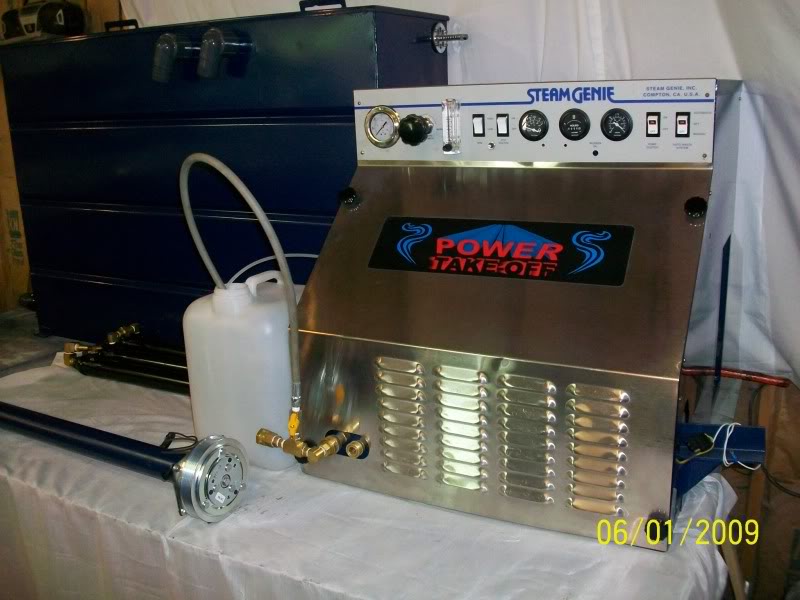

They put a severe restriction on the blower outlet hidden by a large vacuum tube that covers it, I guess to increase the heat the blower produces for the blower HX. The vacuum is thunderous and powerful and I can't see a Butler outperforming it, but if Rampage said it did, side by side, then it did. I also had an '86 Steam Genie PTO like Bob pictured in this thread (thanks Bob), that backed up my '87 WM for ten years, and the Pro 1200 was much more powerful and reliable than the Steam Genie PTO. There was no comparison.
