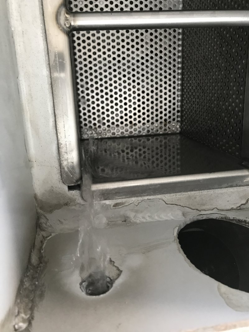

They dump it into the waste tank because not all setups have fresh water tanks. This dumping action is to protect the equipment and the manufacturer from the operator.
We all work at different speeds and efficiencies as well as different water flows.
The dumping will generally happen when cleaning upholstery or stairs because those tools have lower flow rates; and may also happen if you are off the wand trigger for 5 or more minutes while talking or moving furniture.
If you dont have fresh water tank to reroute the dumping water then you will need to increase your flow rate and or change your wand technique. Basically while cleaning only wet enough area to drain your heat exchanger- thereby filling it up with new unheated water- then do dry strokes.

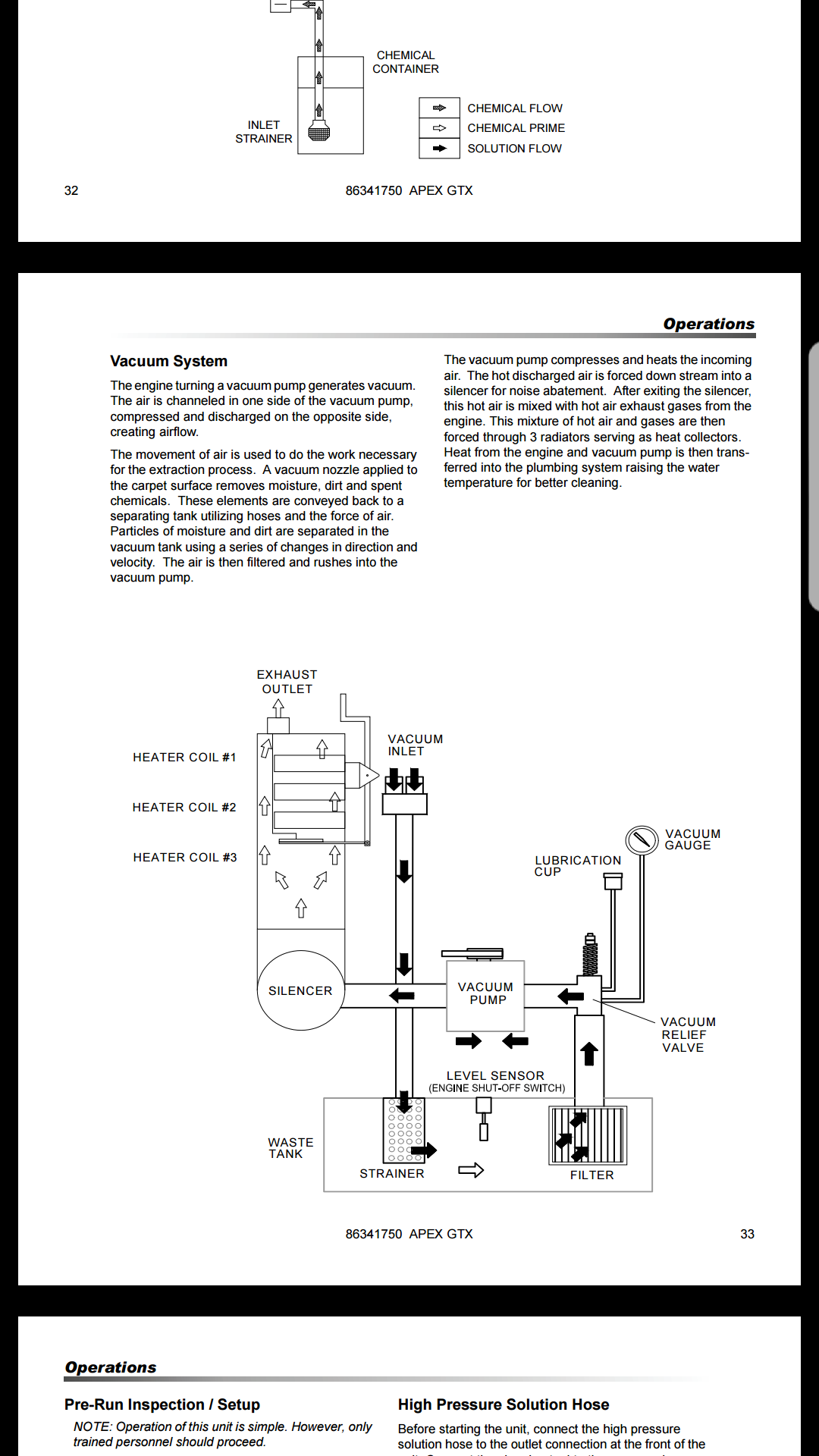

The pic above isnt telling me too much about diverting. My SS370 has a maual diverter to bypass the heating chamber - but I want it to bypass on its own as it reads selected temps rather than dump the water to bring the temp back down.
Able 1
Apr 12, 2008
6,469
Wi
Keith
The new Gtx diverts the exhaust, at least that's what it looks like to me.. I was looking into it because I noticed they changed the heat control lever position.. I saw it on @Dan Lofsten post, and wondered what they did.. Maybe he can fill us in..
