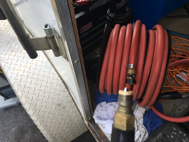

View attachment 73651 Im currently using cobbs rinse. I put about 3glugs in the jug and set it at 2-3.
Is something wrong? Will this hurt anything in my chem injector?
The deposits you are seeing are from water hardness or chemical residue being removed from your system.
Filters should be catching some of the residue. Descaling may be in order.
"3 glugs and 2-3 what units" & which TM ???
3glugs is under your recommended mixture. Thanks for your input
