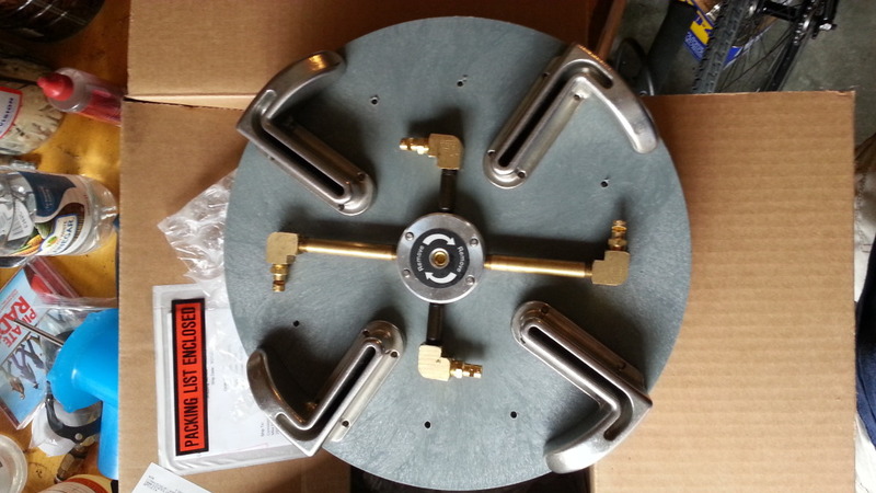

Curious what the proposed 'fix' to the streaking problem is?
The 360i 4 port unit is a great tool... Very light and does a killer job of digging out dirt . Especially on Berber and crap rental olefin.
Initially didn't like the idea of the unit only having 3 ports but when the 4 jet unit came out I jumped on it
I doubt they"ll design a 5 port head, but it would distribute the weight, spray and balance the unit even more

the spray bars is what sets this rotary apart from all the others.........it does not need height to disperse the water evenly.......it is a series of downward flow...so no matter how high the carpet is...it is impossible to obstruct them....you will still get the flow...add the water metering control valve to it...and it can take on anything out there....I would much rather have water control then motor control....it will put you way further ahead.......
I have cleaned that white carpet for years....they have me there 3 times a year....the RX did a good job but did not leave it as dry as the Hoss....the 360i choked its self....the Hoss glided right along with no problems and left it drier......
I like the 360i...it is a good little machine when you can use it....but anytime you see the out side of that shroud hit the carpet...its probably going to streak......
