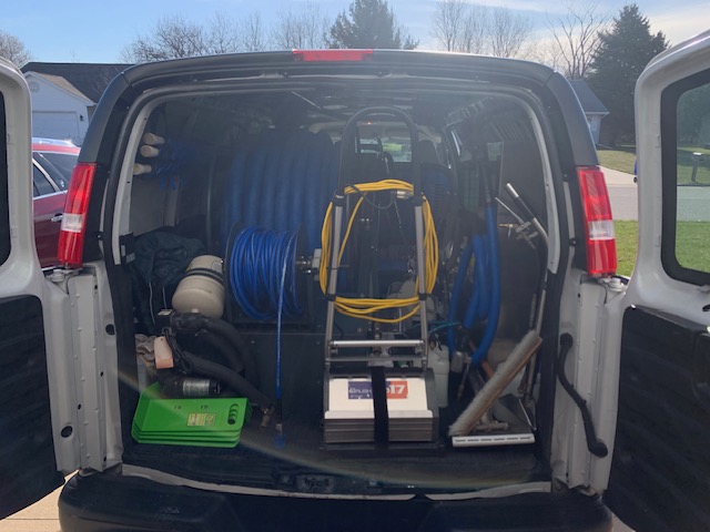

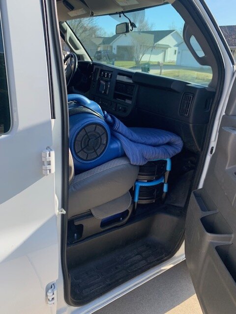

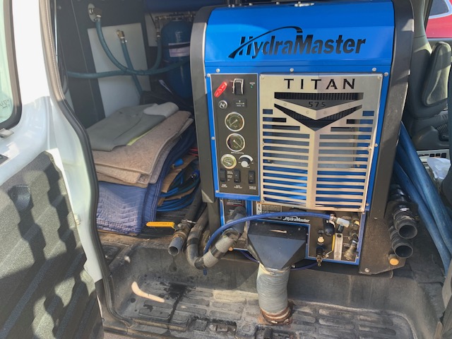

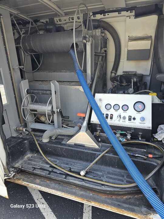

this was the van at my first job. Im down to 5 days a week now for the last 2 years.IMG_2942.jpgIMG_2944.jpgIMG_2943.jpg

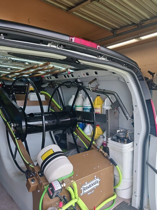

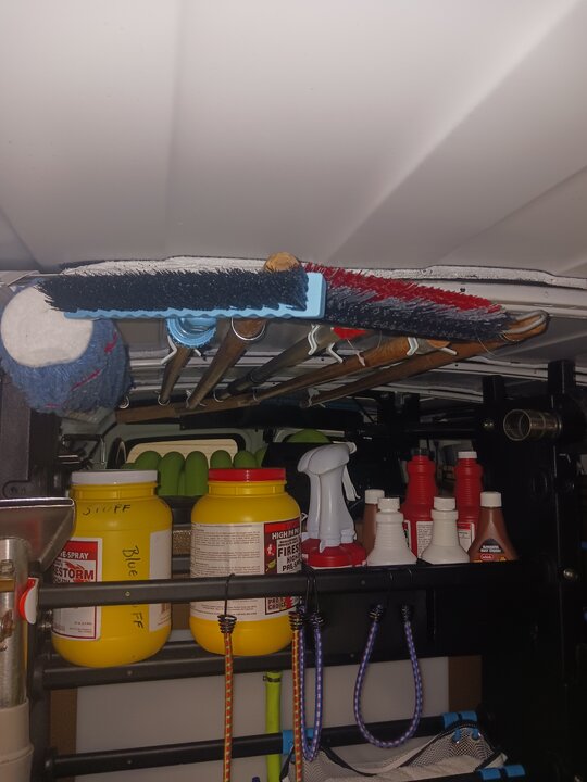

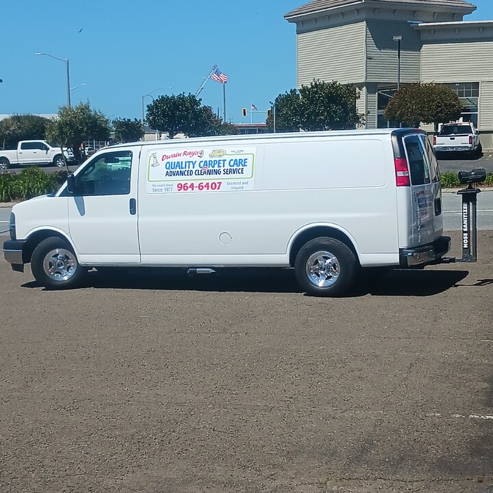

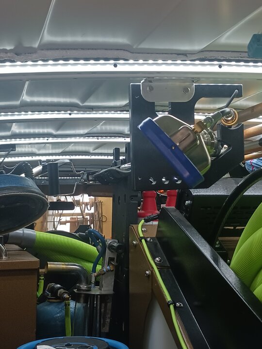

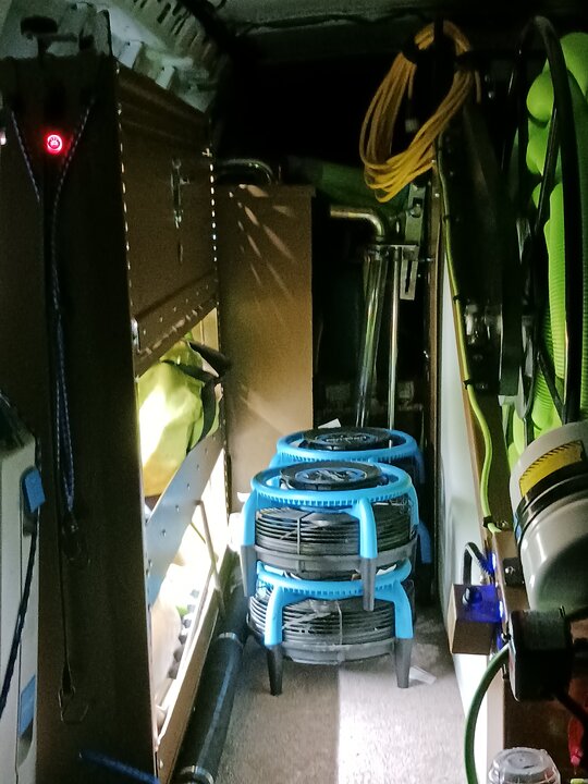

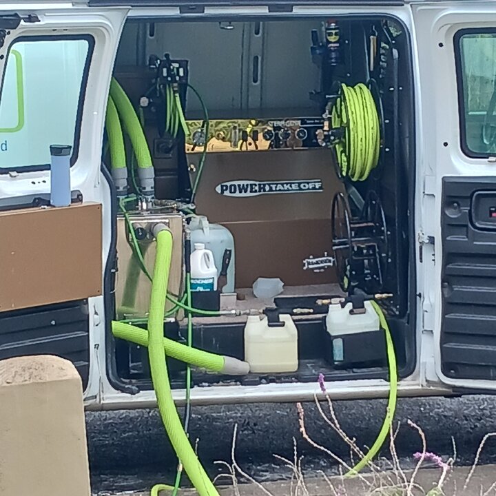

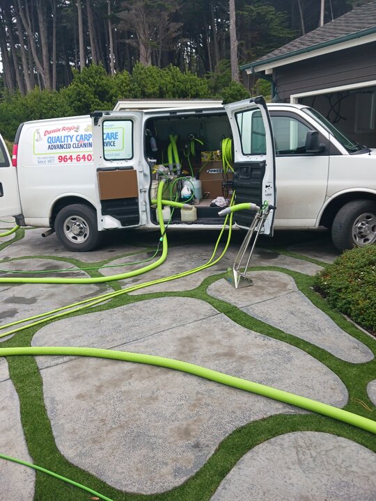

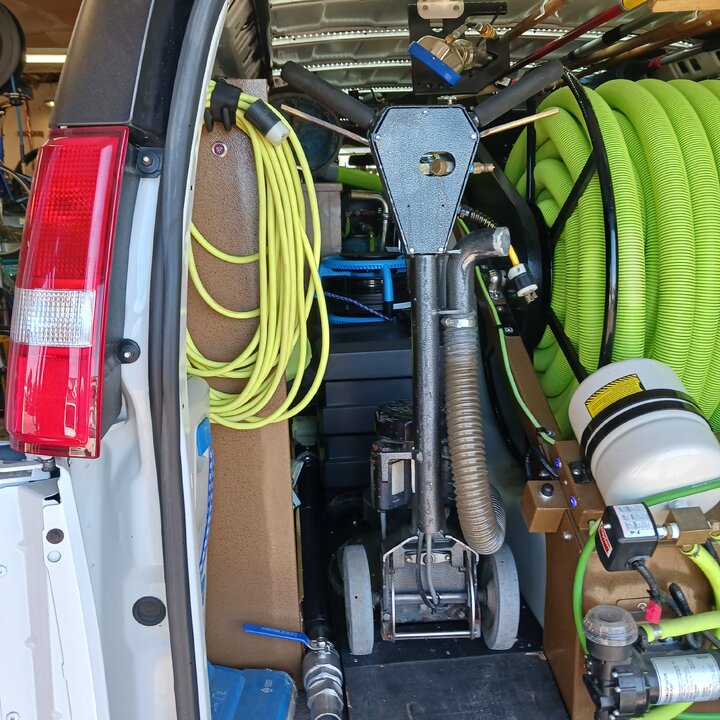

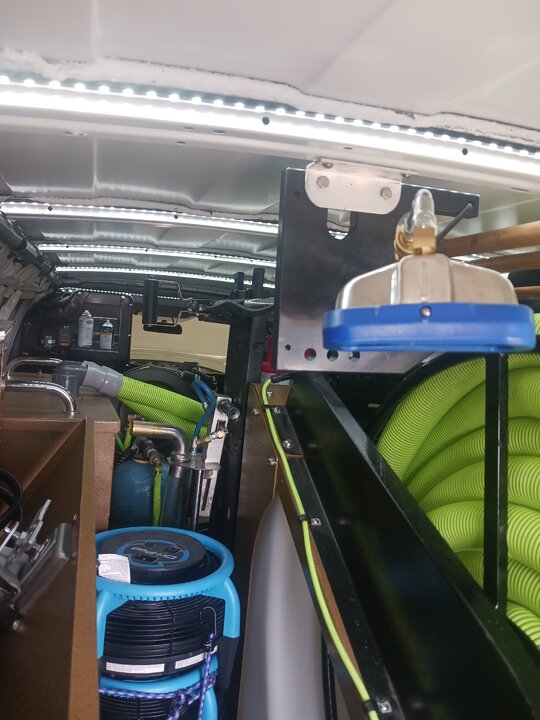

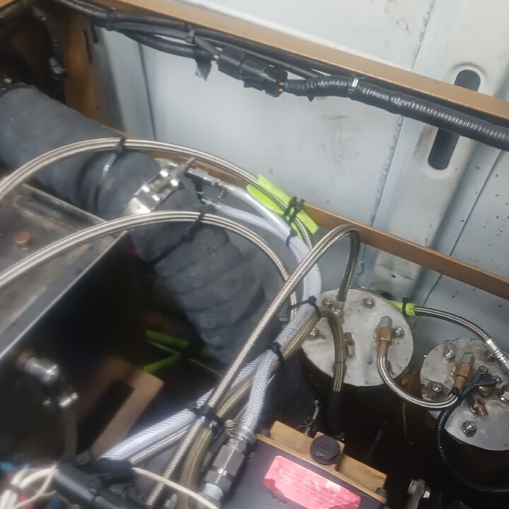

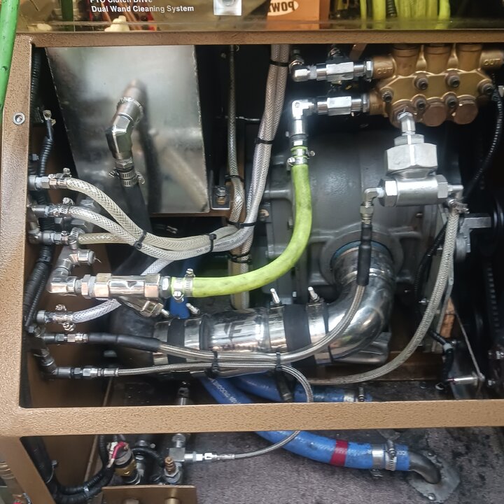

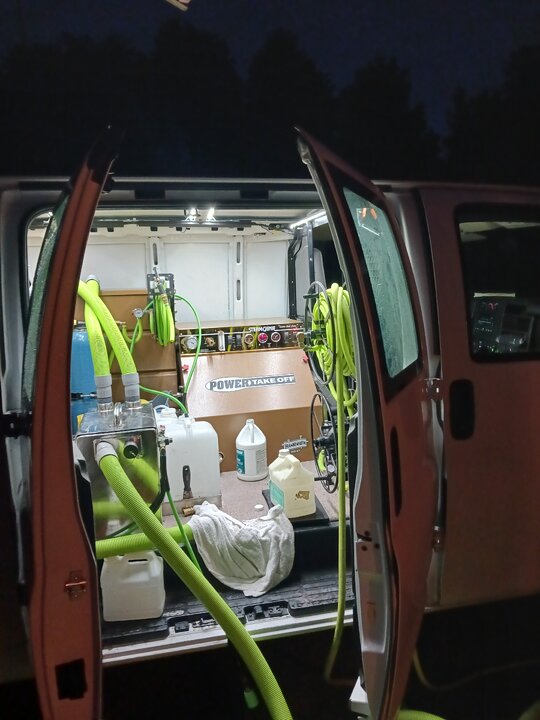

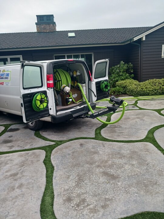

Wanta see "baby pictures? " This is my baby and main van Frankenstein its a 2020 checy extended 2500 with a custom designed and built steamgeni pto with modified cleanco driveshaft mount steamgeni driveshaft,frame, modified 50 gallon waste tank and stainless waterbox, all stainless fittings and stainless reinforced teflon hoses hypro pressure pump with general chemical pump cleanco new style heat exchangers hydramaster salsa afterburner roots 47blower comet p33t pumpout system. Custom shelfing 11strings of led lighting with 12vdc & 110ac power supply waterpond etc etc and yes this is how it looks all the time 1,200 on the clock and 53k on the van

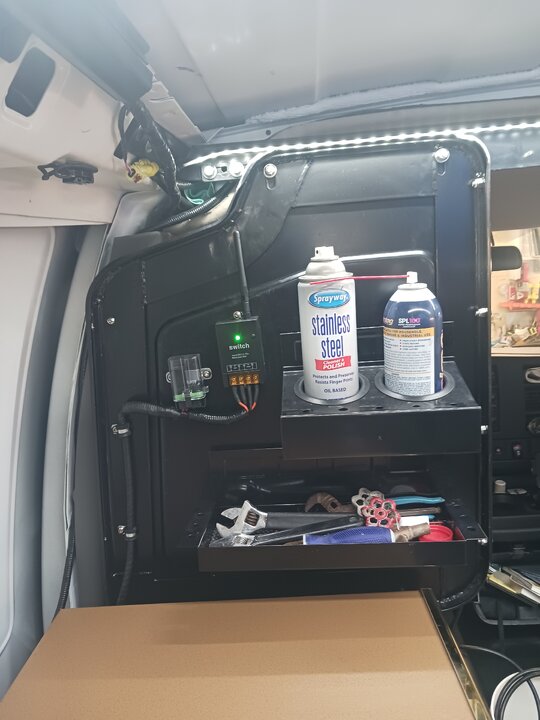

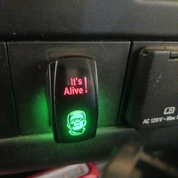

Why do you have a lighted picture of Mikey on your dash?

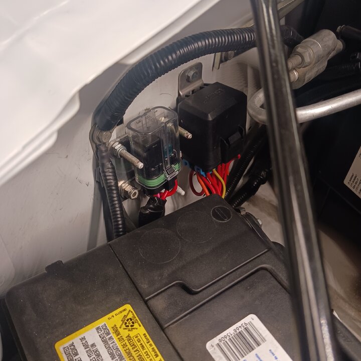

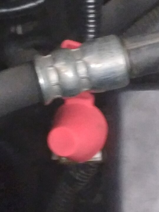

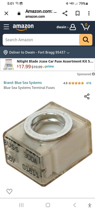

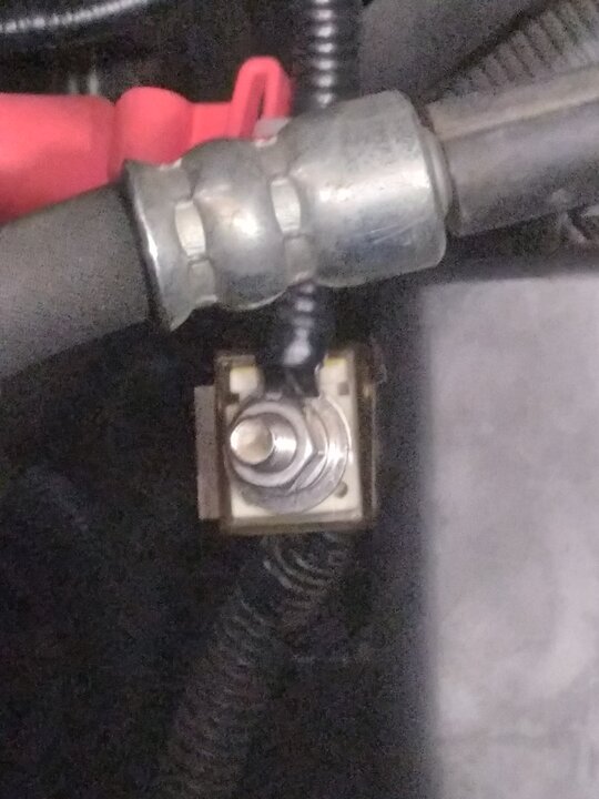

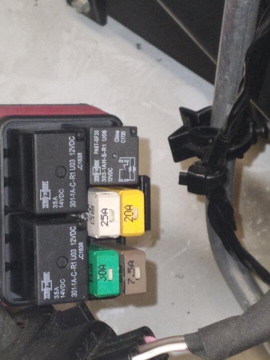

That switch is the master switch to my entire truckmounted systems. It energizes the relays that power the entire back of the van 3 relays and circuit breakers controls everything 1 relay for waste pumpout,1 relay for waterpond& shelf lighting, and 1 for the pto itself. This little box is my entire electrical system for all my equipment in 1 place instead of fuses i have circuit breakers with manual resets 30a circuit breaker for wastepump 25a for waterpond 20a formachine and 7.5a for frankinstien switch,throttle controller and safestop ( allows van to run with key removed from ignition) where the main power taps off the van theres a 100amp master fuse to protect the entire system
