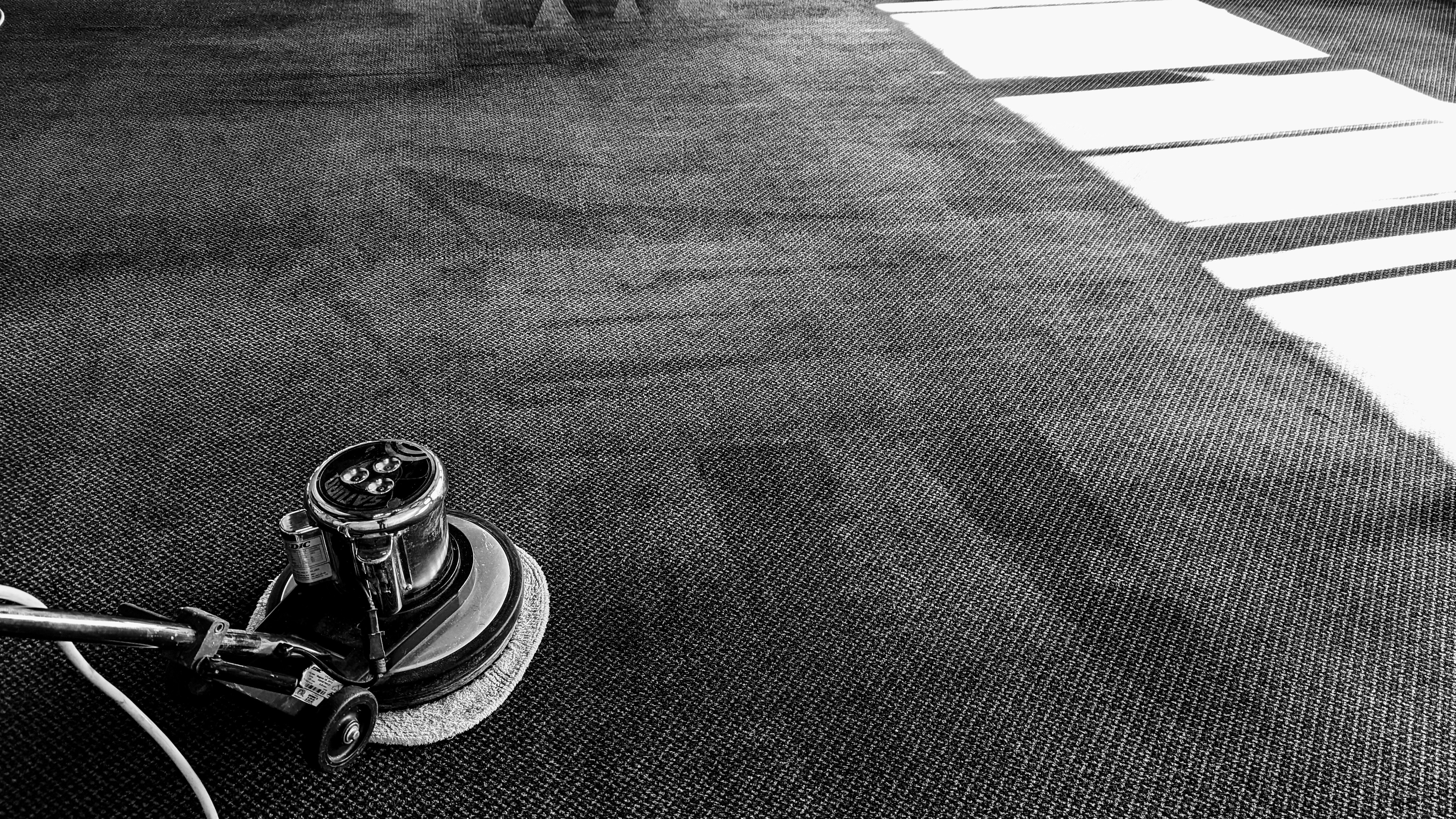

I do it once a month on some elevators. Hwe every quarter. Its commercial carpet so it does a good job on them. Looks better than the HWE but we all know it's not cleaner.
116,849
The idea of post padding was lame, but it led me into pre scrubbing back in the days just before rotary extraction. It made a huge difference in commercial cleaning.
Post padding resi pile is lame but funked up olefin GD, it has some benefits...
definite extra soil removal, friction drying of sorts, leaving an encapymer behind to act as an anti wick/protector, until the check clears...

I'm a big fan of post padding, but rarely have time to do it.
I've been toying with the idea of putting down my prespray with my O.P. and scrubbing with a red pad as I apply it on the carpets that need a little extra love.
Use a pile lifter to agitate your pre-spray, then HWE - hot!
I have. (Certified w/light brown veggie brush) and vac port hooked to TM
it's better than any CRB due to heavier wt, but a rotary with VCT pad kick'd it azz for shearing soil
post bonnet was a red board de jour thing.
I tried telling them the scrub comes BEFORE the rinse.
Butt you know how de jour pack followers are.
They parrot the de jour party line whether they have a clue or not
I s'pose it may have helped the 50%'ers (hacks that don't know they're hacks) with wicking due to crappy wand technique.
But pretty much worthless waste of time otherwise*
*only time we found any value was when the subfloor was so uneven and lumpy good wand slot contact was difficult/impossible to not leave puddles in the dips.
Then we'd post bonnet

On trashed carpets, shower feed your precondition through a Cimex for superior agitation then rinse with a Zipper Spinner.
Hard to equal the results and if a two man crew its actually not any slower.
You will use more precondition but if its trashed it needed it.
I tried that, once at Pegs greasy Spoon, where I have tried EVERY thing at least once.
Zipper still needed trimming and didn't dry as well as my 12"wands
It was a bigger deal in the early days of the olefin era when most of us didn't yet understand yet what it was.
It was an IICRC test question, so we IICRC instructors (past tense in my case) had to cover the method. That probably gave it more credibility that it really deserved.
Cleaning them right the first time was the better answer.
