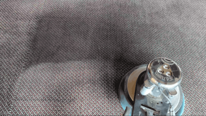

Its been eons since Ive post padded with a 175..
is he going to extract that or leave it filthy?
I hope he's a 30%'er (hack and knows it)
cause that carpet is still scummy AF
EDIT..I see he extracted it :very_drunk:

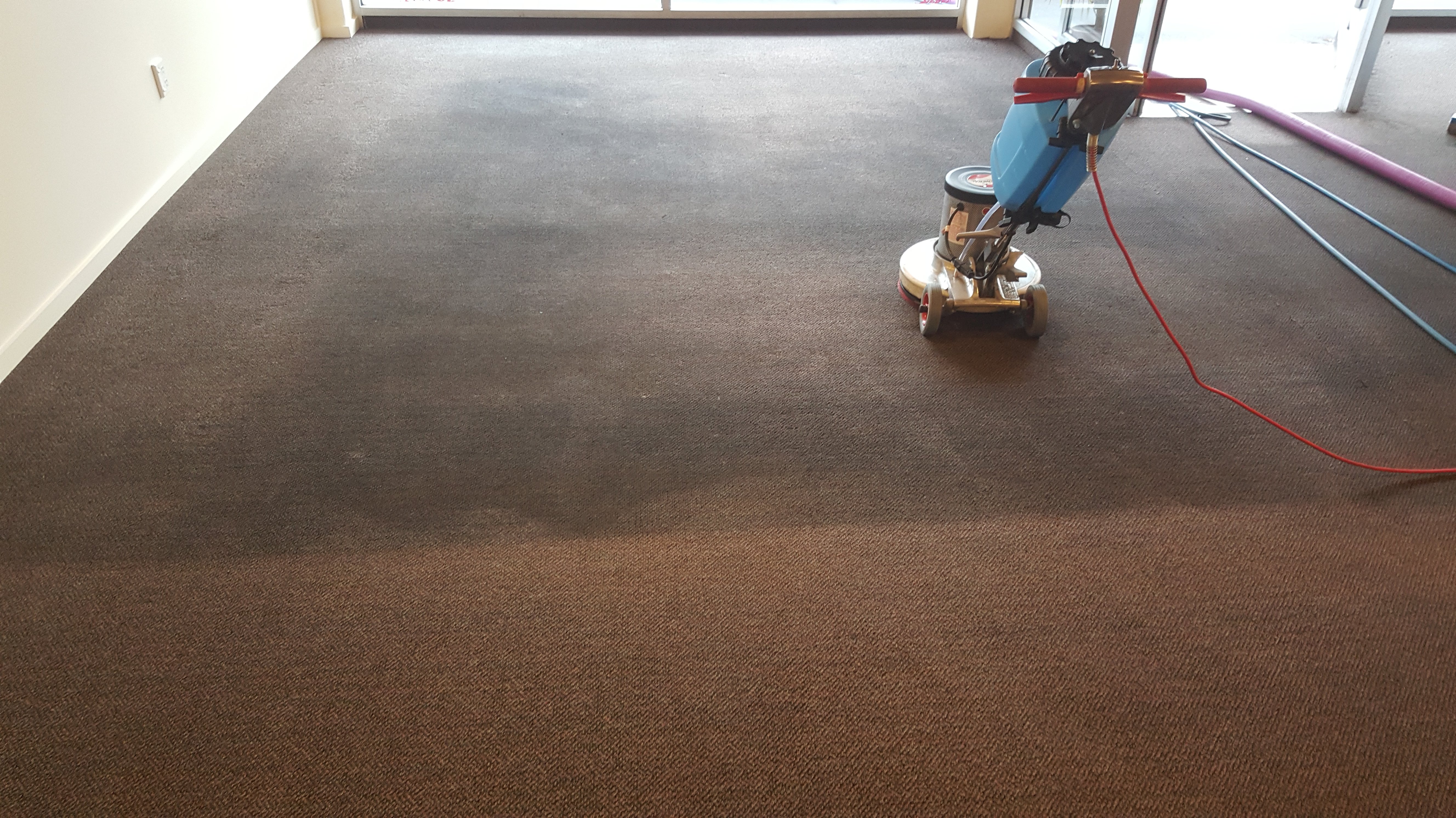

I'm a big fan of post padding, but rarely have time to do it.
I've been toying with the idea of putting down my prespray with my O.P. and scrubbing with a red pad as I apply it on the carpets that need a little extra love.
though I love a red pad scrubbing, I dont think an op would put down enough juice before extracting?

OP is just the wrong tool for the job. Heavily soiled needs a tool designed to use more product. OP is a VLM method, VERY LOW MOISTURE.
It's also scrubber.. you can use it for pretty much anything involving floors, not just vlm

Geezzz...I’m not a member of the elitist club here....but my 175 is perfect post, moisture picker upper and wick back ass kicker either commercial and residential. Don’t use it all the time...every now and then. Great for BLM I mean VLM. Another tool in the tool box great to have when needed. Them 175 army tanks run for ever.
could you use it to prescrub? Yes, but the tanks are too small to put prespray down imo, and people complain about weight of a 175 but OP is heavier again
