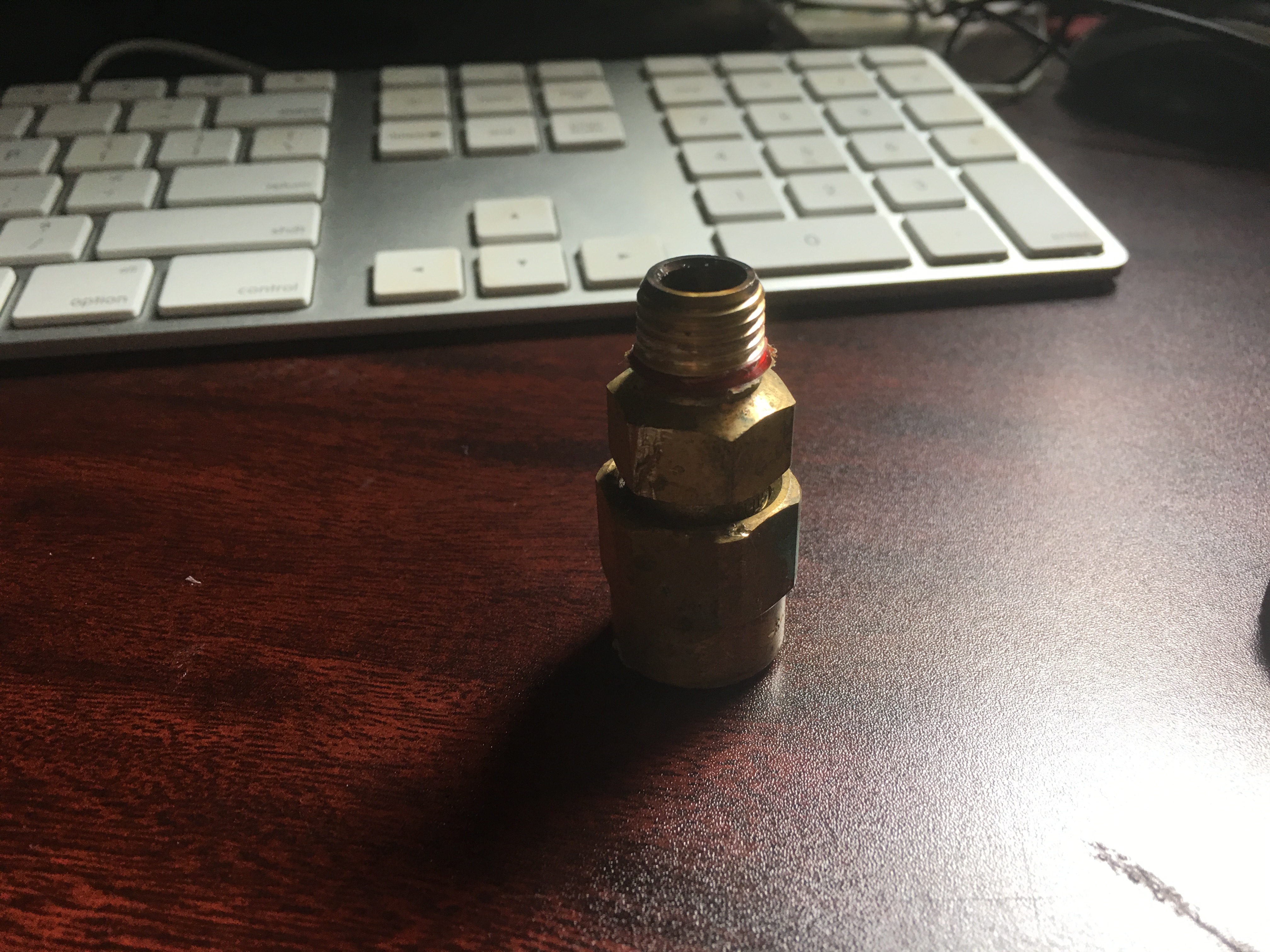

@scottw and whoever makes the one with the coin shaped dial. I'm tired of having to fix the o-rings on the dial, and the HF is always getting out of wack with the spring getting wore out inside. These $200+ sprayers are junk! Even the cheapo ones that are preset at 9:1 are always going bad also. And who put the RED thread lock on the QC on the one with the dial? freaking idiots! Just use thread tape so we can take these things off when needed. I have about ten of these in my shed that I'm using for parts when the new ones break down. Yes, I'm rinsing them out and I'm not using them when my water is scalding hot. Try another excuse

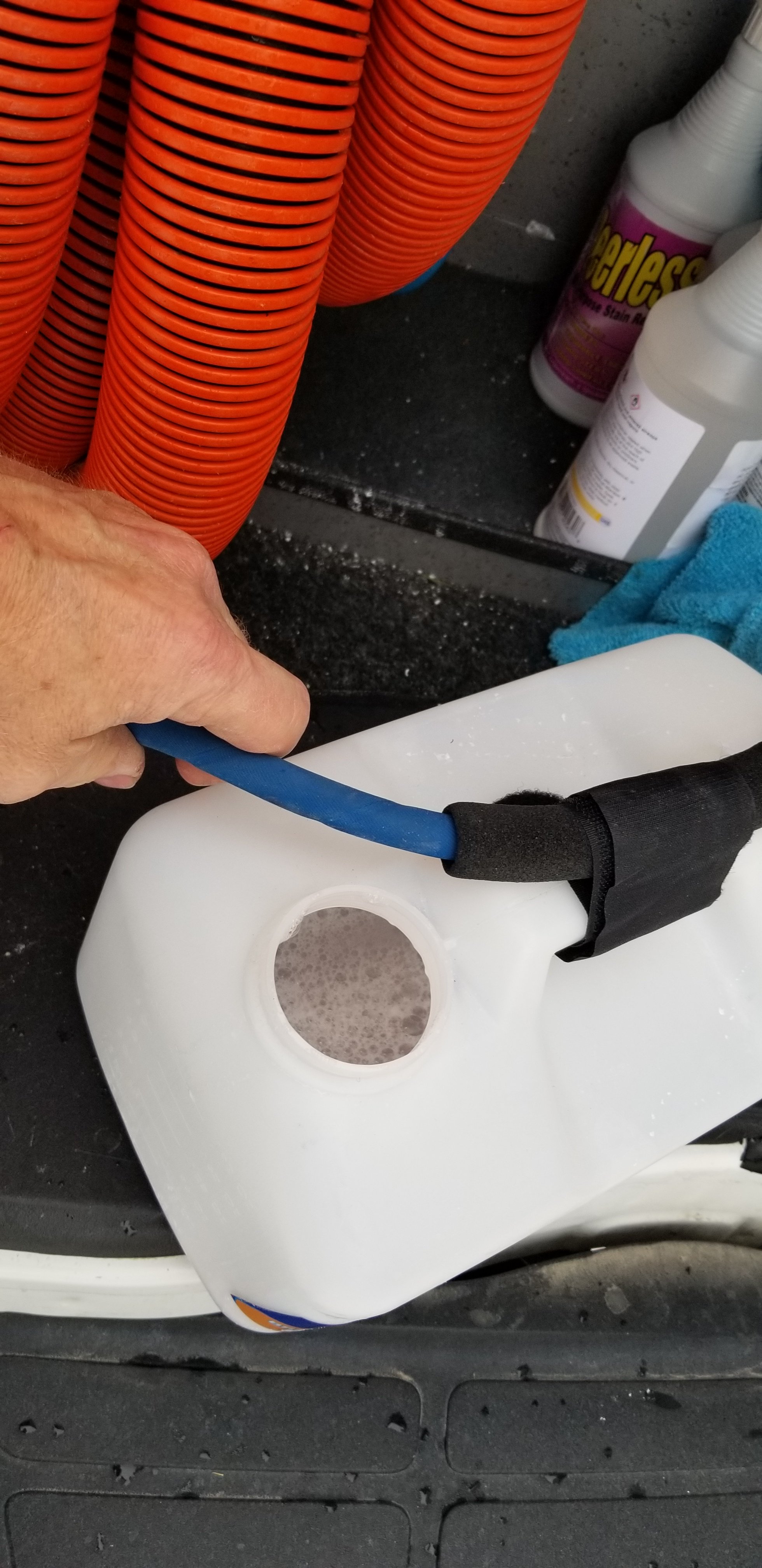

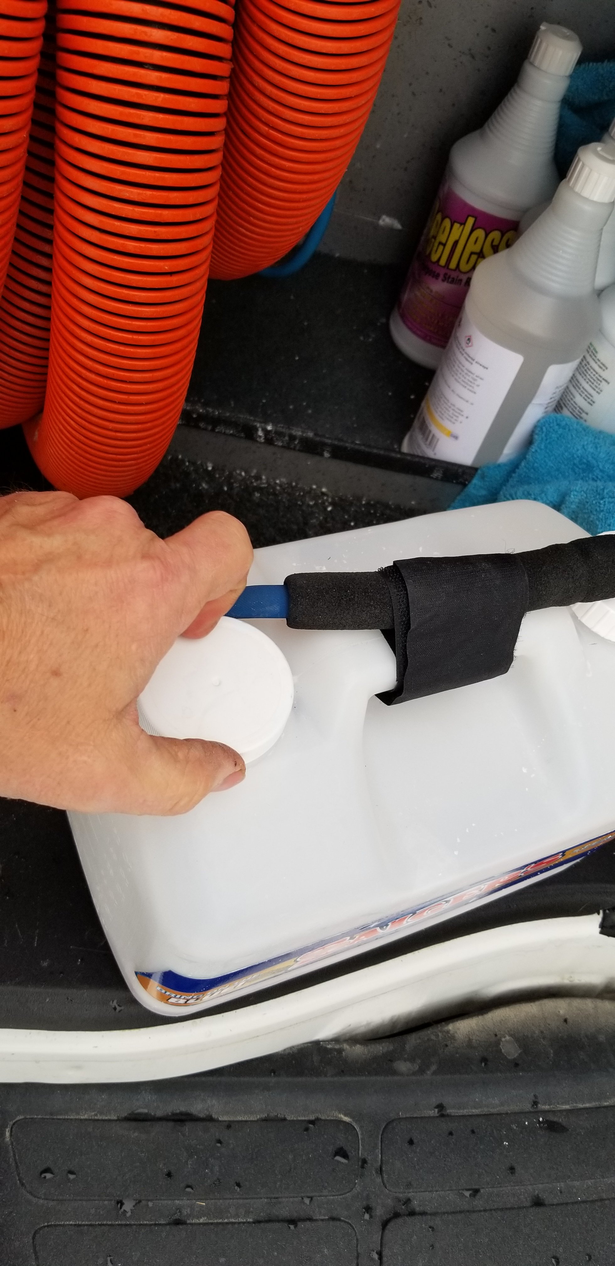

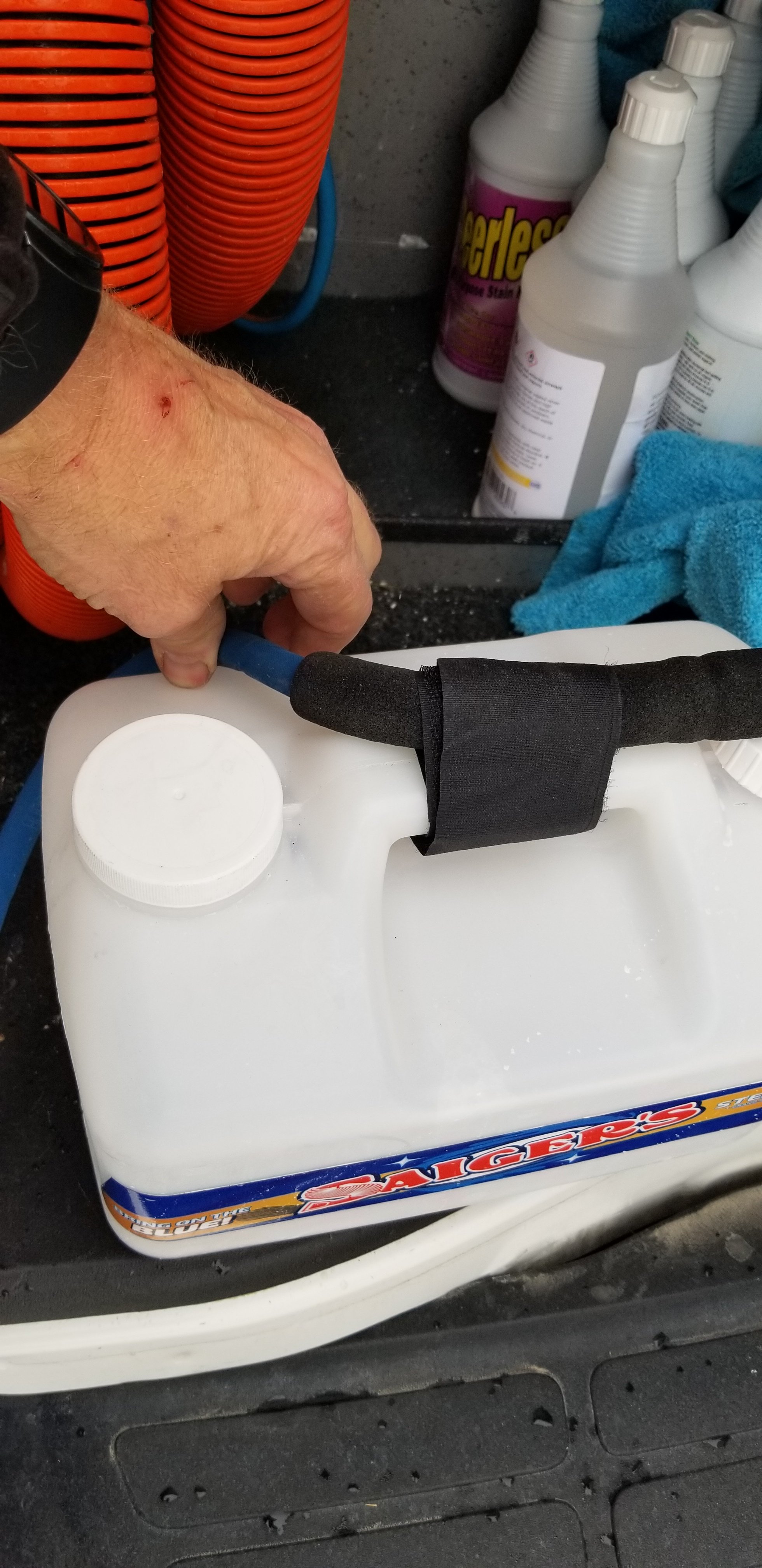

Take Jimmy's advice, carry a small pail with a mark at the 1 gallon line, a mixing stick and a funnel. Mix your powder in the pail and pour into the hydro-force.

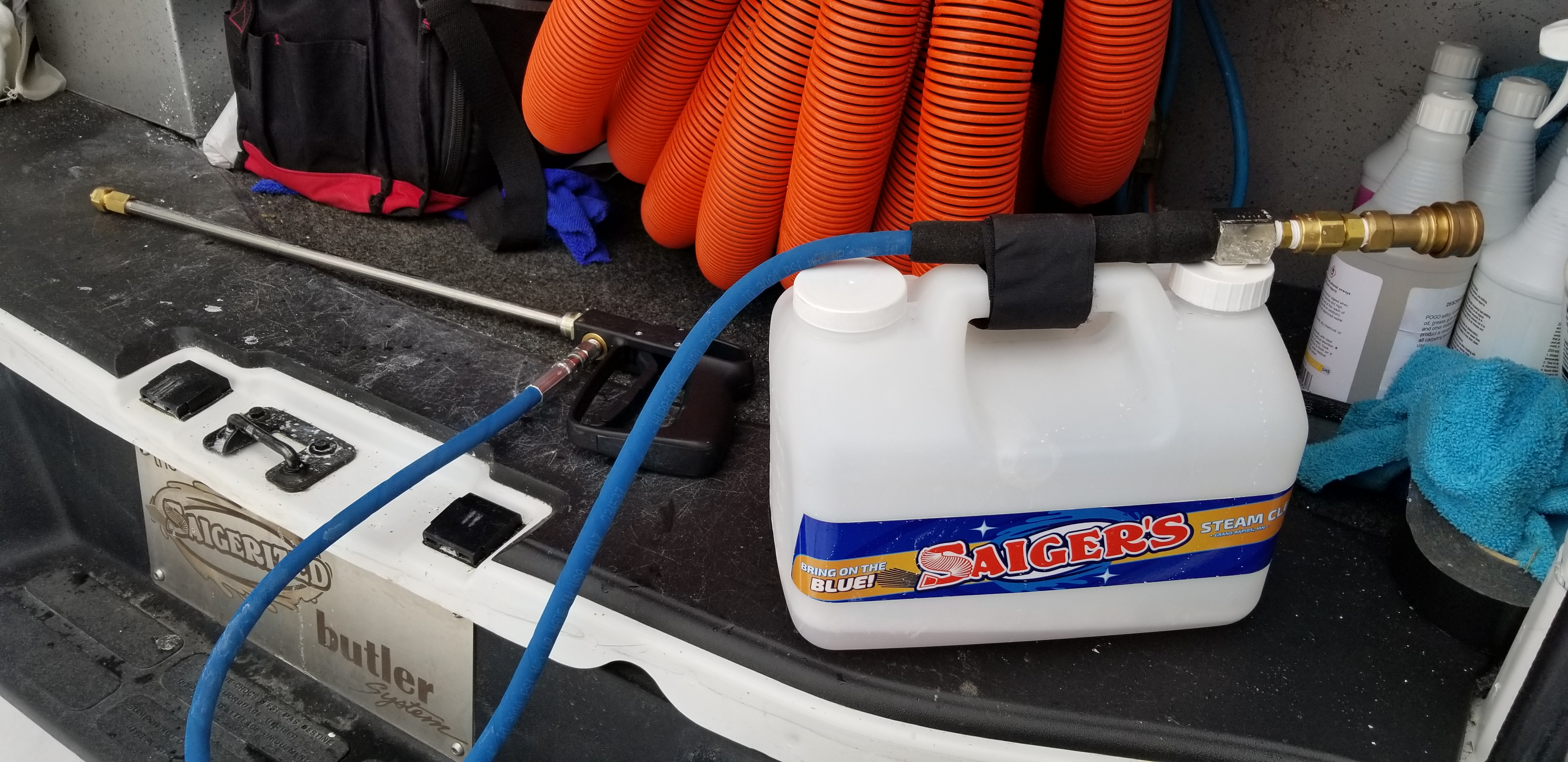

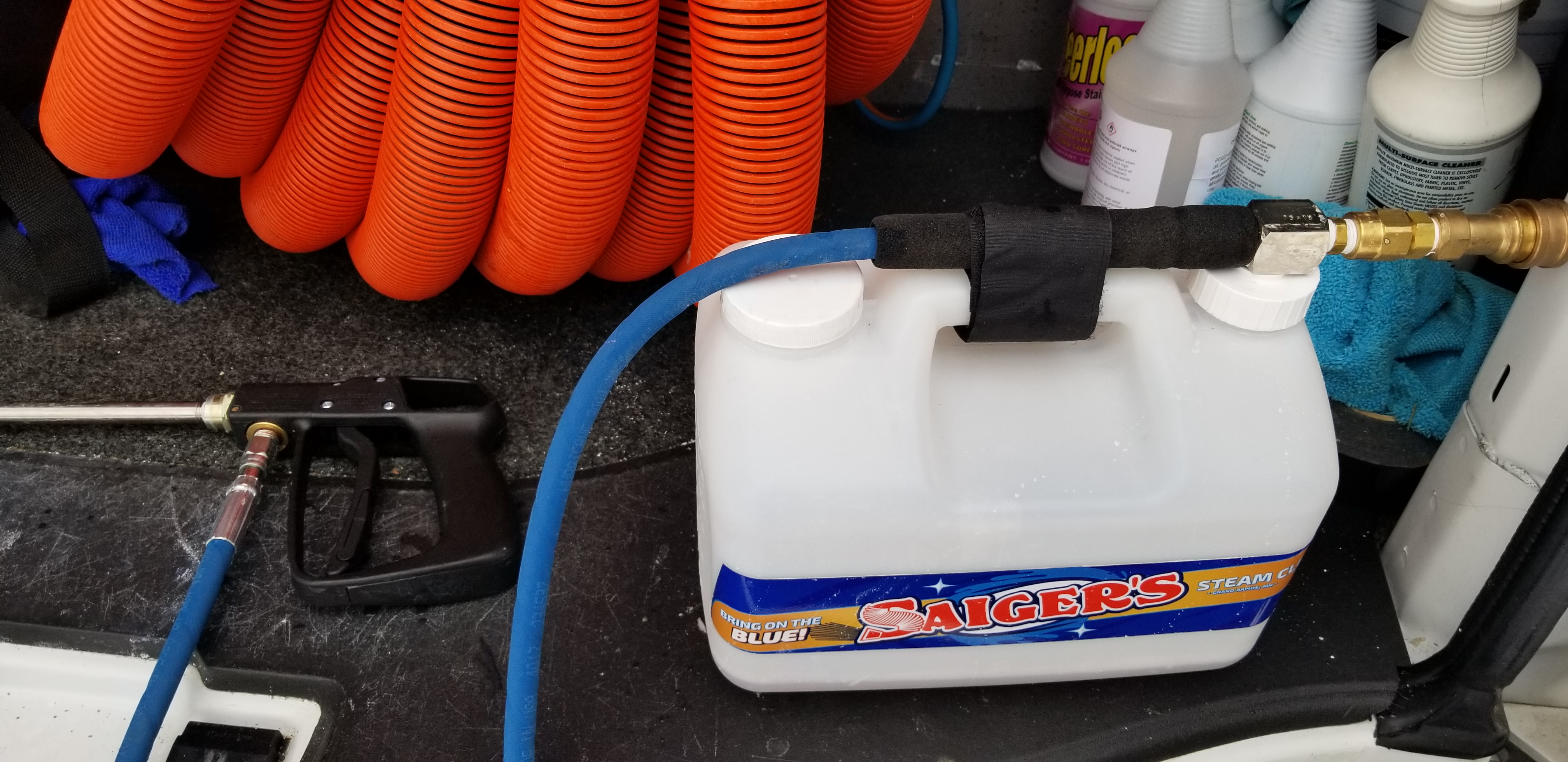

20181108_131949.jpg 20181108_131942.jpg 20181108_131938.jpg 20181108_131926.jpg 20181108_132009.jpg

Looks like it's exactly the same dema valve as the hydro-force. I leave the yellow tip in for my liquids but remove it for my powders. I adjust the dilution ratio accordingly.
