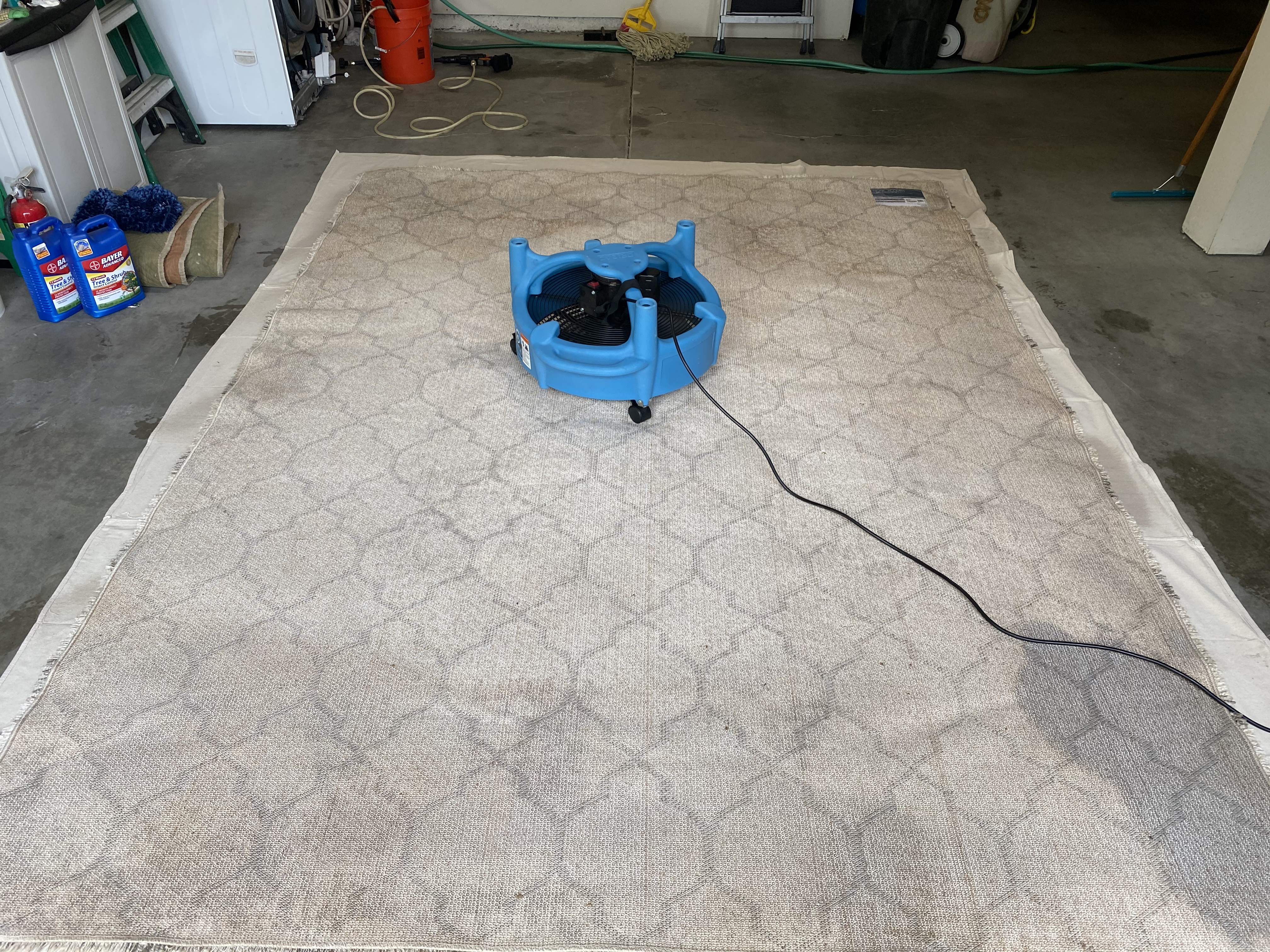

Well. I acid rinsed my rug again using more Prochem All Fiber rinse at 6oz per gallon. Laid it upside down on a canvas tarp and put fans on it. Hopefully in the morning the browning will be gone.
The Great Oz
5,295
bryan
Well, I took the rug down and it still looks like shit. Really browned out. I used Prochem All Fiber rinse to rinse it but all the browning came back. I think today i'll soak it in white vinegar 50/50 mix and rinse it with that.
I'm charging $1.50 per sq foot for this only because its a crappy poly rug with lots of wear.
Being polyester, it can't get cellulosic browning, so you're wasting effort with acids. Soil and oil wicking are what you're dealing with, so a high alkaline/grease eater like a restaurant prespray would work better to loosen those brown stains.
Then you have to do a good job rinsing and getting it dry. For that rug, flat with an Airpath might work well.
Good luck!

...and a rotary extractor will help you achieve this! (If you're charging $1.50 psf, you should have a rotary extractor--you could have a 10 y.o. clean it and it will come out much better.)
Not really trying to sell you my RX. I just want to see you succeed.

The acids worked. All gone
