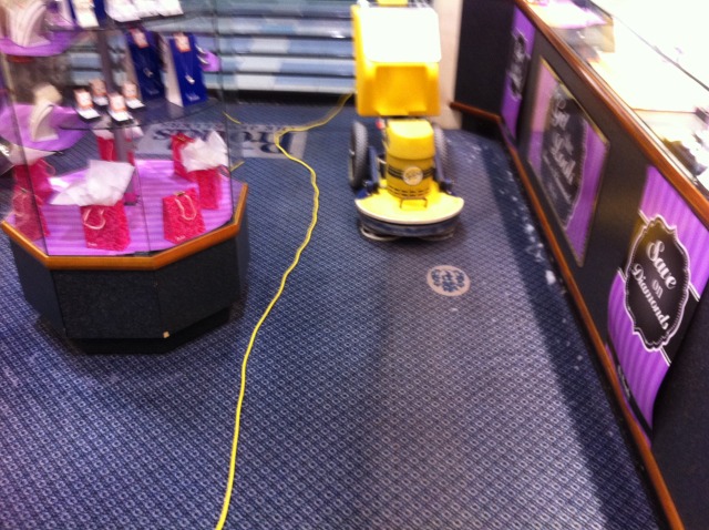

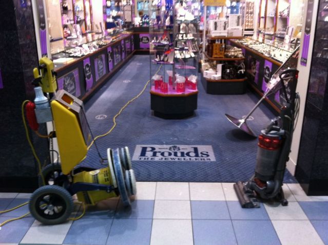

too small for the Cimex and my CBM is broken, so I brought out the pads and 175. I used one of Ricks products. The one with the green label ... Punch ... I think. I was pleasantly surprised at how well it cleaned.

Helped someone do the same thing. Was hard to convince him that he didn't need to drag 300 feet of hose in a mall. Vacuumed, sprayed and bonnet cleaned it real quick.

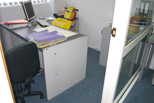

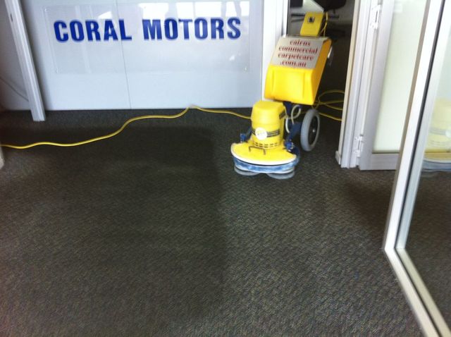

I really know where you're coming from on this Marty.
Those tight areas in joolrey stores can be a real PITA.
I do some, customer service areas, behind the counter & office sections.
Some of my other jobs get a bit dirtier than the crown jools.
