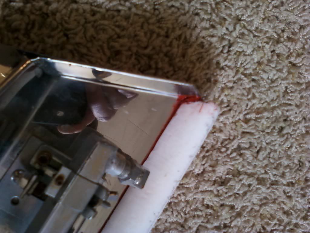

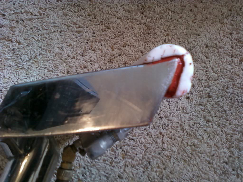

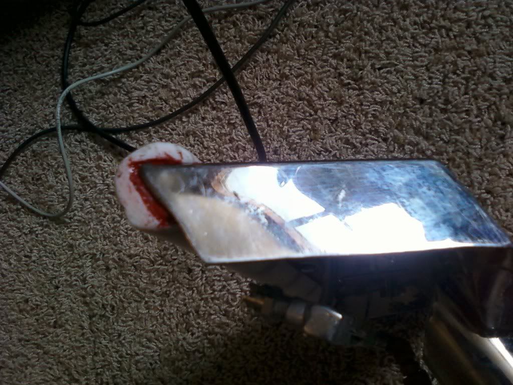

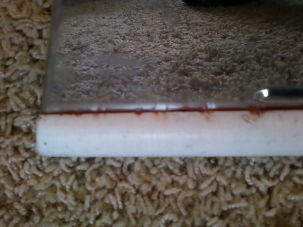

Did the glide that is sent with the wand FIT the wand "as it should". Did it fit tightly with no air leaks? OR, was the glide adhered to the wand with some type of silicone (or goop) that covered up gaps on the ends of the wand/glide???
And if that silicone/Goop isn't there, would the wand be sucking air and cause you to lose optimal vacuum at the wand/carpet interface?

Bought it directly from Joe.
It's not a bad wand. It's very lightweight and cleans decent so I kept it.
I just wish the glide would fit like it is suppose to.
You can use silicone (or something similar) to seal it up, but it just seems "jerry rigged" when done that way.
I spent a couple hours last night cleaning it up and used some High-Temp Red RTV Silicone Gasket Maker to seal it up. I purposely used red because I figured someone on here might want to see what I'm talking about.
If I can figure out how to post pics, I'll show you what I mean.
Again, it's not a bad wand. I just really have a problem with this one issue.

I have a greenglide and one of Joes I won. I have used both and cant tell any difference. Both fit the same on my TI wand.
