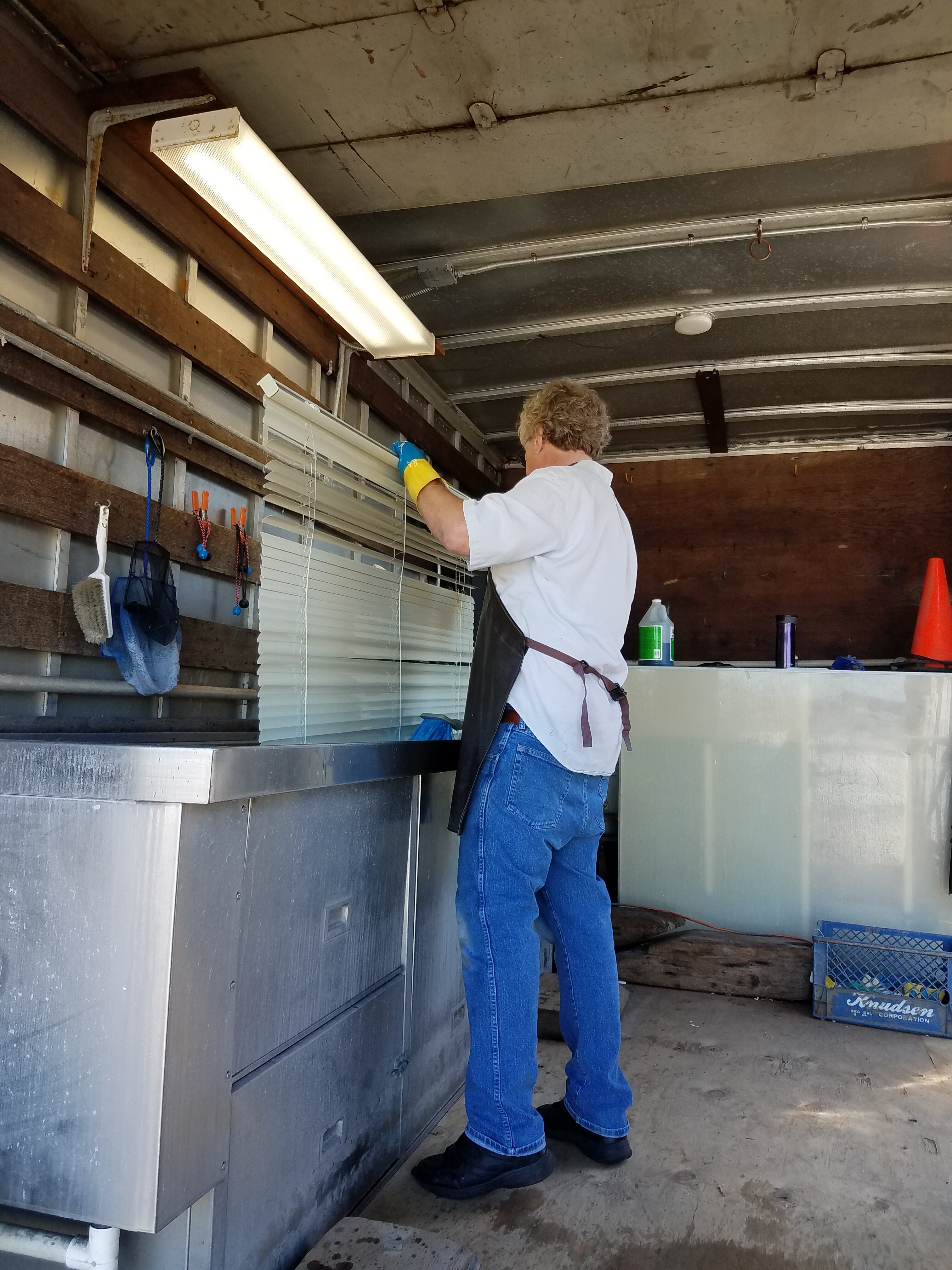

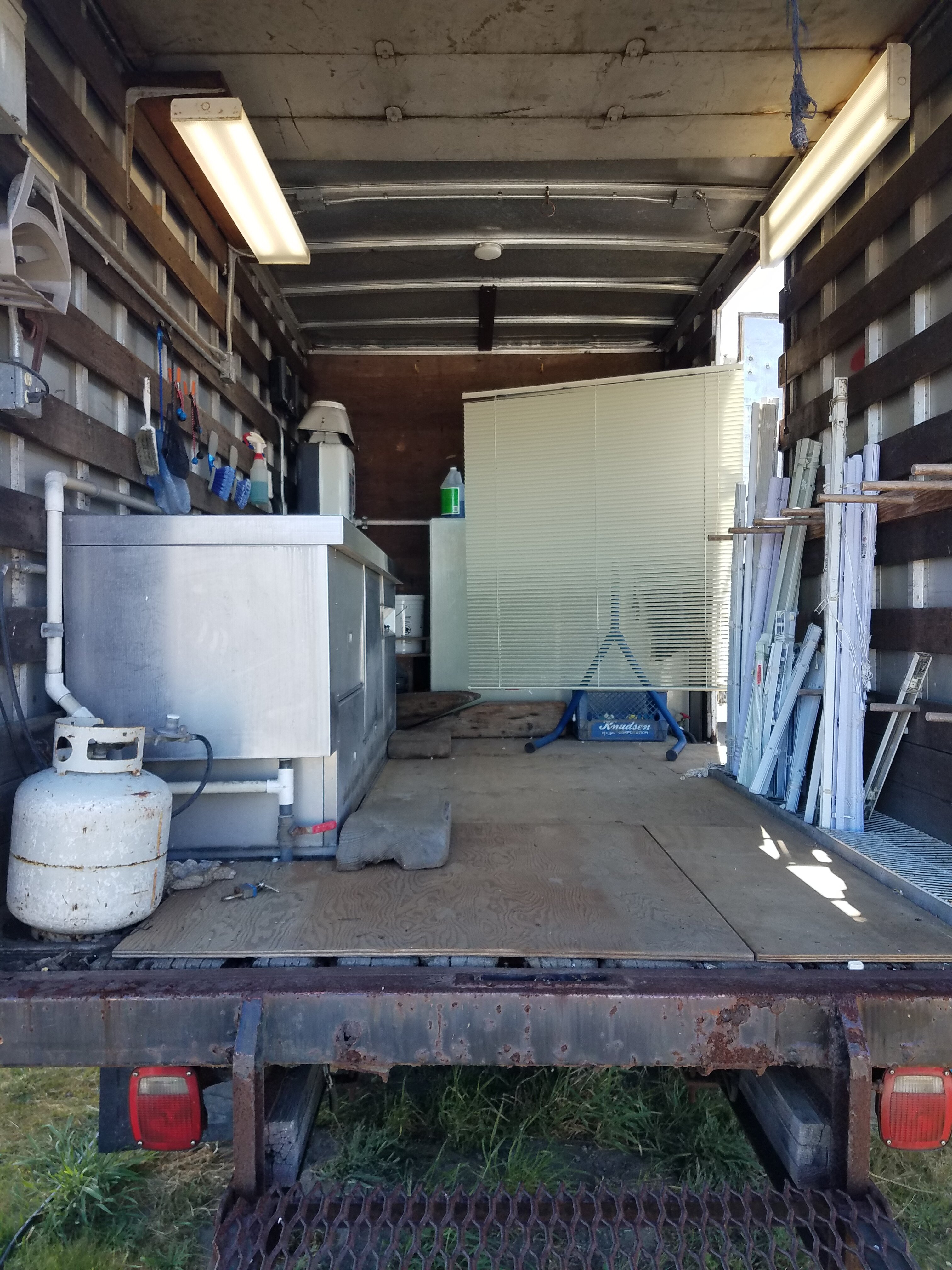

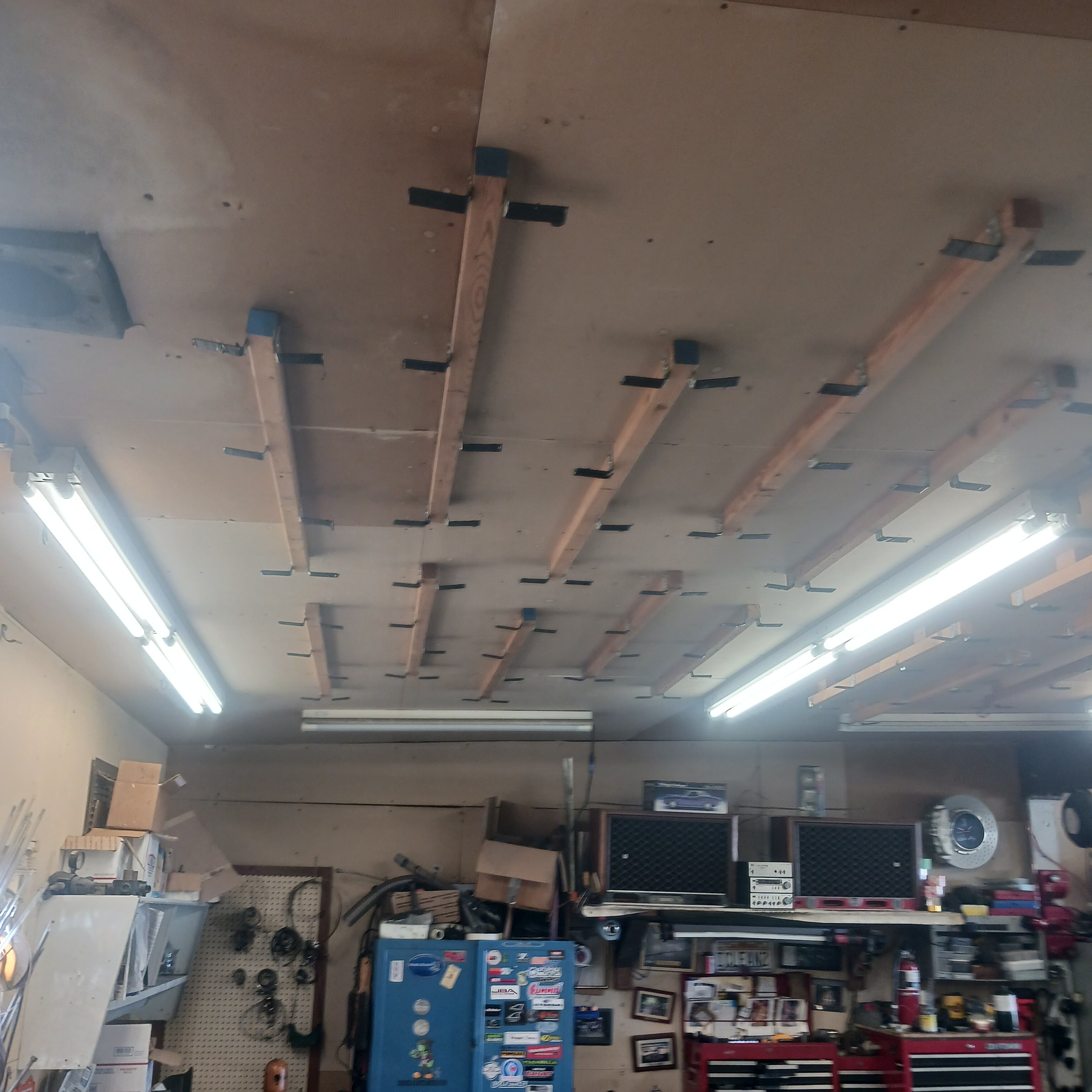

I used to do them on site but it got too expensive to maintain, insure, and license the 14' box truck to be mobile. For the past 10 or so years i do them at my shop. I try to have 15-25 of them to do before i setup the machine. I go around in the morning and pull um and bring um back to my shop where there cleaned, hung to dry then i re hang them in the evening
20180512_102055.jpg 20180512_101409.jpg 20180512_100518.jpg 20260311_102817.jpg
GJR
Jan 8, 2026
42
Gregory Rubin
Role
Cleaning Professional
Years of Experience
15

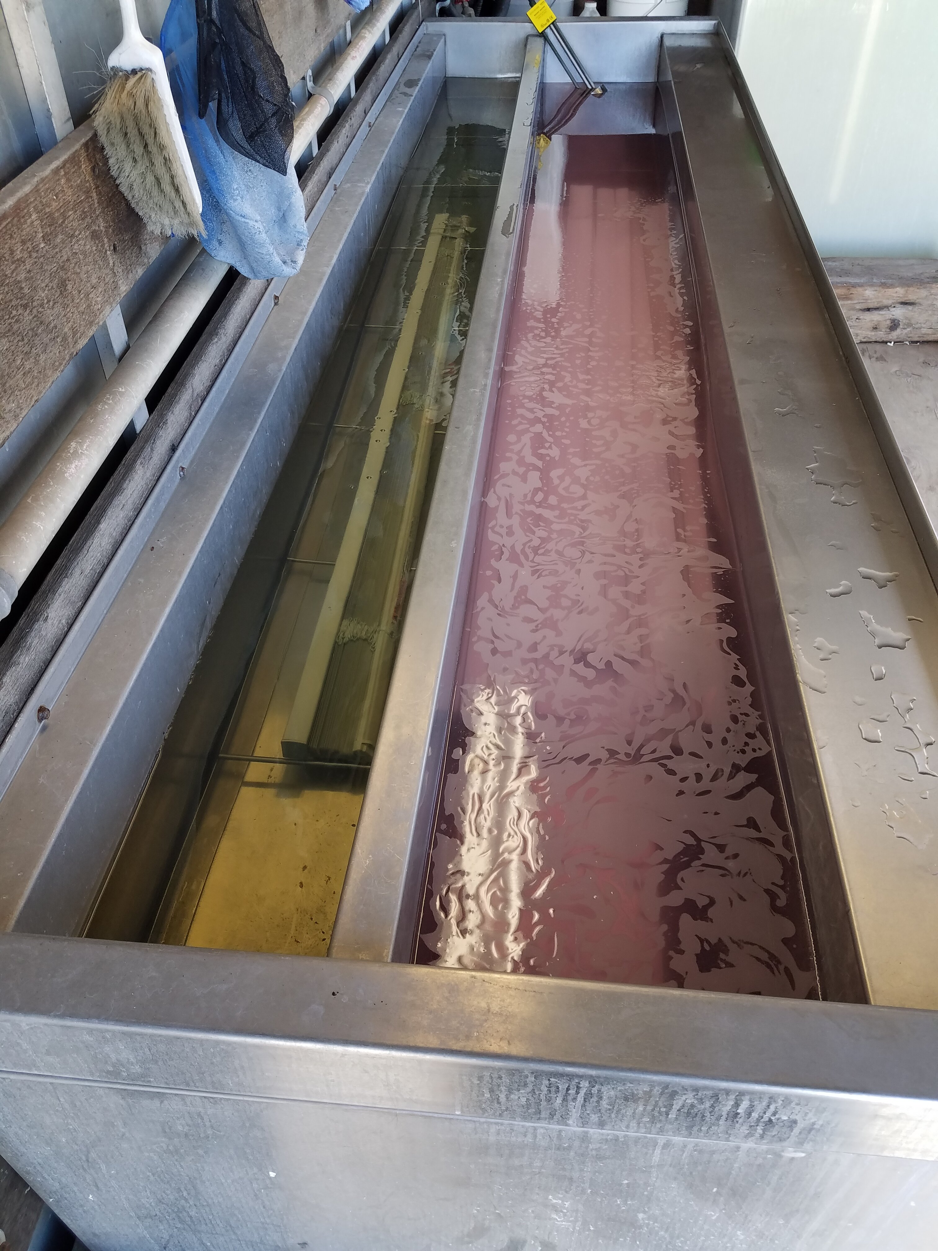

View attachment 134336 View attachment 134337 View attachment 134338 View attachment 134353
This is really interesting. I know nothing about this kind of cleaning so I have no idea whats in those vats. Cool to see though./ thanks

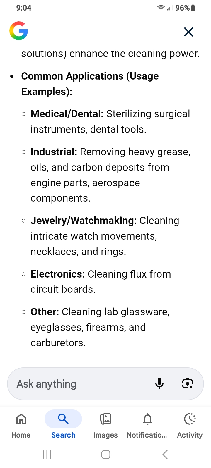

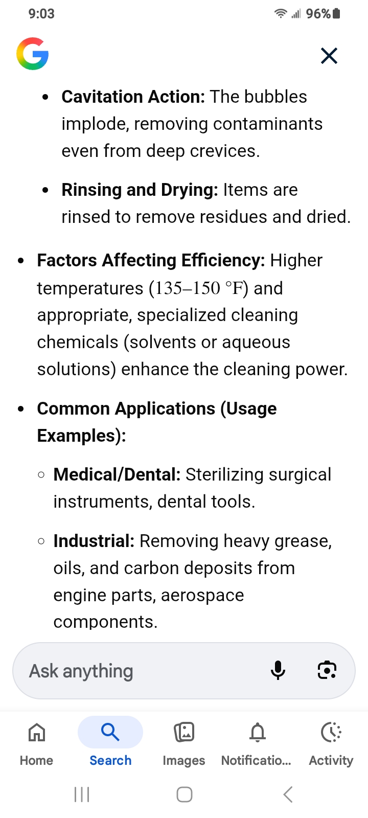

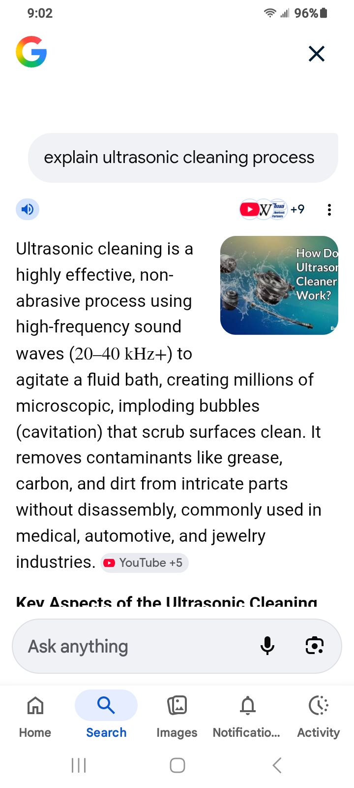

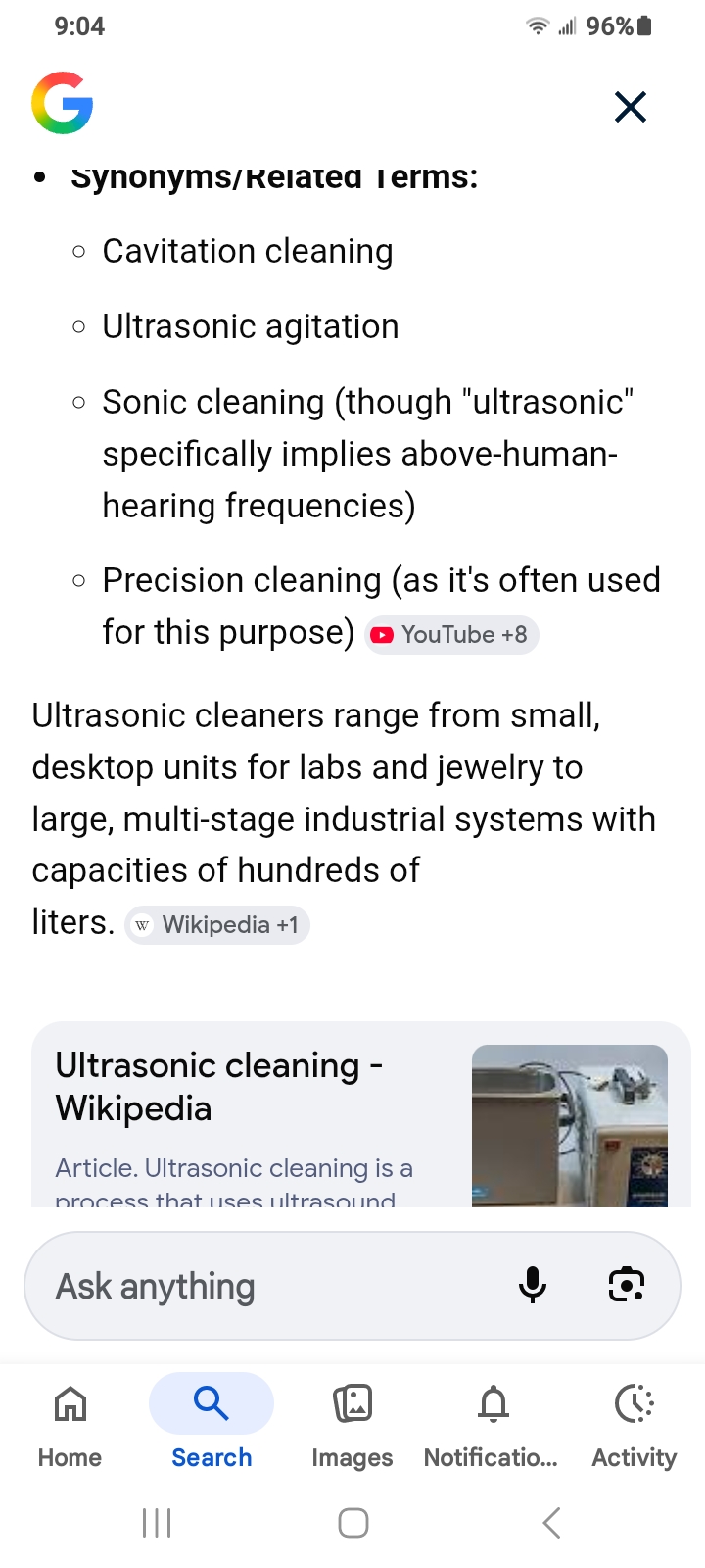

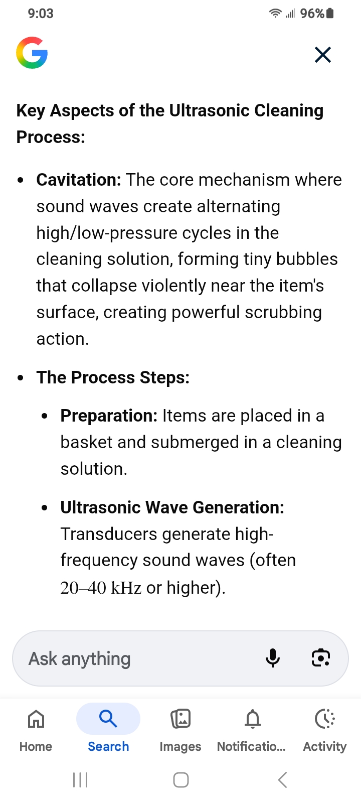

If you know what an ultrasonic jewelry cleaner is, what i have is an 8' 30 gallon ultrasonic jewelry cleaner. The front tank has the ultrasonic generator transducers the pink stuff is a mild detergent. The back tank is a rinse.
Screenshot_20260312_090253_Google.jpg Screenshot_20260312_090320_Google.jpg Screenshot_20260312_090335_Google.jpg Screenshot_20260312_090410_Google.jpg Screenshot_20260312_090420_Google.jpg
Reactions: GJR
