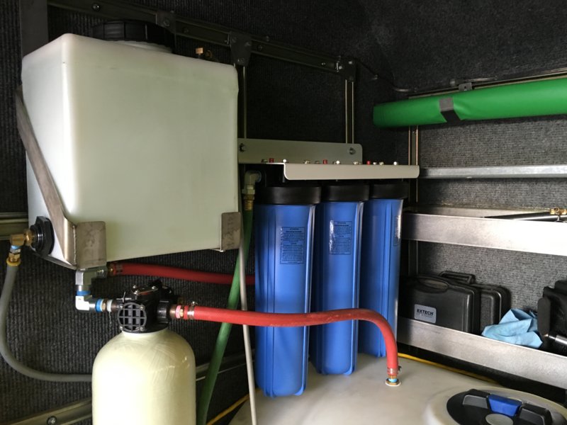

Here is an upgrade I just did. Lance the water expert helped me out. Carbon, chlorine and fine sediment. Then to the water softener.

It doesn't look like there is enough room to unscrew the filter housings. How do you service the filters?
If you moved the assembly up a few inches would you be able to remove each bowl to service the filter?

Correct, I have to loosen the 2 bolts on the brackets and slide up the whole system in order to get the filter housings off. With all the water in the housing, its to heavy and not strong enough to drive around without bending the main bracket.
