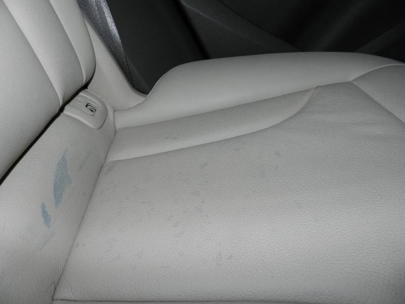

Leather Dye Transfer Stain from a Vegetable Dyed Bag on a 2012 Audi Q5 in Foster City, California 94404.
Anyone keen to take up the job, I will walk you through the removing process “non-destructively”.

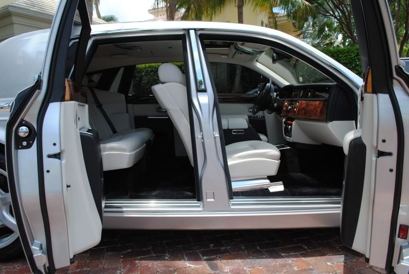

This was another job with problems of brown leather belt dye stain in Florida, USA.
Leather may open you doors to your other services too!
Thanks for your interest!
Roger
Rolls Royce Phantom…

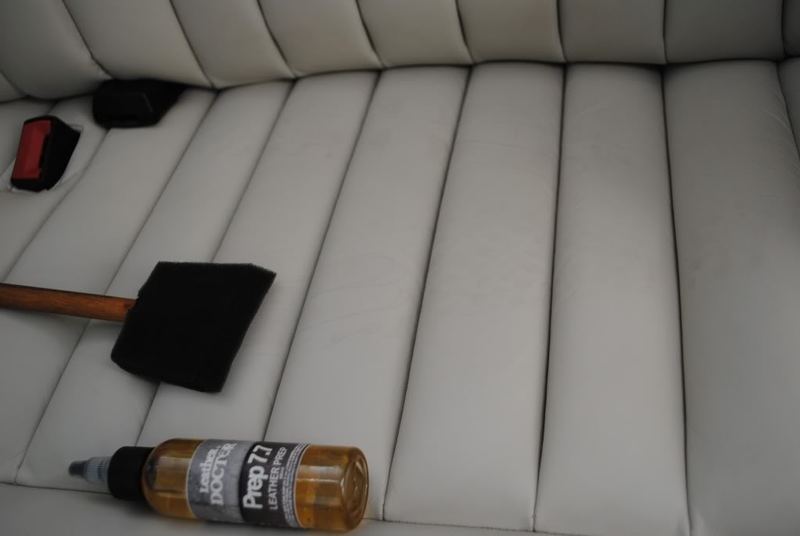

Prep-7.7 is applied with a foam brush…
It’s thick and sticky…

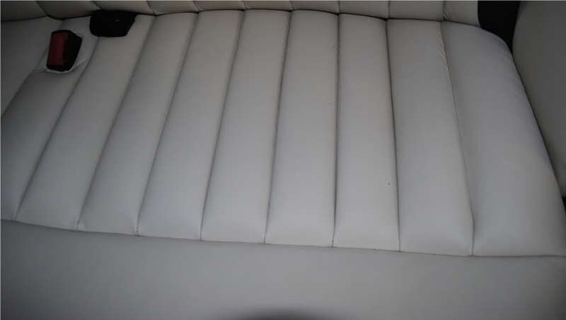

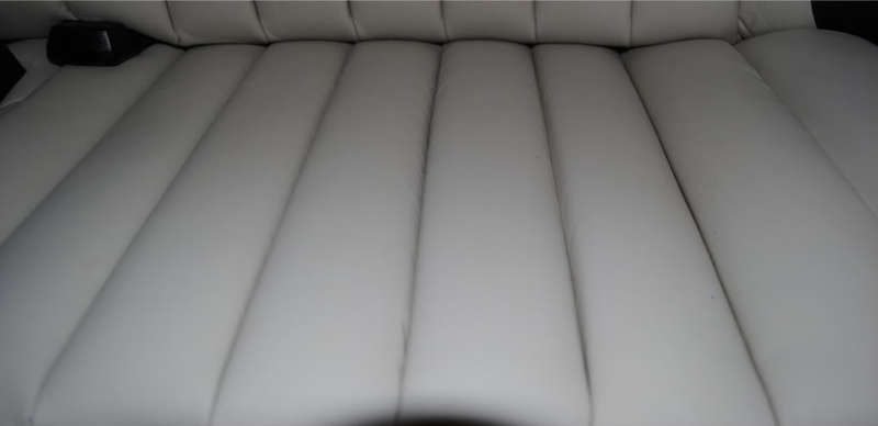

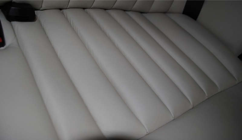

These pictures are after the sticky residue is clean up with a leather-safe pH 3.8 cleaner and a pH 3.0 rinse.
