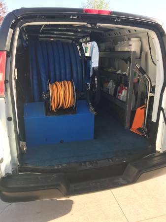

I installed marine carpet in all my vans. Just install underlayment in the areas you want to carpet (screw to floor) then glue carpet. easypeezy

Ya that carpet will hold enough moisture .....
Yor truck may last a year...maybe

I agree Bob!! We have been using the rhino liner for twenty years or so now and had no issues with floors rusting.

floor is rhino lined - last a year? the pics are of a 2007 van
