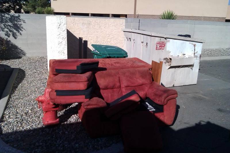

When i quote somebody $150 to clean their couch and $199 for a sectional they just hang up on me.
Here's a nice pic i took of a microfiber sofa and love seat that looked to be in good condition that somebody tossed out next to a dumpster.

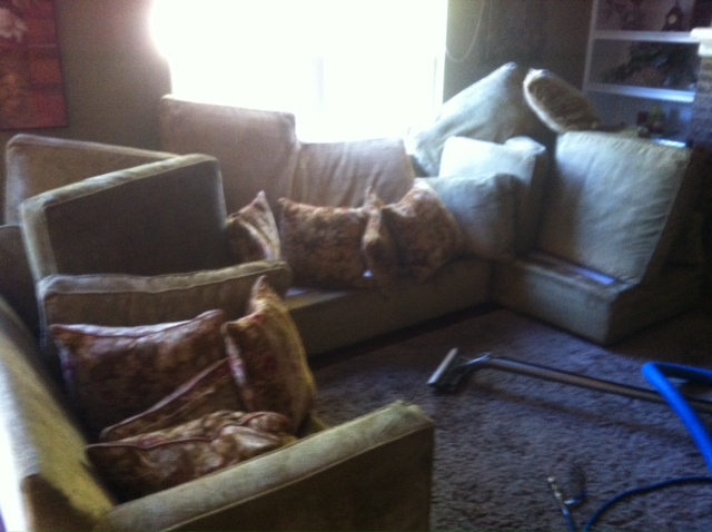

here's a sectional we did today and it was a killer! We could've cleaned a whole house of carpet in the time it took to clean all these cushions and pillows! It also had to be groomed. And No we did not clean it with the Ti ! That was for the overspray

We are at $125 for sectionals and most times that will reach our target $ per hour, however on the above job (with 2 techs) it took almost 2 hrs so I can't say I lost money on that particular job however did not make as much as normal. The only hope is that I can also clean their carpets in the future!
I also used to hate doing upholstery until I raised my prices to the point that if they request it I make sufficient income thus do not dis-like it as much.
You know everyone was thinking, did he use the Ti wand LOL I know I thought it.
