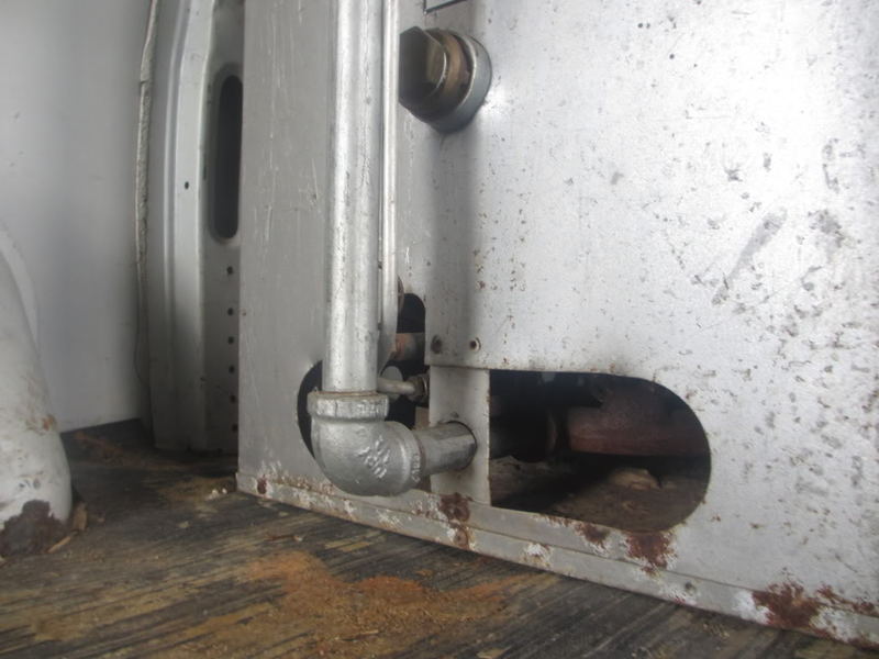

I bought an used TNT that came w/ a little giant heater which I am not sure of it's condition, I'll post pics later.
Where can I take it to get it serviced or looked at to see if it is in workable condition? The closest pressure washer place told me they do not work w/ heaters, just pressure washers (pumps n engines), no blowers and no heaters.

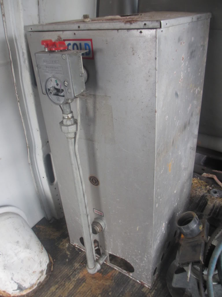

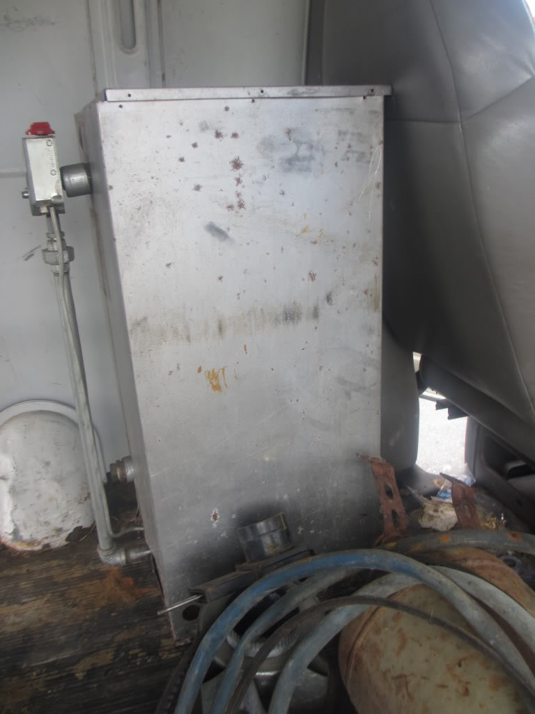

Here are some pics of it:
this is what the heater looks like, let me know if you guys think it can still be used or should I just replace w/ a new one.

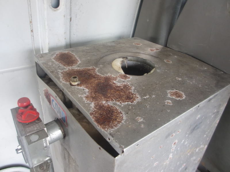

First run a pressure line from your current cleaning unit and see if it will hold water pressure. Start off cold. Looks like it may have been apart because of freezing. If it holds, button it up and go through the service procedures Les has posted.

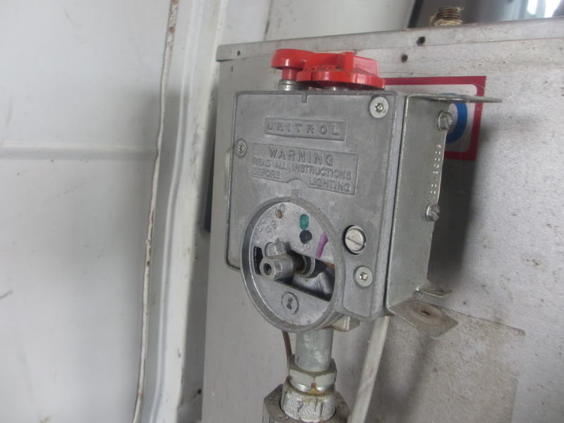

X2... I can't speak on the freezing thing, because I've never had to deal with that... However, the LG heater looks to be in good shape.. The red temp knob is missing to dial the heat... I wouldn't go over 600psi with that unit though... Unless you know its a high pressure model...

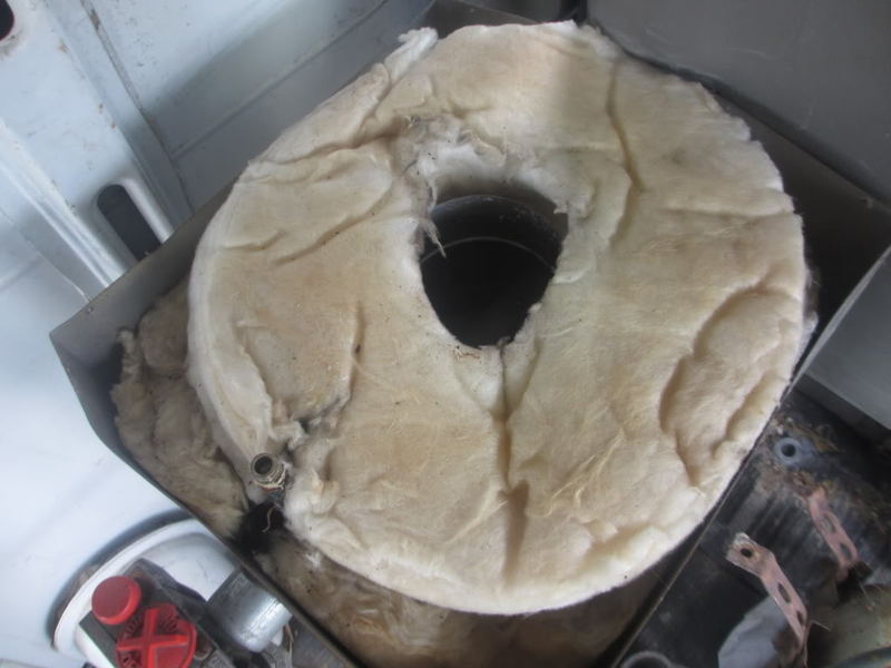

Pull the circular shaped insulation off the top abd inspect the heating coils befor you hook up any pressure, if it did freeze it will normaly blow out at the top near the thermostat control, if it looks good then pressure test!

My experience with busted coils caused by freezing happens at the bottom of the coil, not the top. Living in the north it has happened to me a few times.

Hope you didn't pay much for it. Its a mess. Get a hold of Less. He even has a video on repairs.
