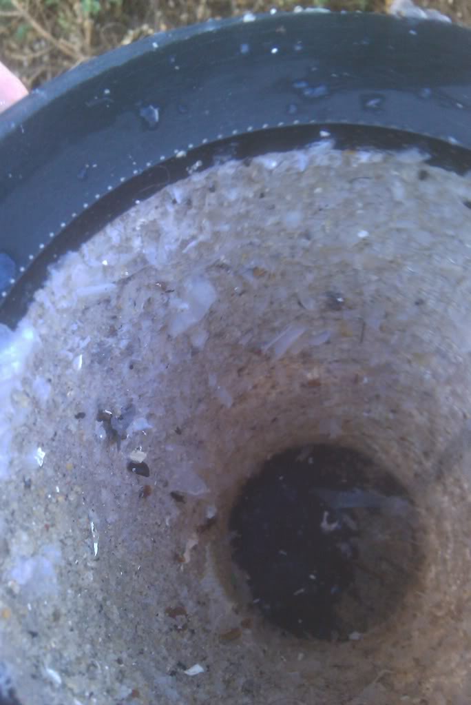

Yes Doug it peels right off if you have enough pressure. 1000 psi just doesn't do the job. You need closer to 2k psi and the wax will come right up. Just be prepared to change your filter a bunch of times. And why would you need to get the wax off except maybe once every 10 years. The floor can be cleaned and re-coated. Good stripper, the right brush, and the right pressure will take it right off. But yes I agree with you that on that particular floor I would advise against finish. I didn't see the pic real good on my phone.

ok a few things (and i think everyone else would agree)
using a 20k pressure washer & wet vac isnt the best thing
2k psi on a grout line is just BEGGING for a problem (yea i know hasnt happened YET)
Thats not a floor finish, or if it is then you DID NOT use the right chem, and relied on the PSI to flake it off....
Correct stripper on a finish produces a GOO, or complete break down back into a liquid
if its a non standard type finish, then it does things like this
or like the flecks of stuff in that filter....
also multiple cleanings of filter??? sounds like a recipe for a burned up blower
and if more then 2 people disagree with me....ill retract my comment and offer an apology
