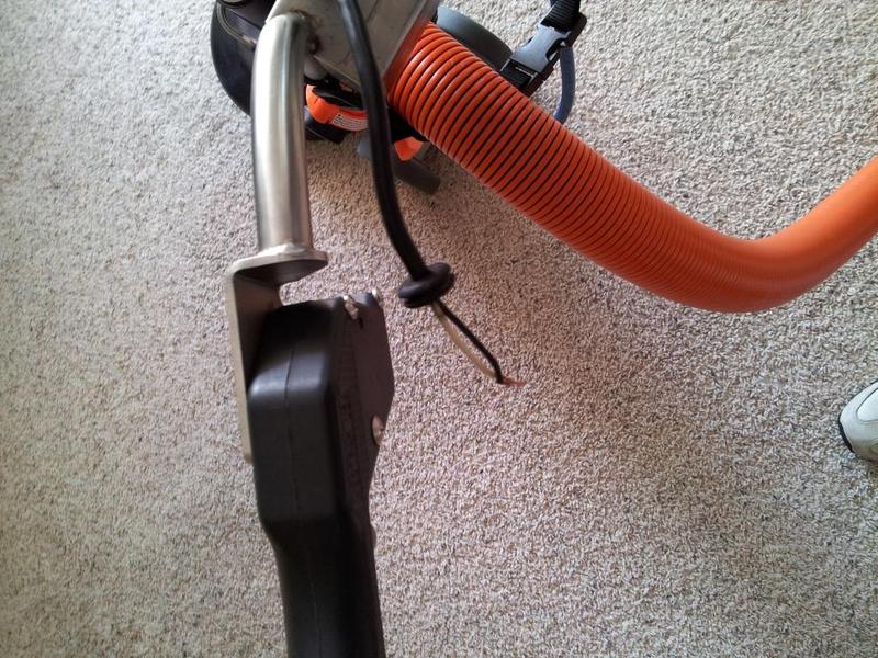

While cleaning a 3 bedroom condo, my RV360i decides to stop working for me... I pulled the trigger and it started for a split second, then stopped... I checked to make sure I had power, I have an extension cord with the little light that lights up for power...
Had power... Then I checked the carbon motor brushes, they still have a lot of life left on them... Then I checked the on/off switch after taking apart the handle... Found a bobbie pin in the unit earlier... I jumped the 2 wires going into the switch and wallah, it started...
So I took off the switch and twisted the wires together... Took all of 10mins to get back running... I wasn't about to come back to the job to finish it up... I thank my pops and friends for teaching me everything I know...

Yea, I'm lazy... The wand wouldn't get it the same as the rv360 got the rest of the place... Only the AW29 wand would have worked with the portable...
