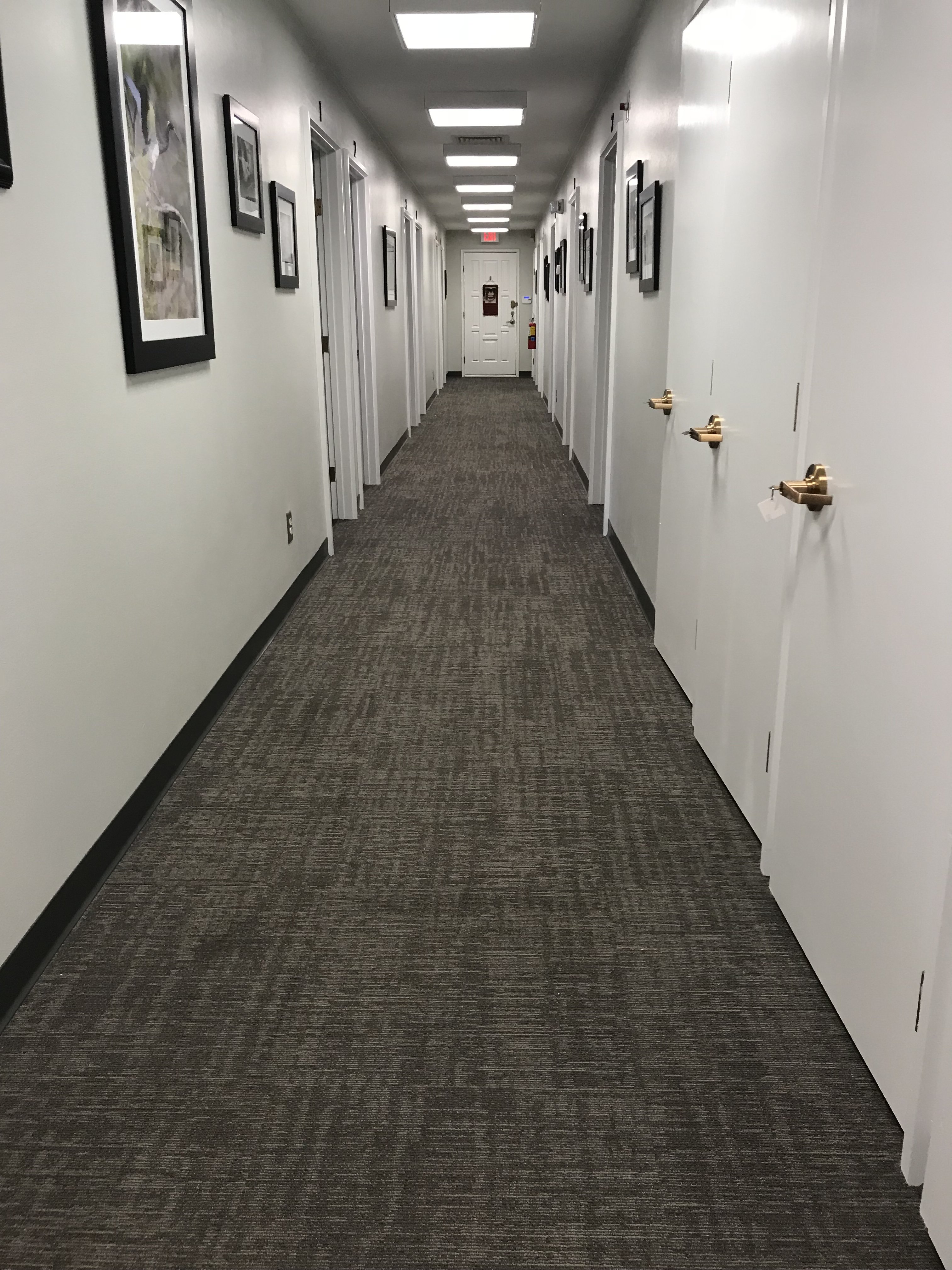

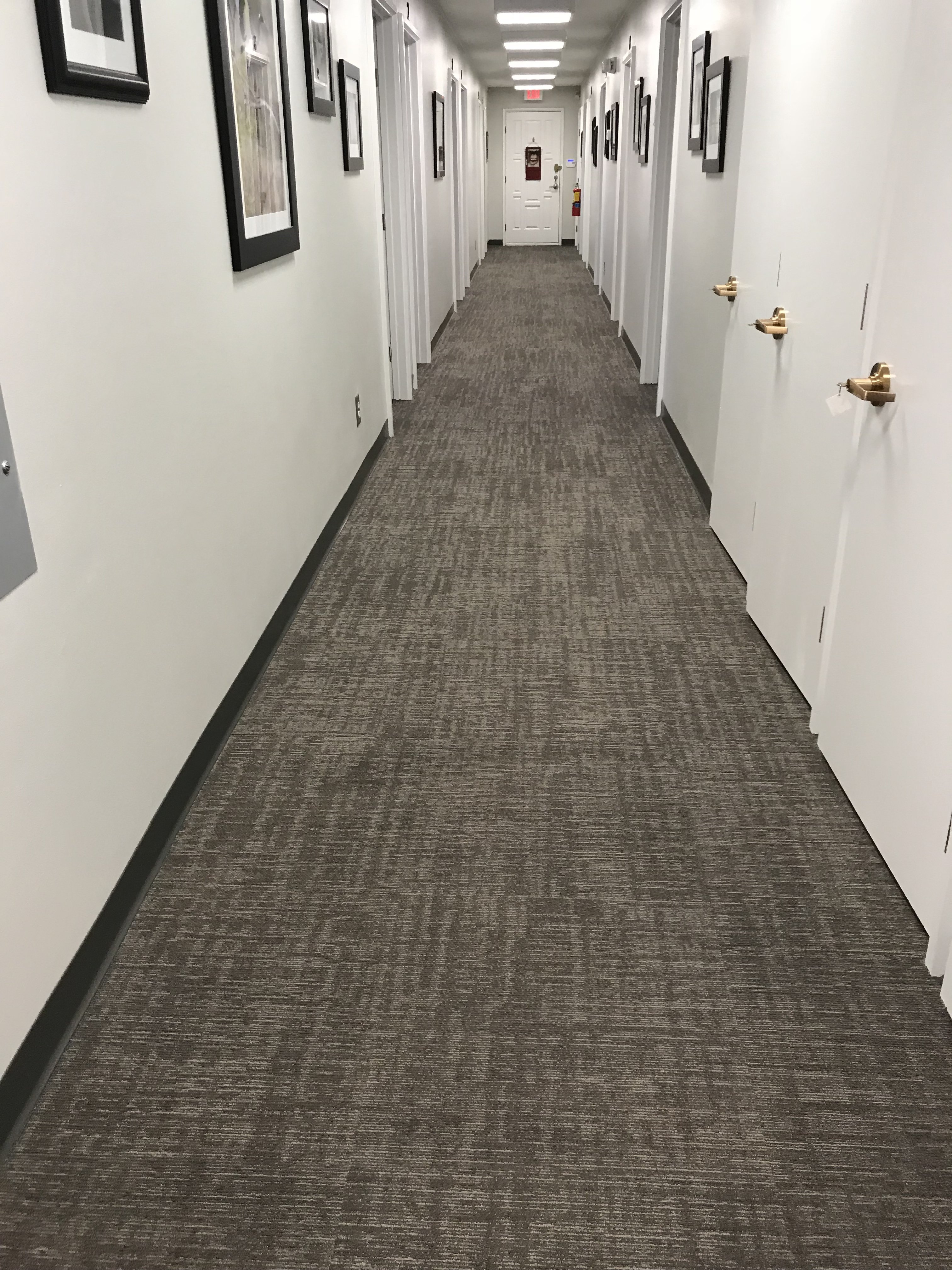

Bought a Vibe.
Cleaned a Drs Office yesterday. First picture is before vacuuming. Vacuumed the ran the jiggler with some Encap-Hydrox and Saigers Cide. Second picture is 30 minutes later and dry. Significantly brighter, coffee spills and trash bag drags gone.

Nice work. Just to let you know. I mix in Saiger's PLyme and S-Cide all the time and have titty-pink results. In fact, one commercial customer is so happy with it he requests everytime that that mix in that "suff that smells so good".
I agree with the guys about mixing stuff, but based on my experience Saiger's smell good juice is safe as leaving your van unlocked with a Rotovac Bonzer in the front seat.

Been mixing it for a while. No probs.
2 gallons water
12 ozs encap
4 ozs deo
2500 sqft
It’s was the first use for the Vibe since retiring the 175 and the mop bucket.
