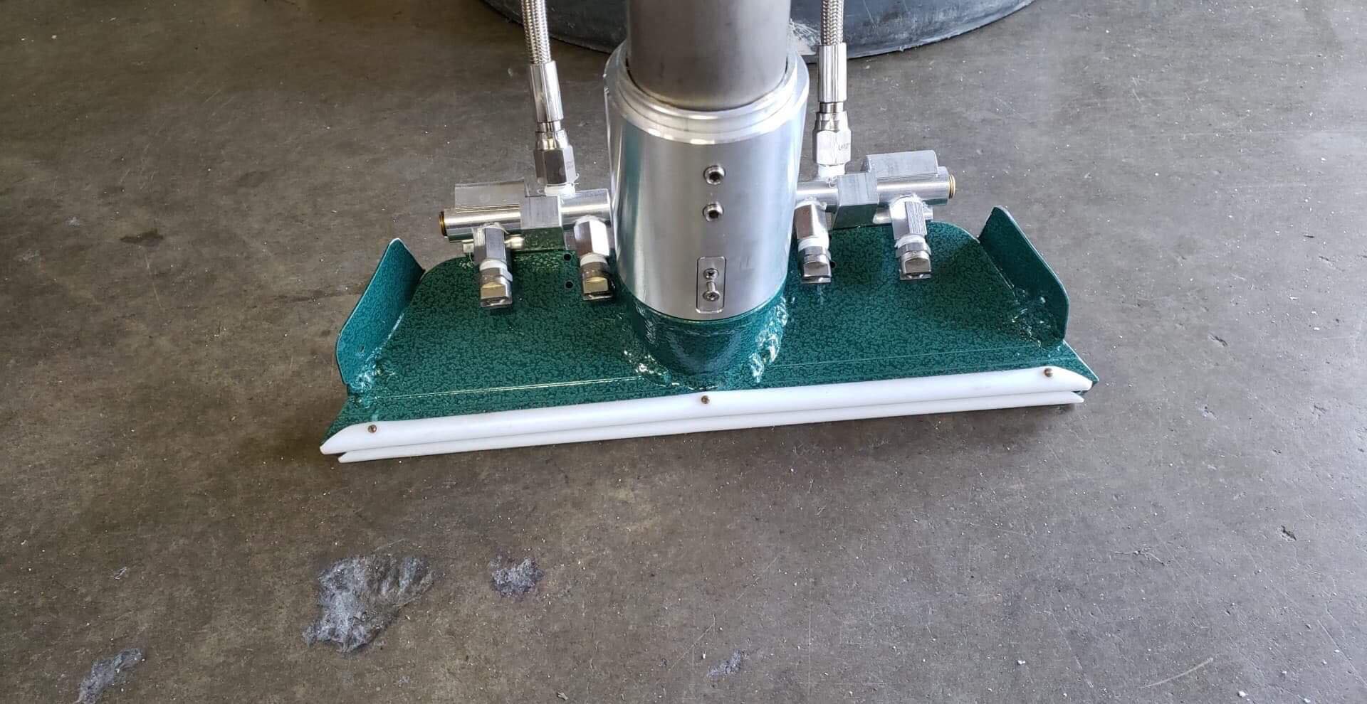

That can’t be. I know the guy is a copycat, but he’s got to have some better class. Even the welds are embarrassing.

:headscratch::eekk: did he even check the spray pattern!? Looks like the 2 middle jets are obstructed by the tube.

this 12-inch head is actually a section of the 24-inch head that I posted a few weeks back if you look closely at the front you'll see seven little divots which indicate that there is a triangle shaped airflow chamber inside that head I believe this one would be an absolute screamer but there's so many other things wrong with it it's virtually unusable

I like it when they scream.
the manifold looks very vulnerable to crew abuse
don't like the glide ends open that much
no clue about the swivel's worth
I think they're all a weak link anyway on a hard working wand

That slide lock will fail prematurely. The whole wand looks like an abortion gone wrong.... then again, I’m no expert.. think I’ll buy a Tom wand instead.....
