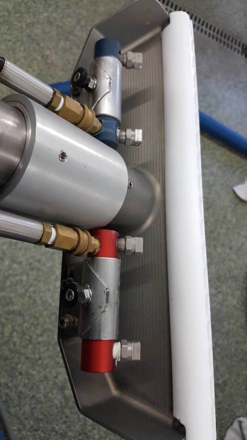

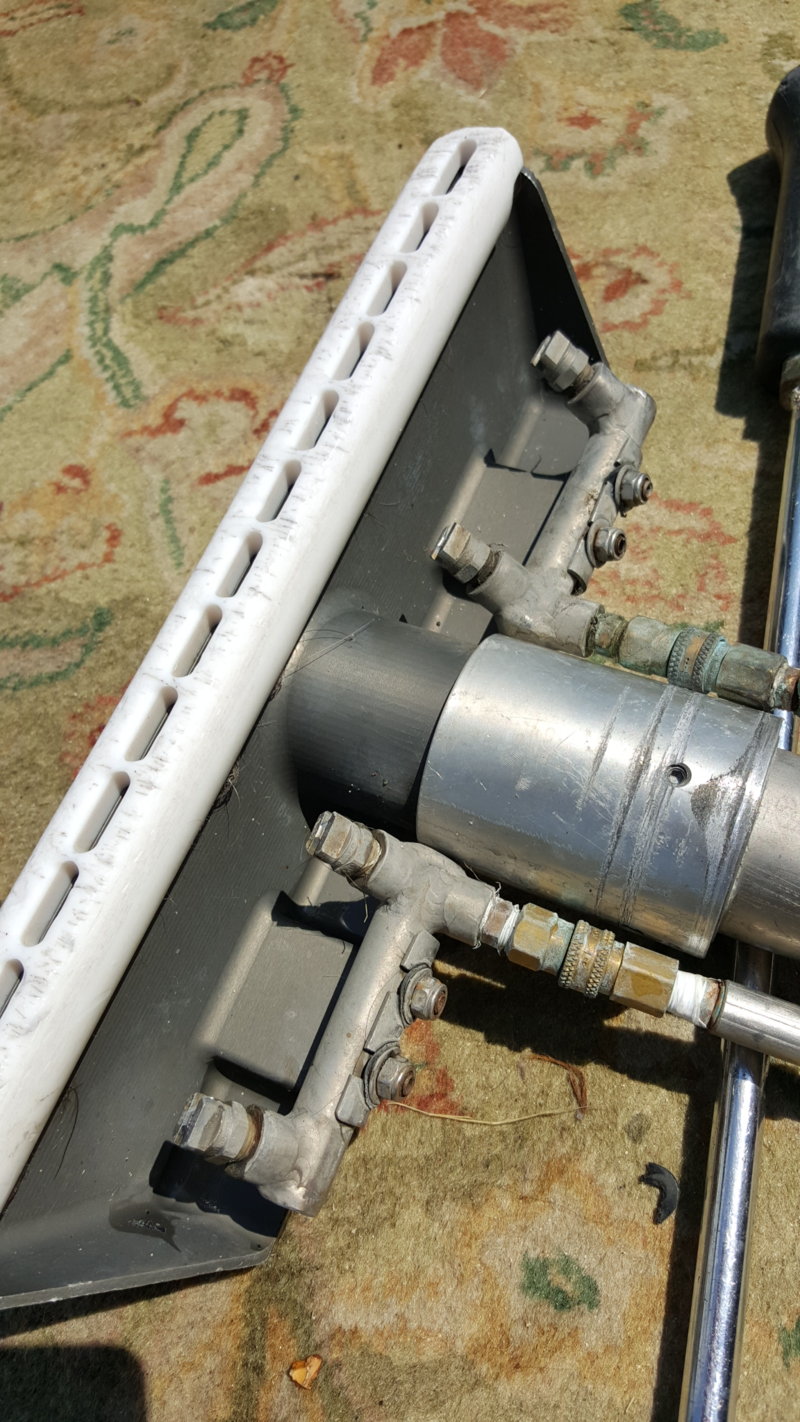

Conway you should be ashamed of your self.
Worse over spray I've ever seen
And nothing you can do about it with those f'n hangers..

whats the jet size? maybe try a narrower angle? all the jets don't need to be the same angle
11,200
The idiot is not talking about the new Dev-Pork. It has no oversprsy when properly adjusted. AND, to my knowledge, it's the only wand currently on the market with the ability to be adjusted in that way.

Is the difference of the jet spray pattern due to the uneven spacing between the jets? Wider gap to cover between the middle two jets? Are the jets able to be adjusted so all four are evenly spaced, allowing for all jets to have the same spray pattern?
11,200
Pattern seems good and the 1102 jets do cover the middle well. 9502 don't overspray the outside but there is so much adjustability front to back and side to side...
I had one start to overspray the other day and it was actually just because I didn't reset a set screw.
Easy fix all the way around.

I don't recall it being so bad on the over spray when you sent it to me 11 months ago.
I tried moving the manifolds around today with no success
As the jets wear the fan starts to narrow out, so with 110's in the middle it gives enough angle to cover the tube gap, and enough to let you slide the manifolds outward to get you right to the edge of the wand as they wear, The manifold brackets DO flex a little when in full swivel, the only way I know to get rid of that is go with steel braid hose as it is a little more flexable, but the hose will start to rust due to it being steel braided

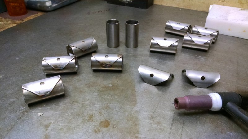

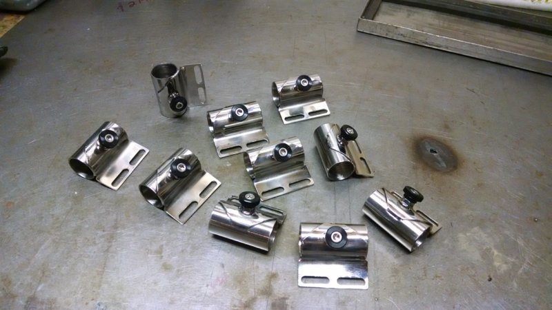

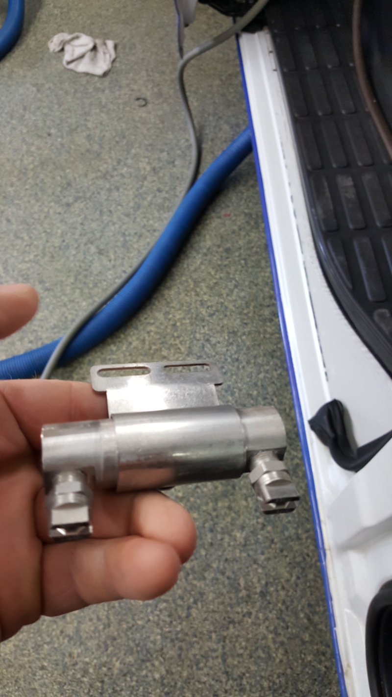

Working on manifolds now, building up inventory. Trying to get ahead

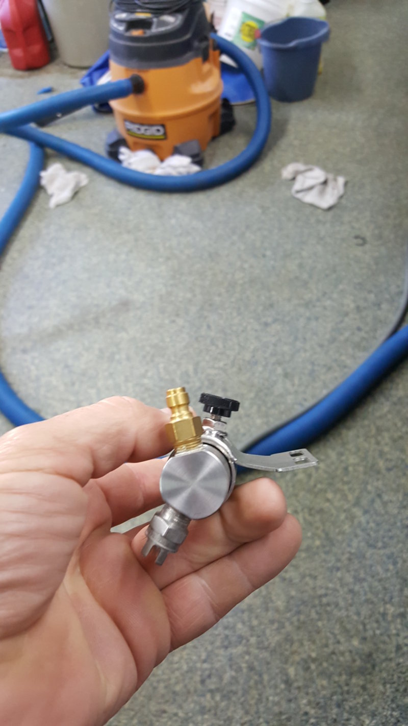

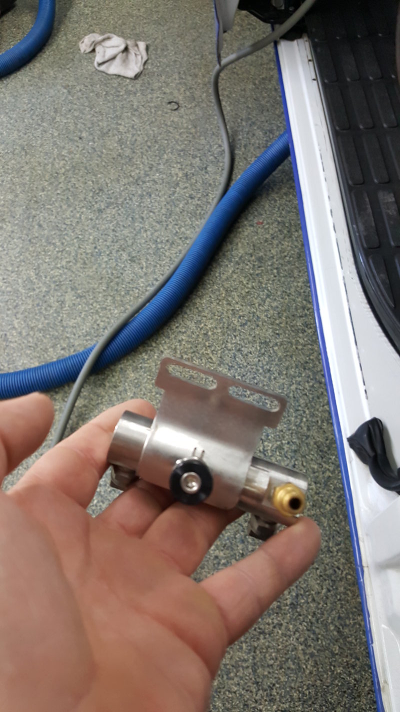

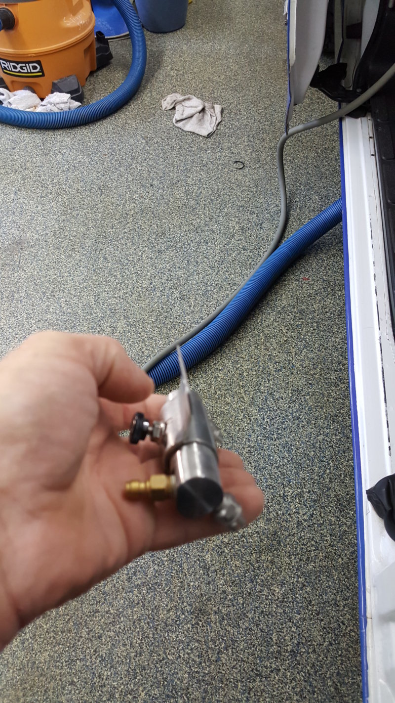

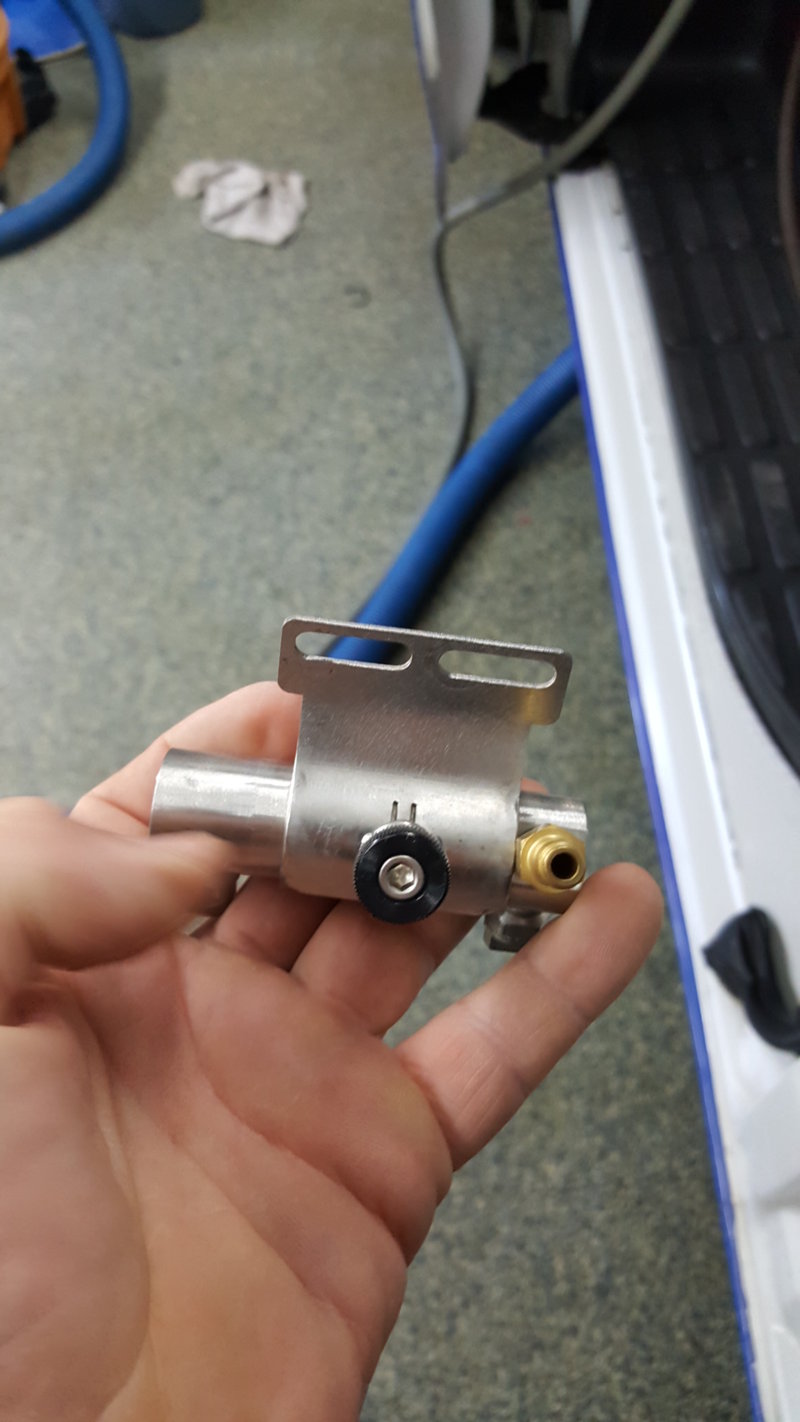

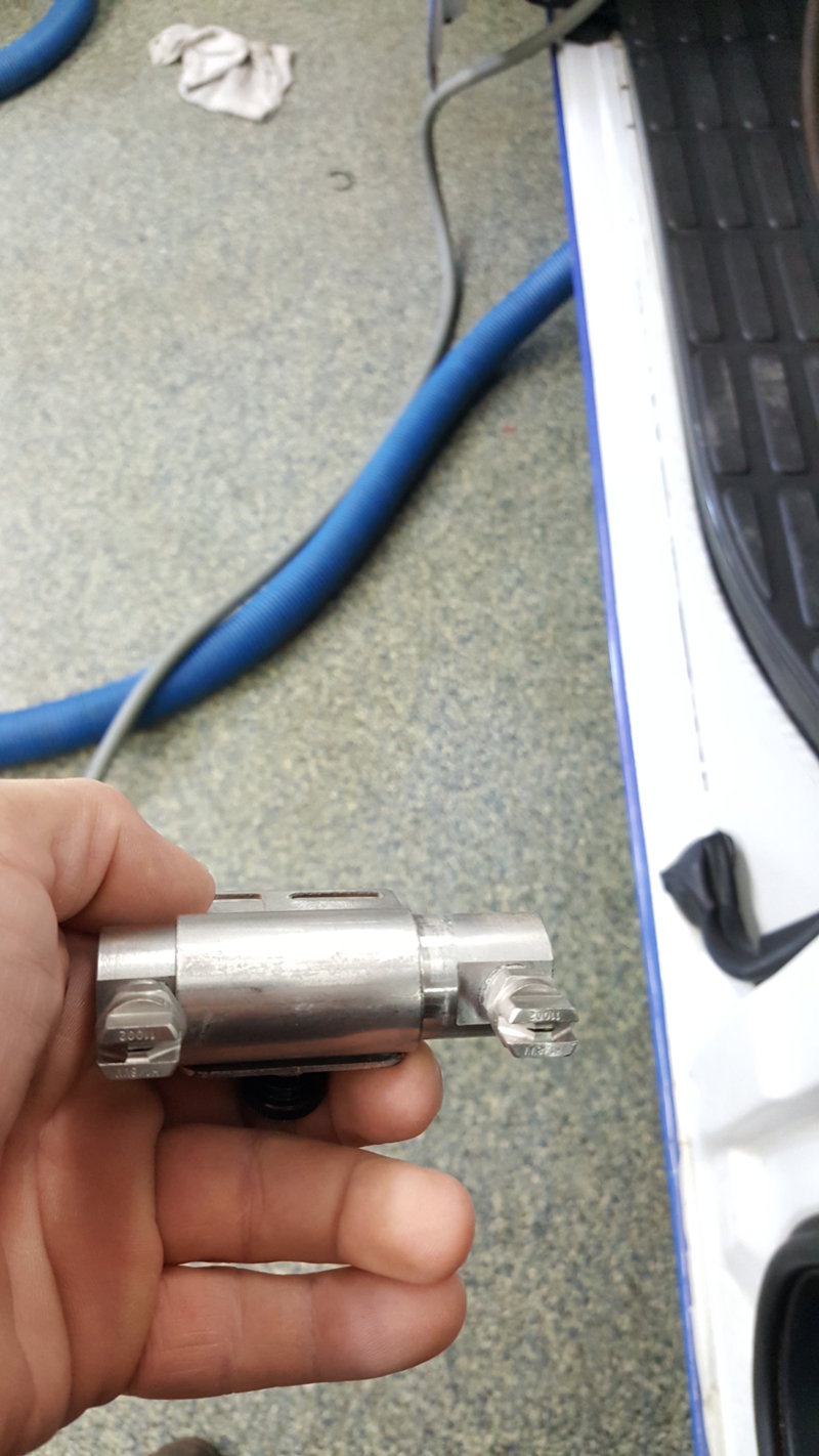

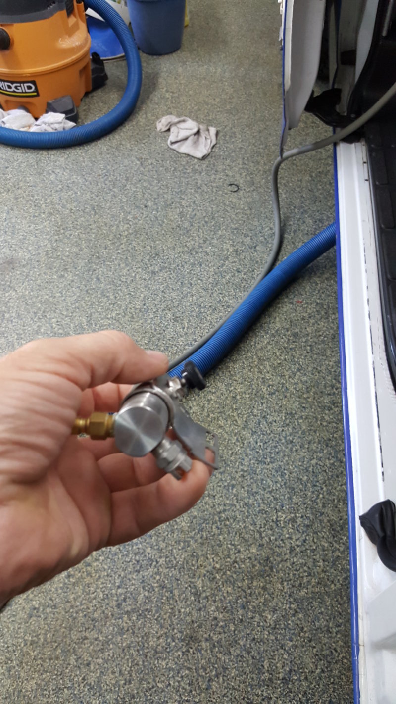

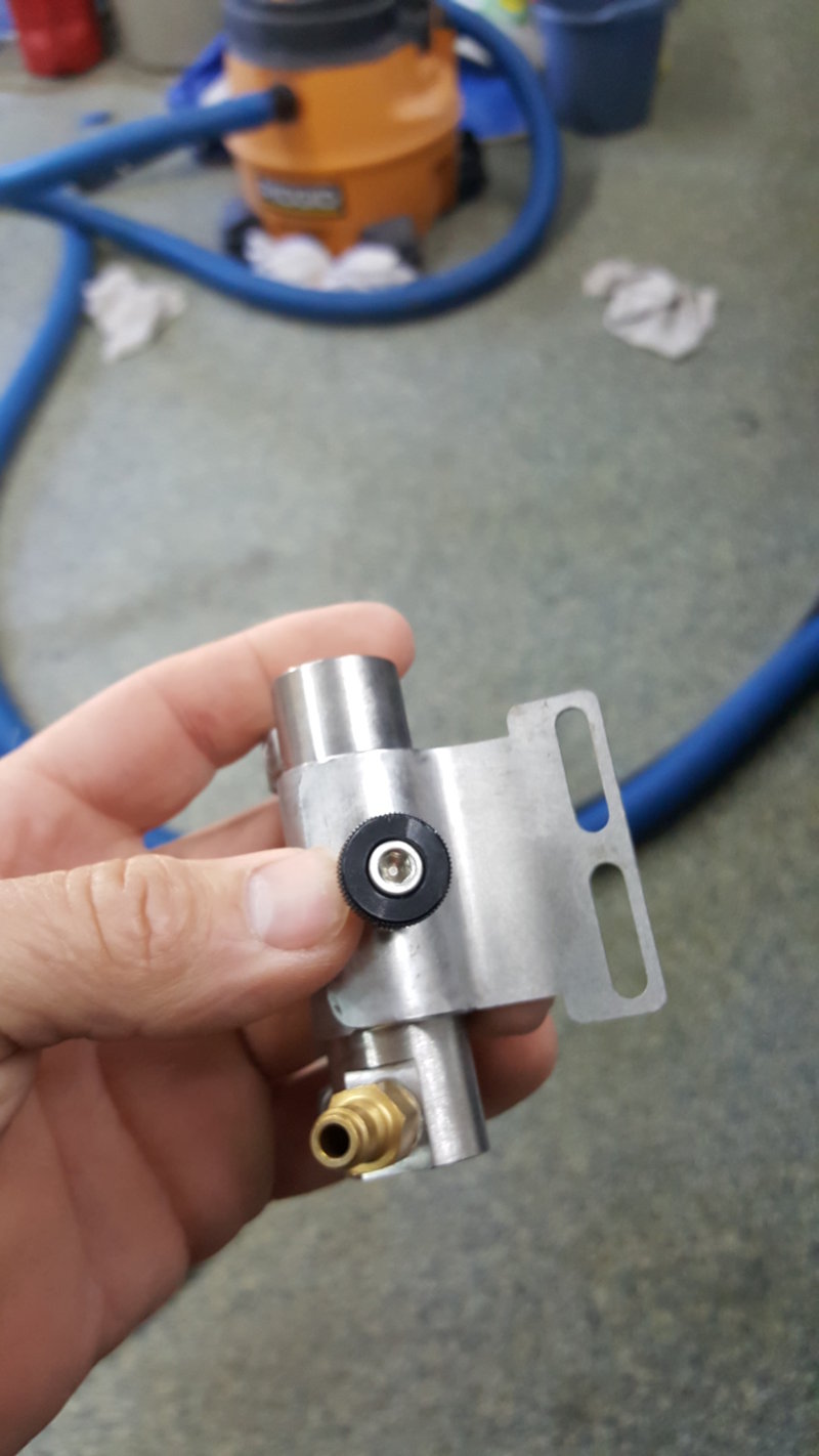

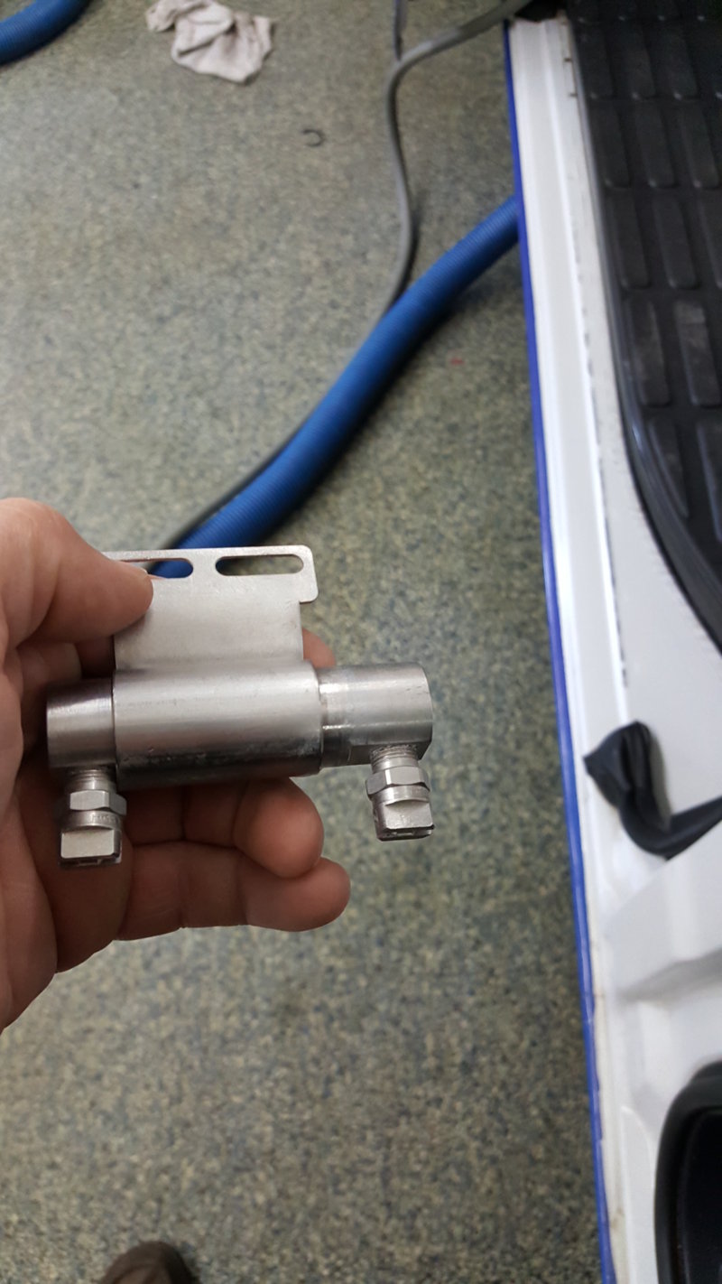

It looks as if the feed lines are over torquing the Manifild brackets. Lots of ways that could happen, including flinging it around the van. You could capture the feed lines somehow to immobilize them after adjusting the brackets.

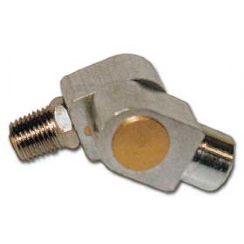

I would have put a swivel connection where the lines join up to the manifold, to prevent stressing the brackets. Something like the one pictured would permit the feedlines to move without moving the manifold.
