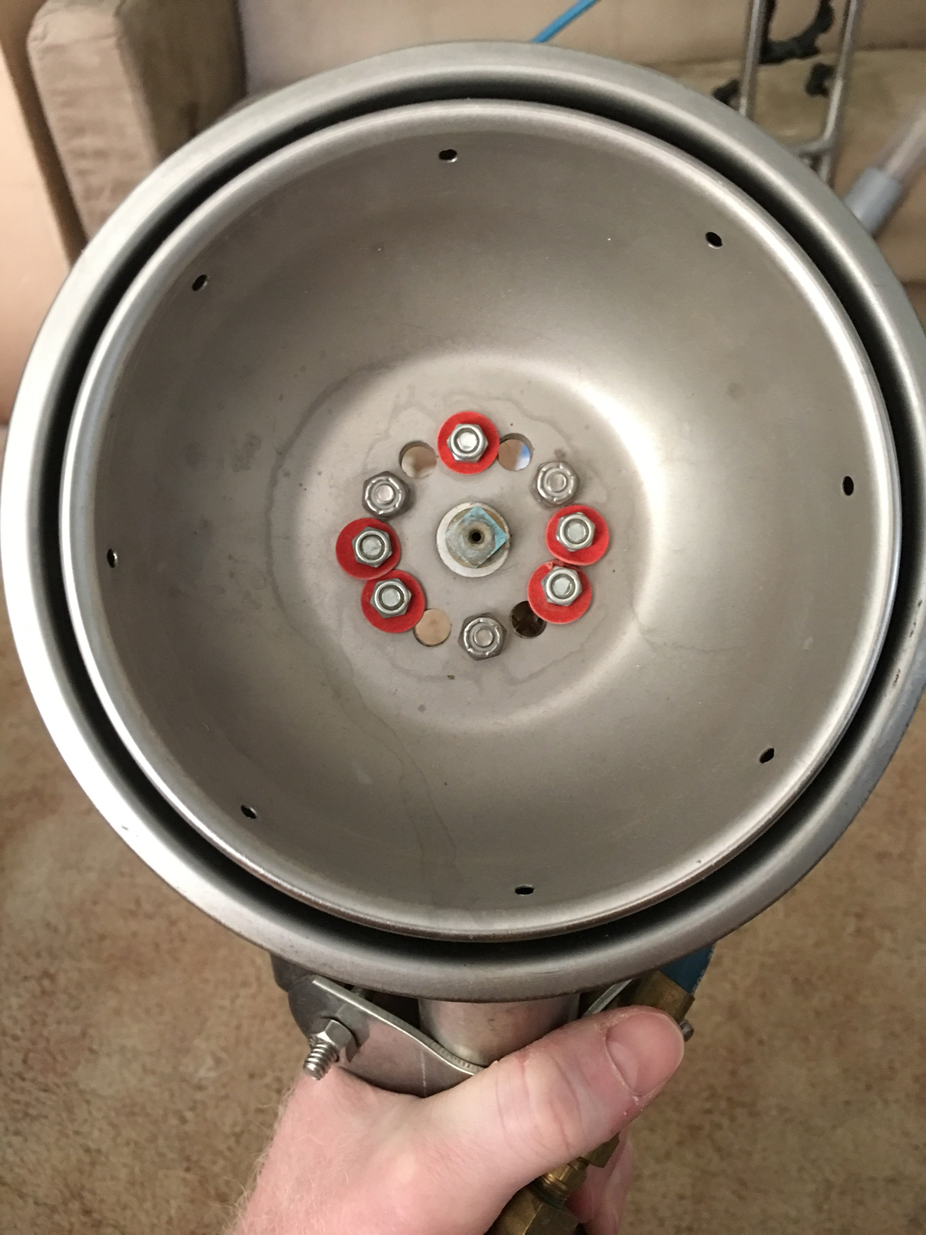

I generally use the Steam Chamber because it’s so much faster and gets so hot.
Is this the small rotary style tool in your video? Would you mind posting pictures of a manufacturer’s link?

IF you do loads of bedding, partitions and flat upholstered surfaces this tool ROCKS.
It is NO GOOD as a GENERAL PURPOSE tool.
But IF you clean beds etc, get one.
