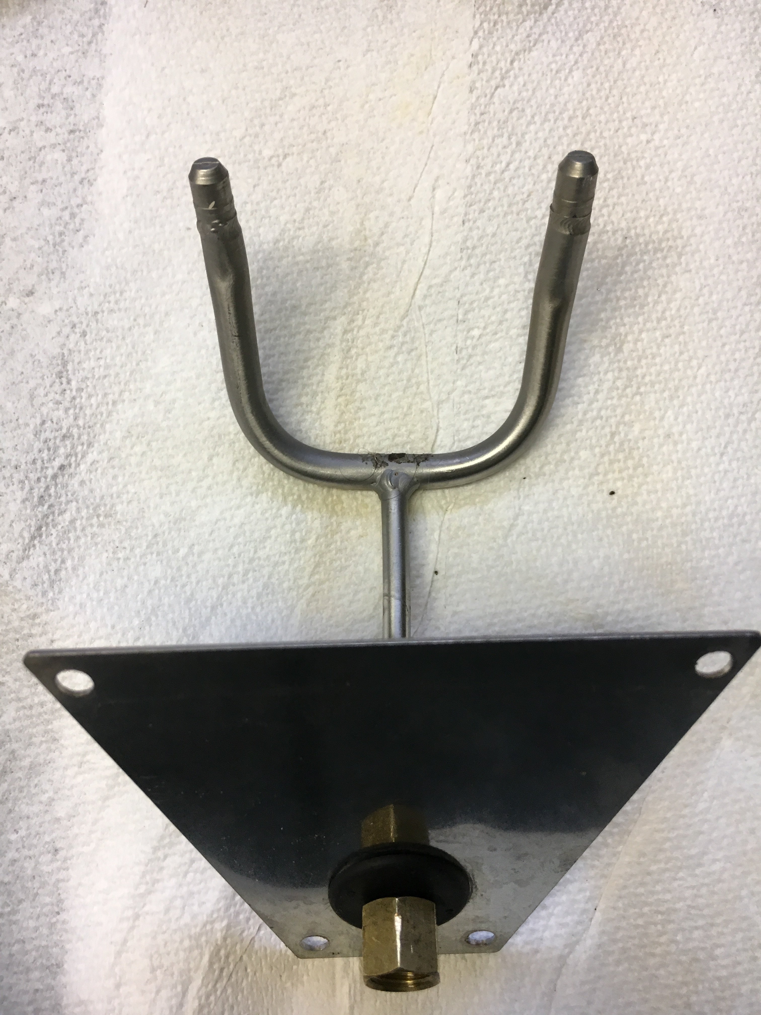

I've got inline filters on all my other tools just never noticed this didn't have one. Not sure why manufacturer would sell a tool without one. This what the manifold and jets look like on this tool.
