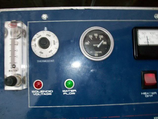

Not only did it maintained 280 degrees, it also dried carpet within a few minutes not hours.
All attendents viewing truckmounts saw it, at the end it was the most viewed TM.
Units like this have runned 12-14 hours straight without any problems, and with good maintenance can last 15 years plus.

Ok lets set some things straight. The Geni59 kicks ass. PERIOD. Second it should NEVER EVER get to 310 degrees! It will hold 220 with 2 RX-20's at 400' each. Don't believe me come to Utah and we'll take a field trip to BYU and watch them run their two machines with each running 2 RX's at 400' almost every day.
Larry at 2900 RPM's it uses about the same as the Everest 650 1-1.25 gph and yes the divertor has been changed for a very long time and the APO Issues have been fixed as well has the belt issues. I have no issues reccommending one. I would sell more of them if they would floor one but as it is Prochem puts machines on my Floor and Powerclean can't and it takes 3-6 weeks to get one. Only reason the 650 is out selling them.
Any more questions I can answer?

that 59 did look the biz and the steam out of the wand was good ,310 at the truck i saw it myself. but the burns on my hands i dont need or on my legs from the hose, i dont think i could fix the machine if it broke down , i would not know where to start.
i,ll stick with my 210 judson that i can fix .it,s simple ,neat and gets the job done if i want more heat i,ll add a propane heater

I'm sure the Genny 59 has changed since my 03 Genny. Mine will in NO way go to 310, or 300, or 280. It shuts down at 270, and that's when it goes into overheat mode....ocationally. My APO works 95% of the time. It was leaking from the main pump seal today. I just don't want to tear it down and not be able to repair it....the machine is usless with out an APO. The vac system has an ability to draw water into the filters and vac blower well below the filter line.....if the float in the tank decides to take a break for the day. The ancient Ford engine still burns over 2 GPH, even with the 2.5 system. I've managed to keep my diverter valve working pretty well. The solinoid has been changed, on the new machines, from an electrical operated valve to a vac assisted valve. I have to change the flap at least once a year. Belt wear never a problem.
It's 5 years old now, an I'm sure it will start nickel/diming me to death this year. Would I buy another?? I'd have to check out the new ones.
BUT.....I still use it daily, and it always starts.

Greenie, the Geni was at 15" on the gauge and it only had 172 hours on the meter. The temp. was 280 degrees ATM. The waste tank has two hookups and was running one 2.5 inch hose with a 20 leader of 2". The hallway was cleaned with both hookups using 2.5 inch each into a Y with 2.5 inch hose going into the 2inch leader.
