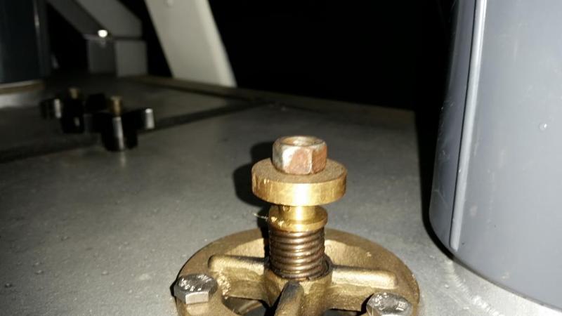

What is your lift set at and would making sure that is working properly generate more heat say from your Blower?
I know with our Butlers (even couple older ones without high heat) making sure they lift is hitting its 15 hg allowed mark helps.
We took out the cotter pin from the pop off and just put another nut on it to create a lock nut.
Just have to check the lift and make sure not over as well as reaching an optimum safe for your system level.
Picture of the locking nut on our pop off
Reactions: dgardner

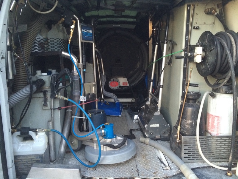

Here's a pic of the back of my van. On the right side I'll move my fresh water reel and those pump ups and can gain a little space for an auxiliary heater.

Kerosene heat will not soot your van but using deisel will...big differnce I have used both...
However you still need to vent the kero heater.....
Propane might work but you gotta get the bigger one and deal with the tanks....
Question is why do you have 4 floor tools ....hoss cx15 and host...when all you need to use is that zipper in the back...lean outyourfloortools and put your heater in would be my suggestion...
I put a kero heater in a mini astro van so it's possible
